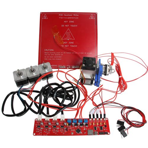

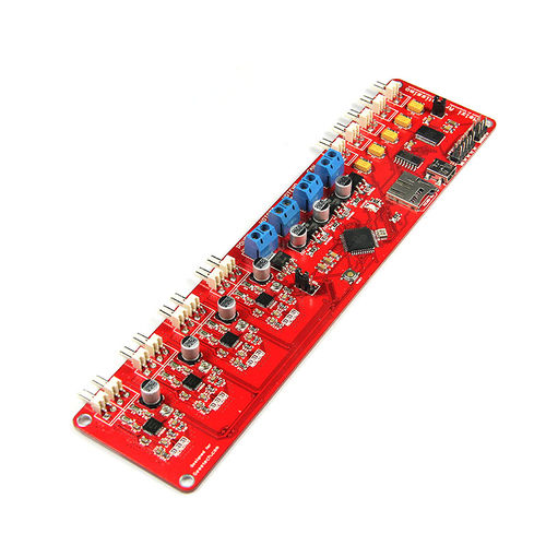

Melzi V2.0 is a compact all-in-one control board which supports only one extruder. Its plug-and-play capability contributes to less time consuming for development and installation. Melzi V2.0 is a quiet mature product with good stability. Melzi 2.0 is based on Arduino Leonardo, so it is more accurate in temperature detection. MelziV2.0 has the following amelioration compared with V1.0: the MOSFET of heatbed and extruder have better capacity of heat dissipation; SD slot adopts outer lead bonding, improving the stability of reading and writing, protecting sd car from damage. When connected to PC, the LED will give prompts for users to know the connection.
Features: 1. Operating voltage: 12v
2. Main control IC: ATMEGA1284P from ATMEL
3. FT232RL USB interface
4.4 integrated A4988 stepper motor driver
5.MK1、MK2a、MK2b、MK3 controllable hotbed MK1、MK2a、MK2b、MK3
6. Mini SD card slot that integrates G code files.
7. The integration of 3 MOSFET driver amphenol connectors for hotbed, fan and extruder.

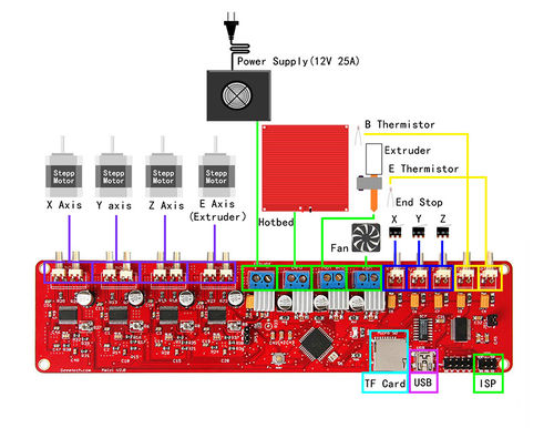

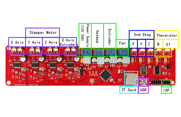

Interface Layout
Interface specifications
1 ADC interfaces for thermometry: one for extruder and another for hotbed.
2 PWM to control extruder, hotbed and fan.
3 end stops for x/y/z axis (mechanical).

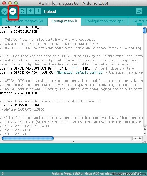

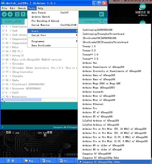

Windows users need install driver before uploading. The board: Tools > Board > sanguino W/ATMEGA1284P 16, as shown below.

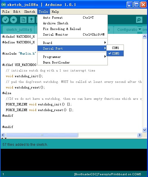

Configuring serial interface: Tools > Serial Port > the corresponding COM Port of MElzi V2.0 is usually the last one. As shown below

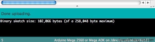

Click the check“ ” button to check if it is right and then click the “ ” button to upload firmware, as shown below.
Upon uploading, IDE will display the rate of progress; when done uploading appears, the uploading process succeeded.
After uploading, you can go on to the next step. If you cannot upload, check the dialog box below to identify the problem and solve it. The common mistakes are the wrong select of type of board or serial port etc.

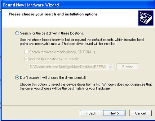

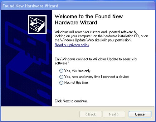

Windows will prompt that a new USB device, named FT232R USB UART was found when connecting PS to the PC with USB. Then, windows will open the dialog box “found new hardware wizard”, check “no, not this time”, then click “next” to continue.

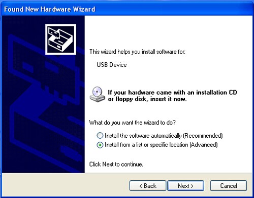

Check “install from a list or specific location (advanced)”, then click “next”.
Specify “drivers” in Arduino 1.0.1 installation directory to install driver.

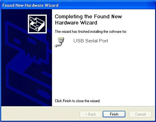

If everything goes well, windows will install the corresponding driver.
The graph below shows installation completed.

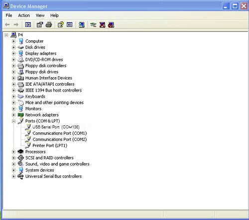

Now, you can find the corresponding Printrboard device in device manager of windows.

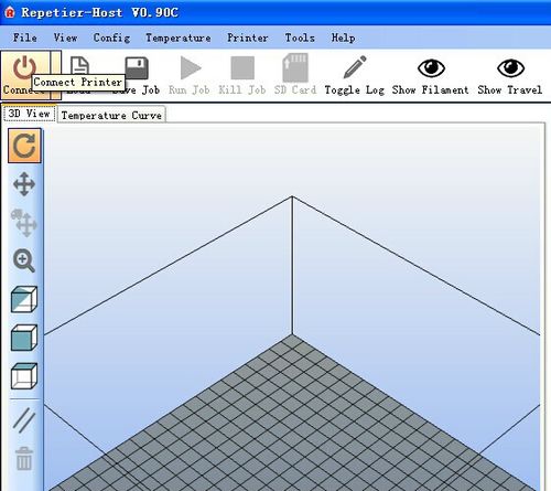

The connection of Repetier-Host

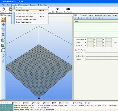

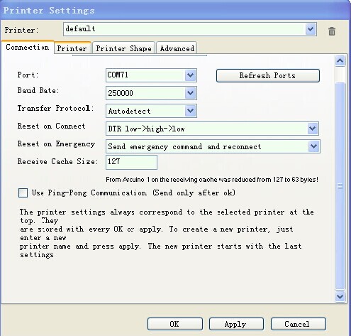

Click configuration > printer setting
Set the communication port (the COM port for Melzi V2.0) and the Baud rate. Then click ok
Click “connect”> upload. Choose the GCODE file you want to print.

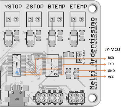

Upload firmware with Bluetooth through USB《-》rs232(TX/RX)
The COM should be set as (9600, N, 8, 1)
The command for Bluetooth module:
 AT OK
 AT+BAUD8 OK115200BAUD (set baud rate for Melzi)
 AT+NAMEHUXLEY OKsetname (optional set name, default: linvor)
 AT+PIN0000 OKsetPIN (optional set pin, default: 1234)
