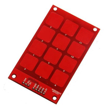

MPR121 TouchPad
Introduction
The MPR121 capacitive keypad uses the MPR121 and 12 touch sensitive pads to give you a simple 'keypad' with an I2C output. The board also has four mounting holes allowing it to be used as an input system in place of traditional buttons. The 5V - 3.3V level convertor intergrated on this keypad provide you the options for 3.3V and 5V I2C interface for your microcontroller.
Features
  • Low power operation
  • 3.3 V supply operation
  • 12 capacitance sensing inputs
  • Complete touch detection
  • Auto-configuration for each sensing input
  • Auto-calibration for each sensing input
  • Touch/release threshold and debounce for touch detection
  • 3.3V and 5V I2C interface, with Interrupt output

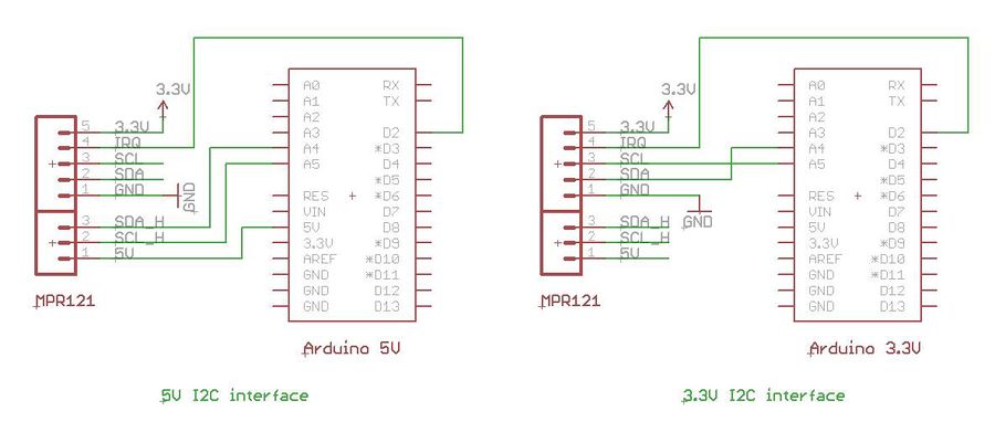

Usage
Here is guide illustrate you how to connect MPR121 Touchpad to Arduino.
