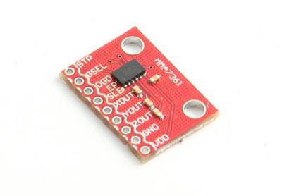

This is a breakout for freescale mma7361l analog three axis accelerometer.The MMA7361L is a low power, low profile capacitive micromachined accelerometer featuring signal conditioning, a 1-pole low pass filter,temperature compensation, self test, 0g-Detect which detects linear freefall,and g-Select which allows for the selection between 2 sensitivities. Zero-g offset and sensitivity are factory set and require no external devices. The MMA7361L includes a Sleep Mode that makes it ideal for handheld battery powered electronics.

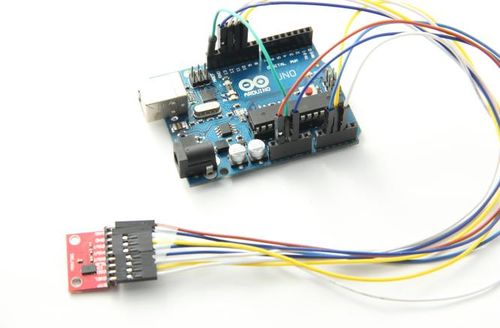

Here is the guide illustrates how to connect an Arduino to the MMA7361 Triple Axis Accelerometer Breakout. The following is a table describing which pins on the Arduino should be connected to the pins on the accelerometer:

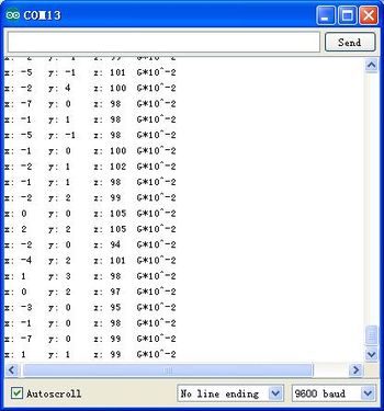

First put on the MMA7361 module on the flat and upload the Arduino example code. Then open the serial monitor, after the calibrating, MMA 7361 will output the gravity on x, y and z axis. The photo below shows the output data when the accelerometor is lying flat, the gravity of Z axis is about 100(1 G).Please note keep this module flat when calibrating.
