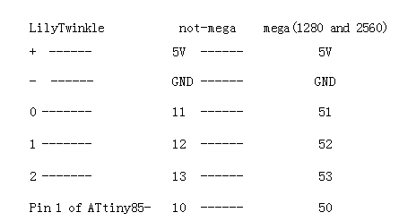

3.Connect Arduino control board and LilyTwinkle like as :
The pin1 of ATtiny85 hasn't expansion port , so you must connect the pin directly.
