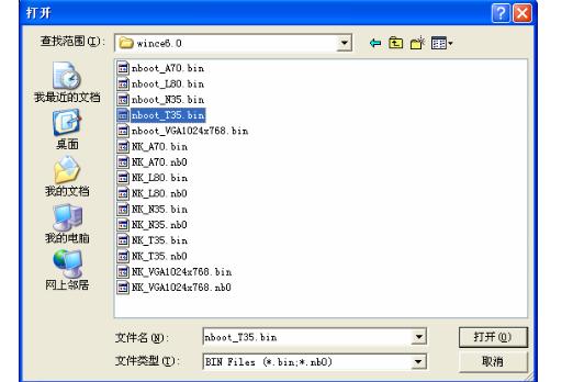

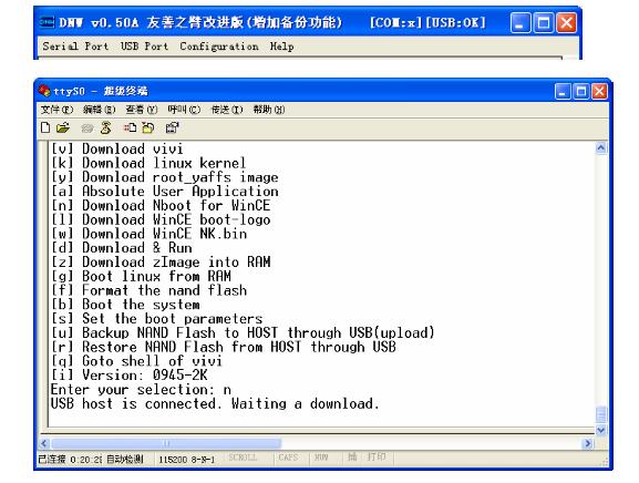

1)Open the DNW and connect the USB cable. [USB :OK] in title bar indicate the USB cable is connect successfully. Then download the Nboot.bin according to the menu selection [n].
2)Select “USB Port->Transmit” and open the file Nboot.bin located in “\images\wince6.0” to download.
Bootloader descriprtion:
nboot_W35.bin – apply to 3.5” LCD landscape mode(LQ035Q1DG06 or compatible)
nboot_X35.bin –  apply to Sony 3.5" LCD
nboot_N35.bin –  apply to NEC 3.5" LCD
nboot_T35.bin –  apply to 3.5” LCD
nboot_L80.bin –  apply to Sharp 8”LCD( or compatible)
nboot_A70.bin –  apply to 7” LCD
nboot_VGA1024x768.bin – apply to VGA output, resolution 1024x768
3)After download is complete, the BIOS will burn Nboot.bin into BLOCK0 in Nand Flash automatically.

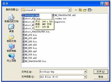

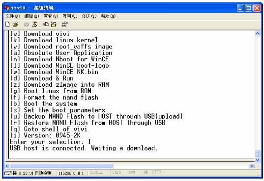

1)Select function [I] in BIOS menu and download bmp format picture for BootLogo.
2)Click “USB Port->Transmit/Restore” in DNW and select bootlogo.bmp which is located in “images\wince6.0\bootlogo.bmp”.
3)After uploading is complete, BIOS will automatically upload bootlogo.bmp to Nand Flash and return to main menu.

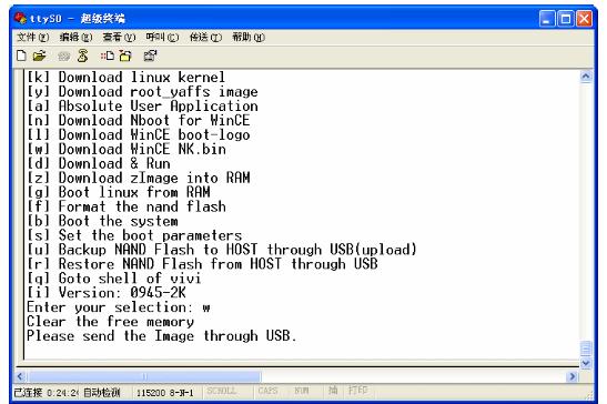

1)Select function [w] in BIOS menu to upload WinCE kernel.

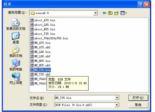

2)Click “USB Port->Transmit/Restore” in DNW and upload the WinCE kernel located in directory “\images\wince6.0”
WinCE kernel description:
NK_W35.bin – apply to 3.5” LCD landscape mode(LQ035Q1DG06 or compatible)
NK_X35.bin –  apply to Sony 3.5" LCD
NK_N35.bin –  apply to NEC 3.5" LCD
NK_T35.bin –  apply to 3.5” LCD
NK_L80.bin –  apply to Sharp 8”LCD( or compatible)
NK_A70.bin –  apply to 7” LCD
NK_VGA1024x768.bin – apply to VGA output, resolution 1024x768

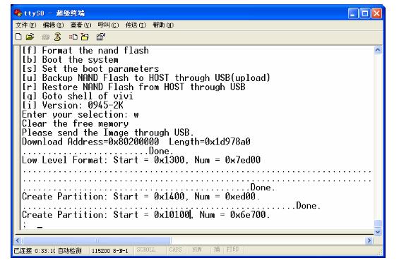

When uploading is complete, BIOS will format the Nand Flash. Then create the partition and upload the WinCE in order. When uploading is complete, the system will start automatically. Serial port message in all procedure is below.
