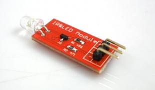

IR Transmitter
IR Transmitter is a Arduino breakout for a simple and clear infrared LED on it. These Infrared lED operates around 940nm and work well for generic IR systems including remote control and touch-less object sensing. Pair them with any of our IR receivers.

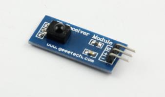

IR Receiver
IR receiver is a breakout board with IR detector mounting on it.IR detector is little microchips with a photocell that are tuned to listen to infrared light at 38KHz. They are almost always used for remote control detection - every TV and DVD player has one of these in the front to listen for the IR signal from the clicker.

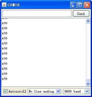

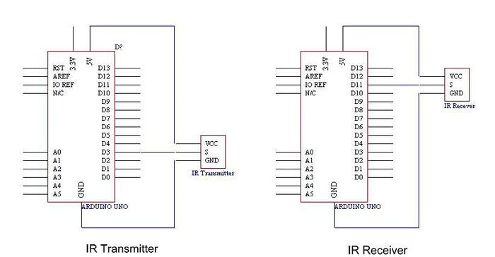

The IR LED on the transmitter module keep on sending hexadecimal code A90 as the modulated IR signal at 38KHz. (More information about how IR LED and detector works ,please vsit Ladyada.com) The IR detector on the breakout detect the IR signal at 38KHz and demodulate it. You can read what the transmitter send on the serial monitor.

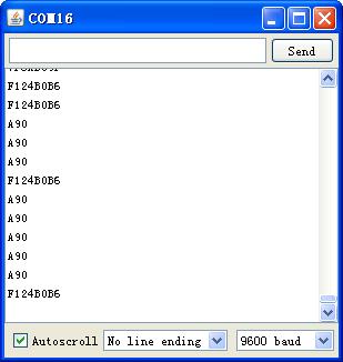

Infrared Led on the IR transmitter module should be directed at IR detector on the receiving board for signal reception.
If the infrared LED is not directed well at the IR detector, the IR detector on the receiving board cann't detect the modulated IR signals well and it will cause the decoded signal incorrect.

int RECV_PIN = 11; //define input pin on Arduino

   Serial.println(results.value, HEX);
