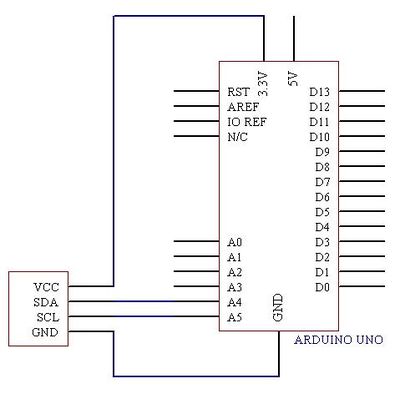

Here is a guide illustrates how to connect an IMU 6DOF board to Arduino. The following is a table describe which pins on the Arduino should be connected to the IMU 6DOF board.
VCC -> 3.3V
GND -> GND
SDA -> A4
SCL -> A5
