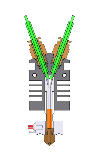

Patented gradient color technology
The Geeetech R&D team has optimized and upgraded Gradient Color Module of Mizar M. Compared with Geeetech’s first-generation multi-color 3D printer, the Mizar M Gradient Color Module has redesigned the color mixing flow channel and a structure to prevent the reverse flow of melting filament. The filament is more uniformly mixed in the hot end. This special design effectively solves the problem of uneven color mixing, and the hot end blocked due to the reverse flow of the melting filament. At present, the gradient color structure has applied for a patent.

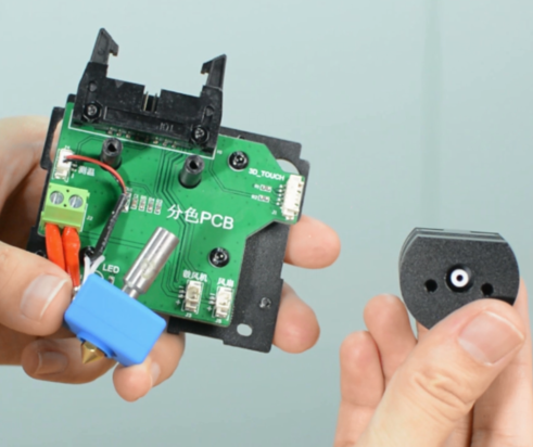

How to replace the Separate Color Module
If you need to replace the color separation module, please click on the video link below to replace it according to the tutorial. replace the Separate Color Module

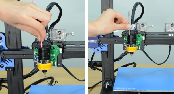

Hotend clogging
Manually feed the filament, if it can not be extruded, try to disassemble the hotend to clean it. For the video tutorial, please refer to our video tutorials:
Clean up the Gradient Color Module of Geeetech Mizar M
Dismantle the Separate Color Module of Geeetech Mizar M
First preheat the nozzle to 220 degrees and then manually push the filament in the hotend to force the stuck filament in the nozzle out. For separate color module, you can use a cleaner rod to push it in and out several times, making the clogging out. Do not use excessive force.
But for the gradient color module, please do not use the metal rod, because it will destroy the little tube inside the hotend. If the clog can not be extruded, please try to disassemble the hotend.

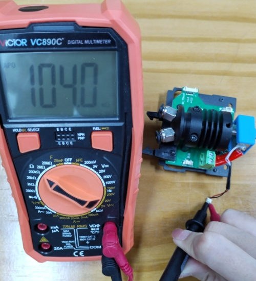

Mintemp error
The Mintemp error in 3D printers is a design feature within your firmware for safety in regard to temperature. When below a set temperature, the heater will be switched off due to possibly having a broken thermistor wire. It can be observed a negative the temperature on the LCD screen.
Check if the hot end connector and thermistor are connected properly. Check the hotend cables and thermistor, make sure they’re not broken or burn out.
You can test the thermistor by a multimeter. If it fails to read the resistance, then the wire is broken. At room temperature, it should be 80 kΩ - 125 kΩ.
Or apply heat to the thermistor with a heater, blow-dryer or other heating device. The resistance should decline steadily in seconds if it works. If not, replace it.

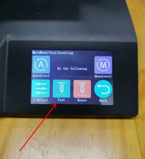

Automatic leveling failed
(a)3D Touch is abnormal
Check if the 3D Touch cables are connected properly. You can use the “Test” function to check if the 3D Touch is working normally.

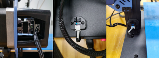

Check the X, Y and Z axes end stops, make sure they’re all connected properly. Note the photoelectric end stops on the Y and Z axes, which normally have a blue signal light. You can home the X, Y and Z axes one by one to check which axis is faulty.

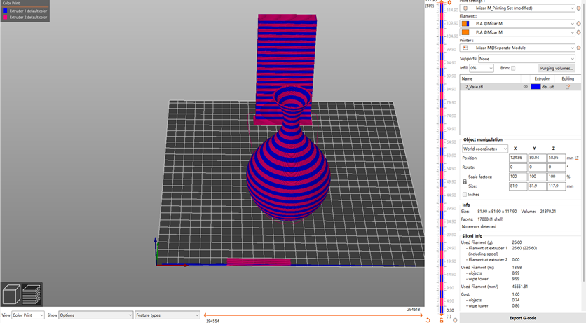

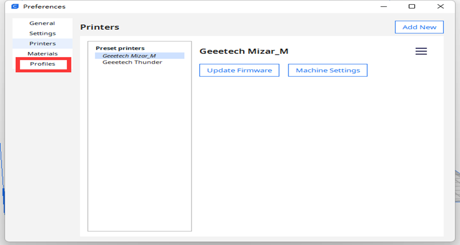

How to slice with Cura

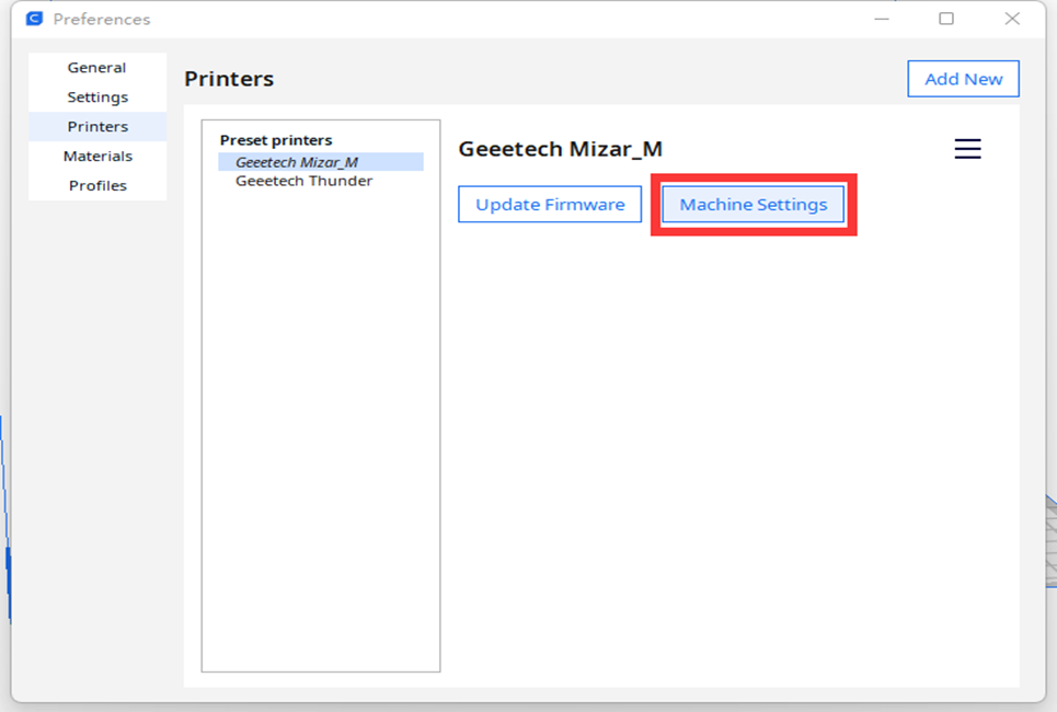

Mizar M Cura Configuration
Mizar M Configuration
File Path
Cura 5.X
Copy “geeetech_Mizar_M.def.json” to Ultimaker Cura 5.X\share\cura\resources\definitions
Copy “geeetech_Mizar_M_extruder0.def.json” and “geeetech_Mizar_M_extruder1.def.json”to Ultimaker Cura 5.X\share\cura\resources\extruders
Cura 4.X
Copy “geeetech_Mizar_M.def.json” to Ultimaker Cura 4.X\resources\definitions
Copy “geeetech_Mizar_M_extruder0.def.json” and “geeetech_Mizar_M_extruder1.def.json” to Ultimaker Cura 4.X\resources\extruders
Cura Profile

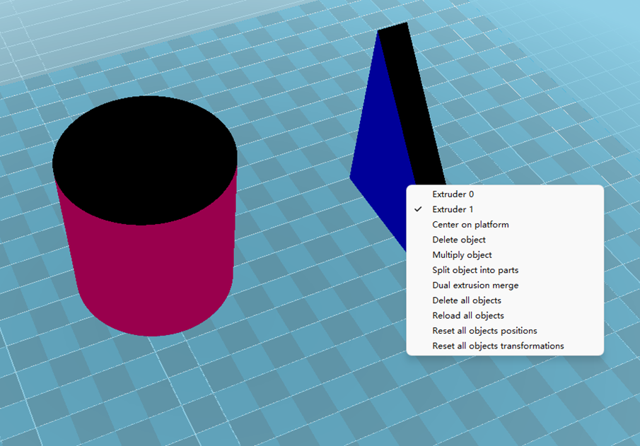

Separate Color Printing
Applied to both Gradient Color module and Separate Color module.

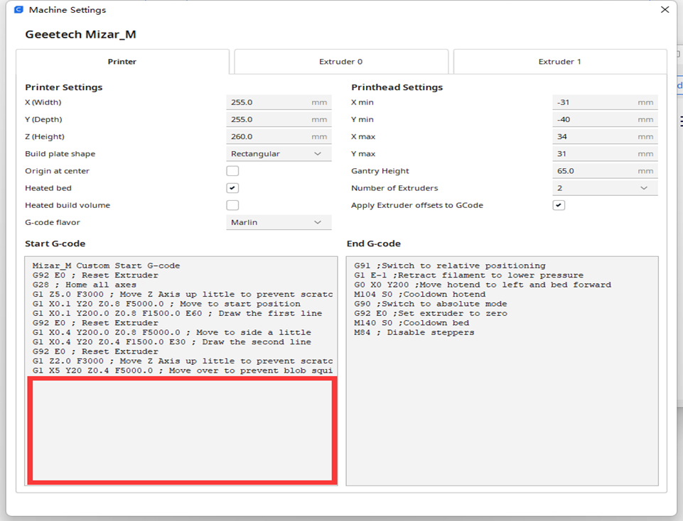

Import 2 or more models, respectively set the extrusion head used by each model, set the size and position of the Prime Tower.
Gradient Color printing
Make sure to install the Gradient Color module in advance.
According to the different effect of the model you want, enter Mizar M printer management settings and edit different contents under the content of Start G-code. The details
are as follows. By the way, gradient color printing can disable the Prime Tower setting option.

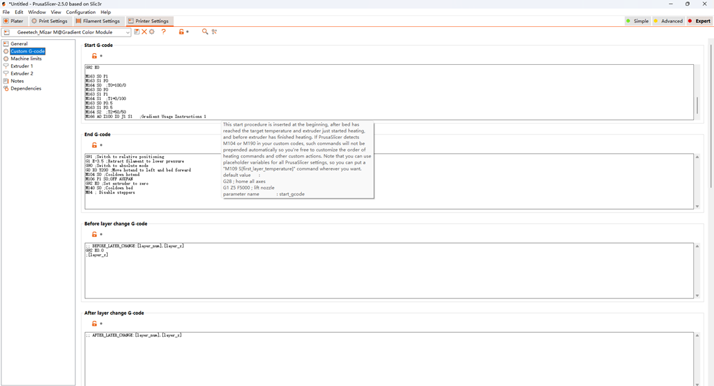

  • Gradient color printing in a fixed proportion
M163 ;Set a mix factor M164 ;Save mix factor
For example, E0/E1 extruded 100%, 0 or 0, 100%, respectively
M163 S0 P1
M163 S1 P0
M164 S0 ;T0=100/0
Then we create the first Tools T0, which will be red.
M163 S0 P1; 100% Red
M163 S1 P0; 0% Green
Now save this color scheme in our Tools T0 we use the command:
M164 S (index), where index is our Tools, and then click:
M164 S0; Store color mixing in tools T0=100/0/0
Now we create the Tools Green, And keep it on the Tools T1:
M163 S0 P0; 0% Red
M163 S1 P1; 100% Green
M164 S1; Store color Mixing in Tools T1

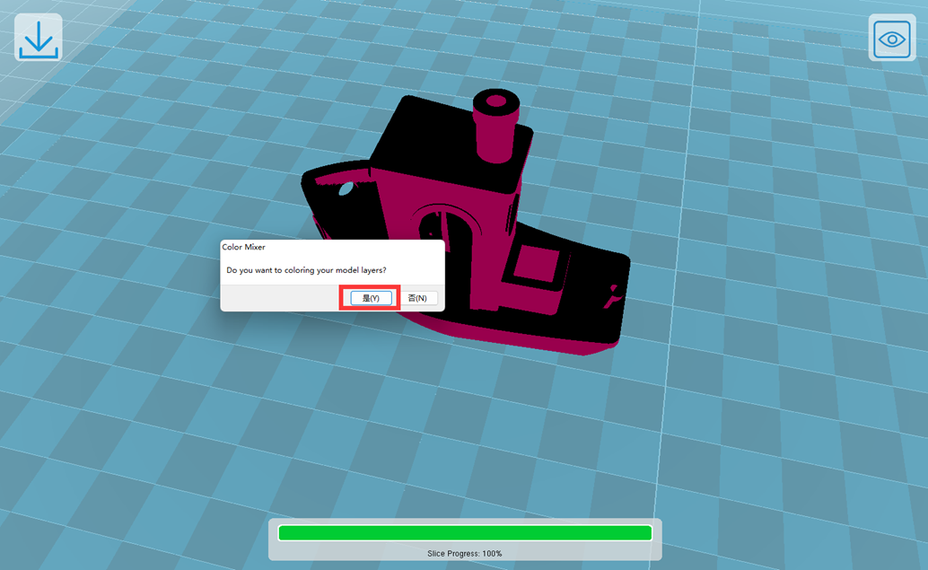

How to slice with Easy Print
Mizar M Easy Print Configuration
Easy Print Slicer

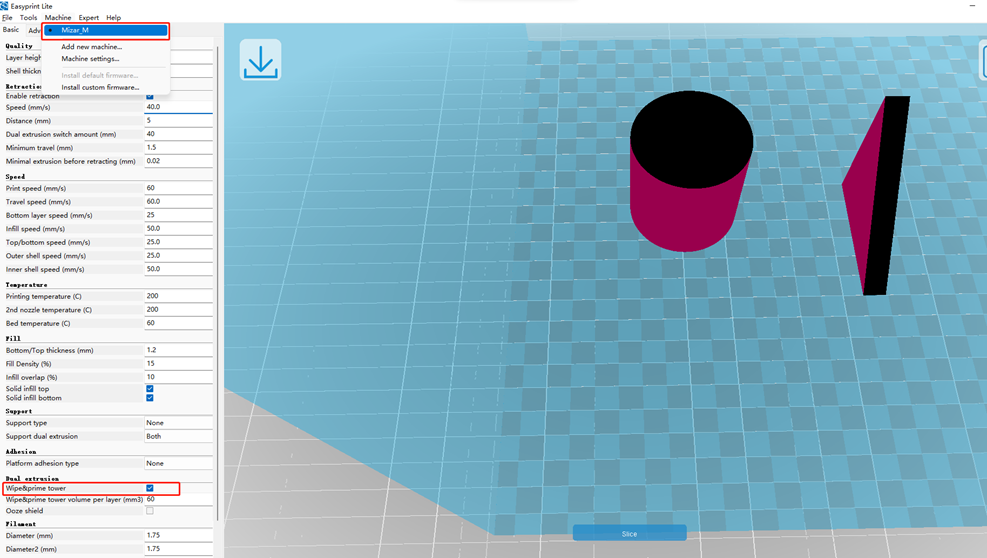

Import 2 or more models, the size of a single model is no more than 200M, add a prime tower, and set the extrusion head for each model. After slicing, select "No" in the prompt box for whether to mix colors.
Gradient Color Printing
  • Mix-color printing in gradient proportions

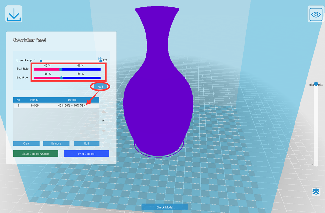

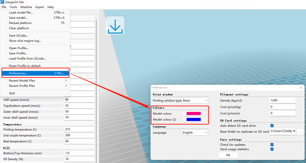

Easy Print adopts visual color mixing effect slice, please set the E0/E1 extruder color in advance, import the model, select the color mixing effect after slicing.
Keep the Start Rate and End Rate consistent, and click "Add" to complete the section.

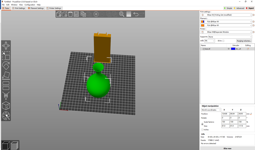

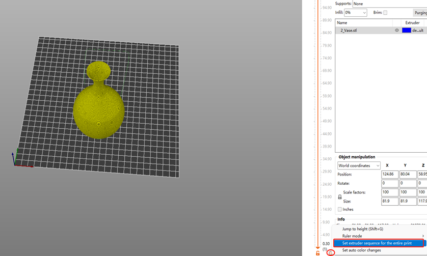

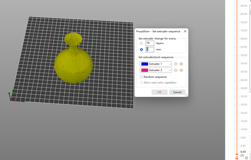

  • PrusaSlicer can print a single model with different height separations.

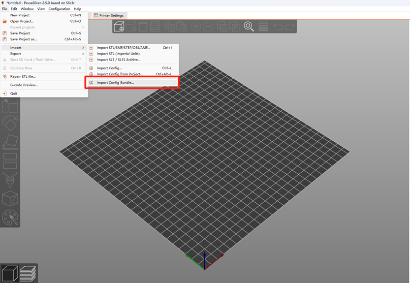

Import the configuration file and the stl model file, set the printing order and height after slicing, and re-slice to preview as shown in the figures.

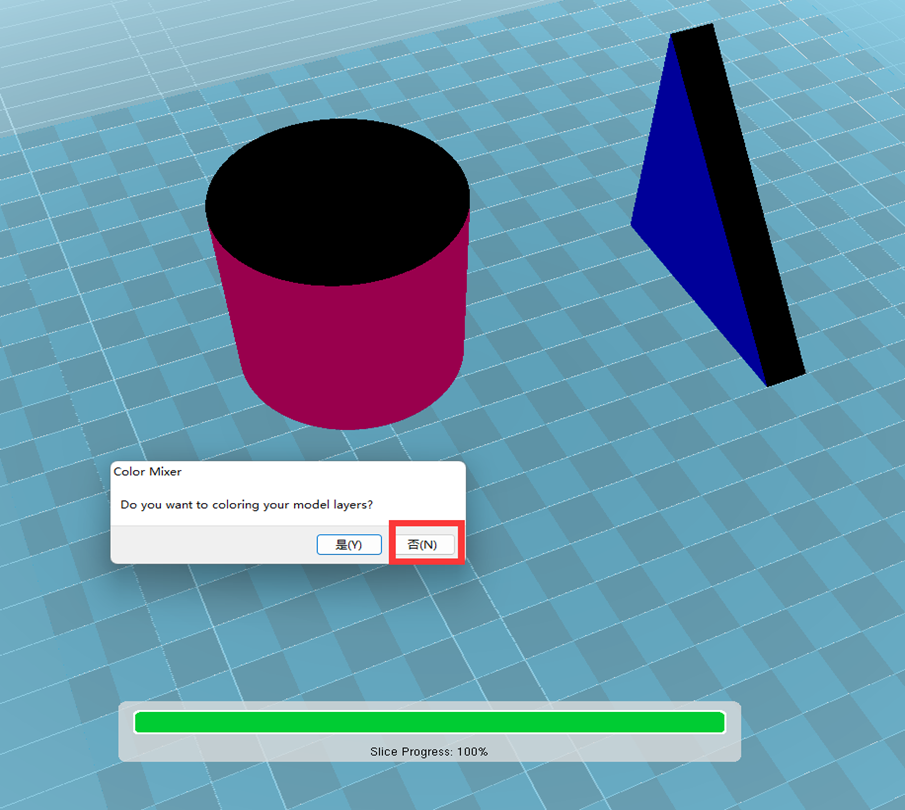

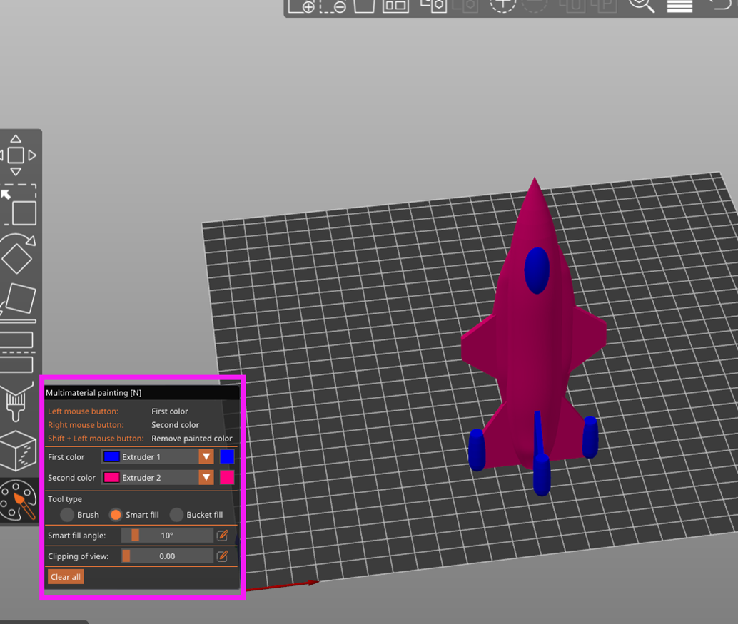

  • Prusa Slicer also has the capability to color separate printing after coloring parts of a single model.
Through the tool Multimaterial painting multi-layer painting palette, the left and right keys respectively select the area to be allocated to different extruder printing, in order to prevent the printing of tainted colors or 3D Touch
impact on the prime tower, it is necessary to change the shape and volume of the prime tower appropriately. What is more worth mentioning is that the prime tower can be made smaller and save filament. The function of "No sparse
layers(EXPERIMENTAL)" in the printing setting should be enabled, but the size of the printing head should be paid attention to in this function to prevent collision with the model.

Start G-code is the same with Cura. For the script, please see Cura Gradient Color printing description.

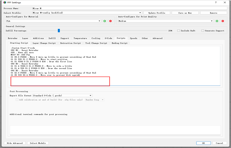

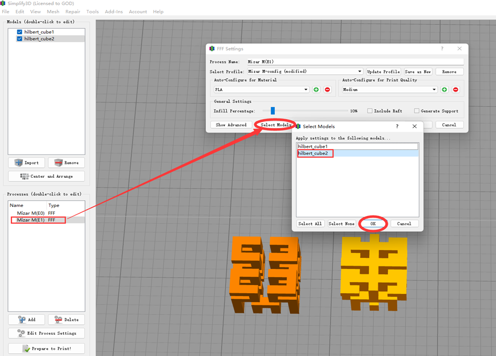

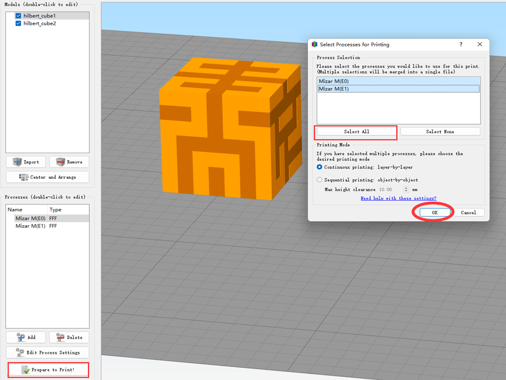

How to slice with Simplify 3D
Mizar M Simplify 3D Configuration

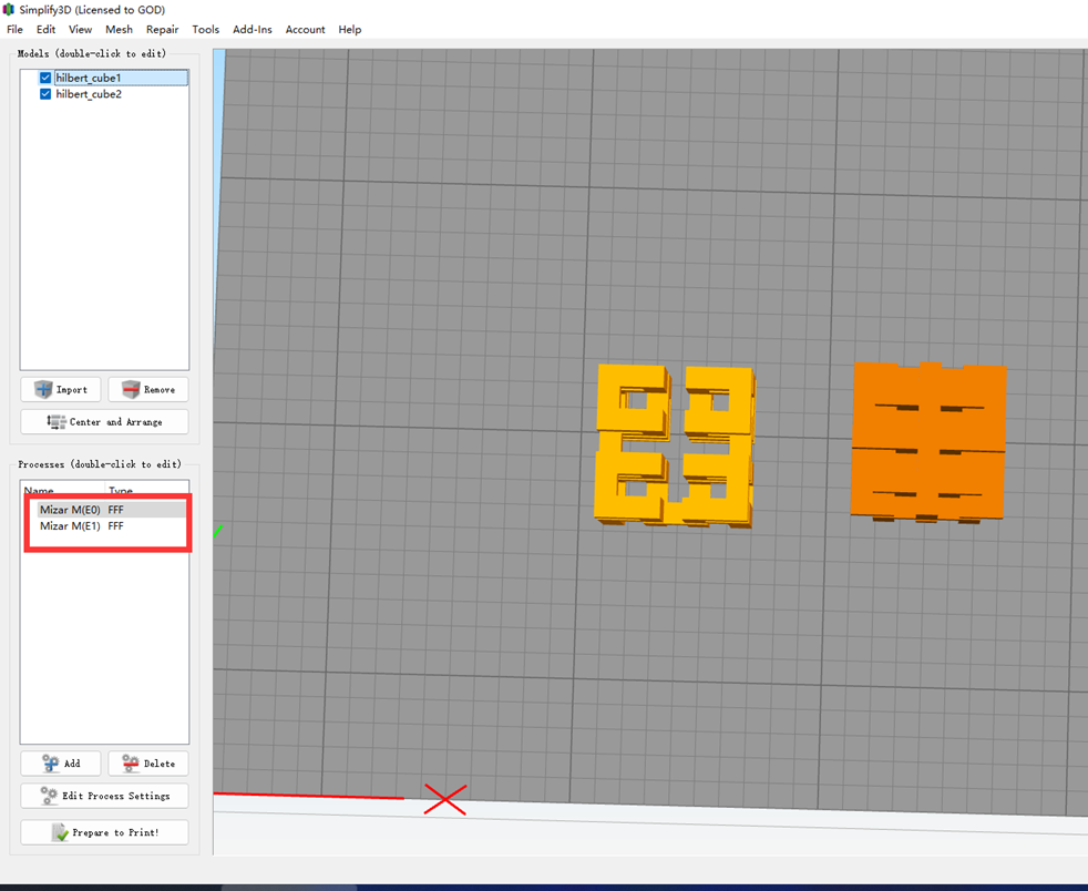

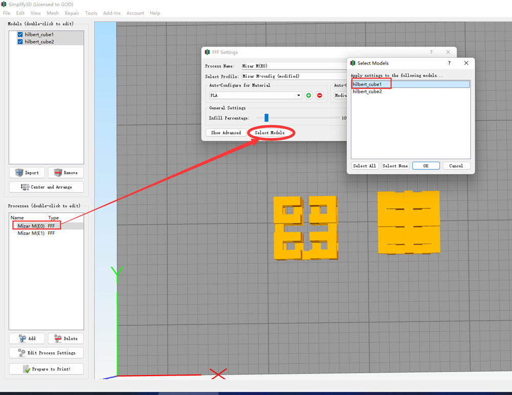

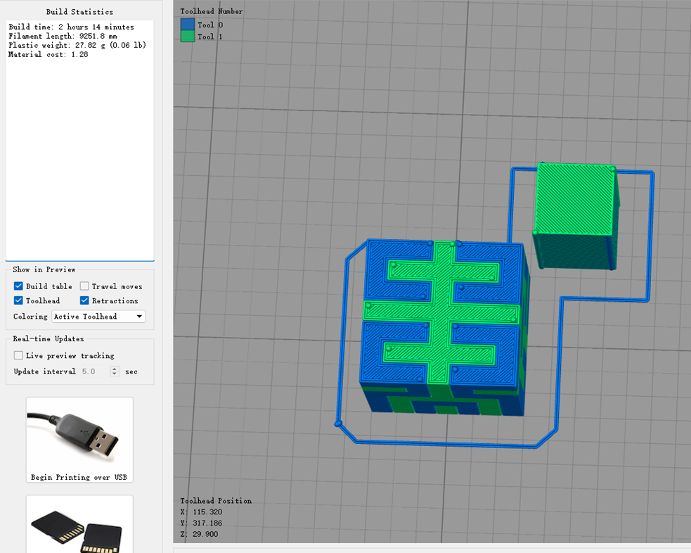

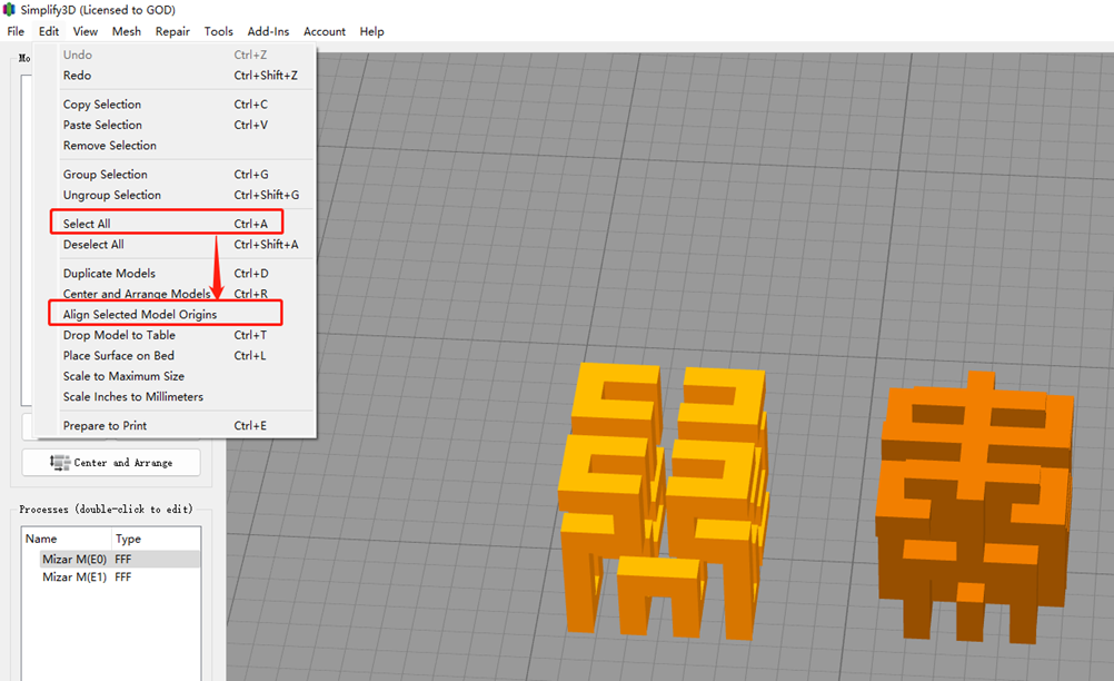

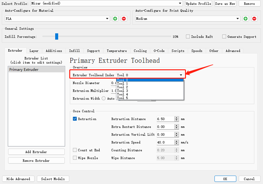

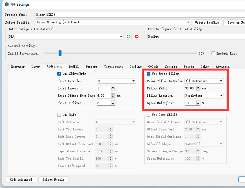

Simplify3D needs to set up separate FFF processes for extruder E0/E1. Set Mizar M(E0) and Mizar M(E1) as shown below. Import 2 or more models, set the extruder head for each model, and set the size and location of the prime tower (for each process). Select all models after Ctrl A, enter the menu and select "Align Selected Model Origins". Select two processes to complete slicing.
Start G-code is the same with Cura. For the script, see Cura Gradient Color printing description.
  • When you use a single extruder, Simplify3D deposit the default E0 extruder. If you need to switch E1, select the extruder number "Tool 1" from the advanced options, as shown in the below figure.

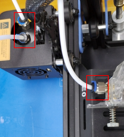

(c)Check the pneumatic fittings. A loose coupling could therefore allow molten filament to leak into a gap between the tube and the nozzle. This will restrict the flow of the filament, causing the extruder keep clicking.
