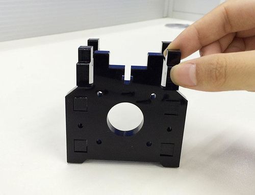

Motor holder assembly
Required parts Part ID Required number
Motor holder
NO.A3
3
Motor holder support
NO.A4
6
Square nut
NO.13
6
M3 x 16 Screw
NO.20
6
M3 washer
NO.5
6

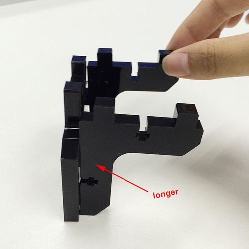

Step1. Assemble A3 and 2 A4 together, and screw up with M3 x 16 screws, M3 square nut and M3 washer.
Repeat the steps for the other 2 motor holders.

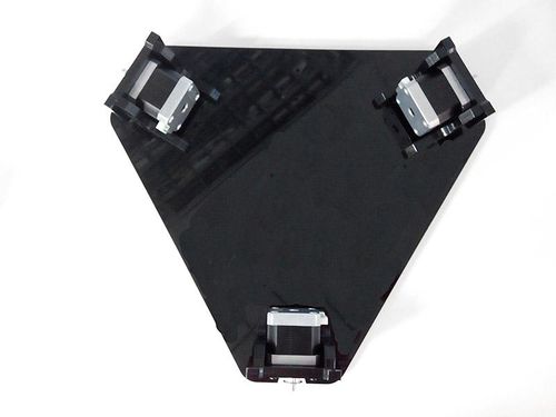

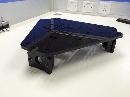

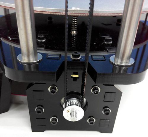

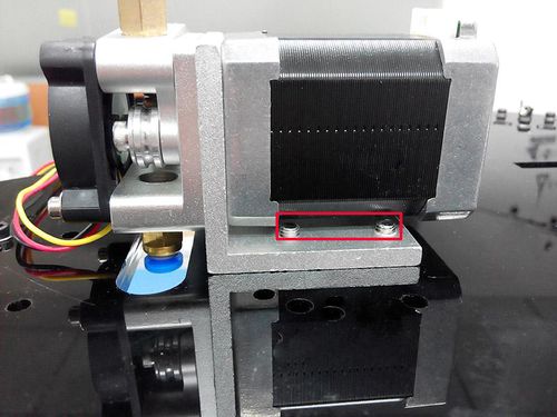

Connect motor ends to base plate
Base plate
NO.A2
1
Square nut
NO.13
9
M3 x 16 Screw
NO.20
9
M3 washer
NO.5
21

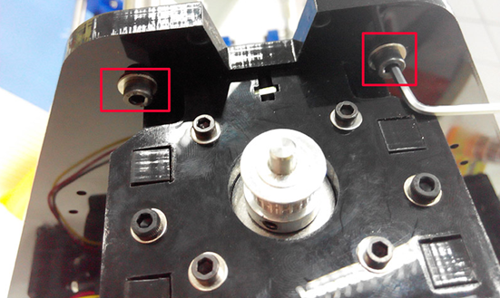

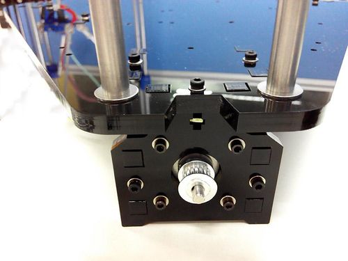

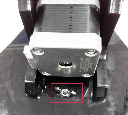

Stepper motor
NO.55
3
Pulley
NO.34
3
M3 x 12 Screw
NO.19
12
Step1. Mount the motor end to the 3 tower of the base plate (A2 ). Fix them with 9 M3 x 16 Screws, Square nuts and M3 washers.

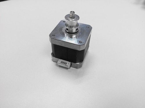

Step2. Mount the pulley on the motor shaft, one of the screws should be screwed on the cross section, the flat side of the shaft. Screw it tightly.
Step3. Mount the 3 assembled motor to the motor holder; screw it up with M3x12 screws and M3 washers.
  • Note the direction of the wire connector, it is better to be on the either left or right side.

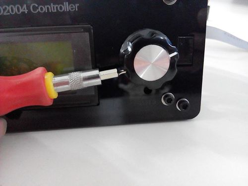

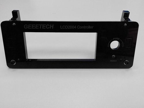

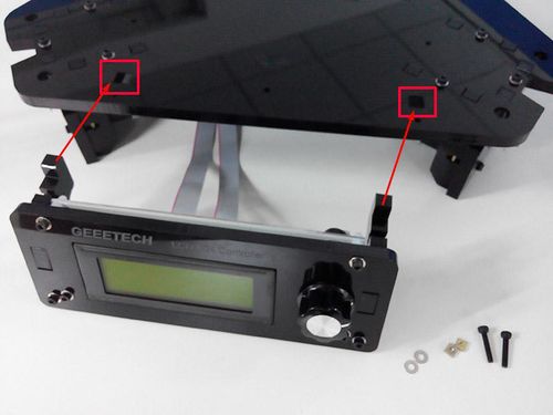

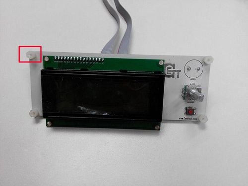

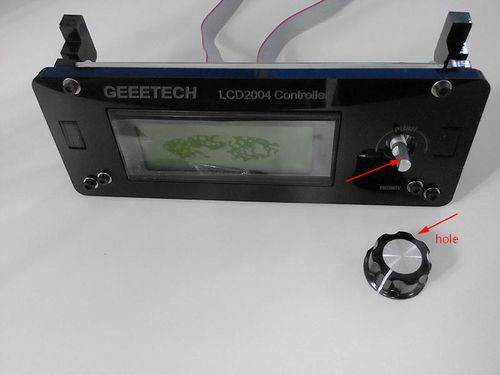

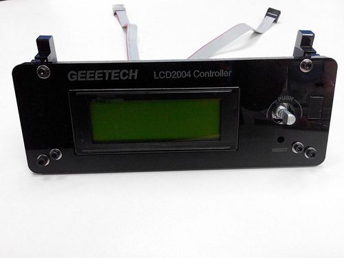

Mount the LCD panel
LCD frame
NO.A8
1
LCD support
NO.A9
1
LCD2004
NO.49
1
Square nut
NO.13
4
M3 x 16 Screw
NO.20
4
M3 x 12 Screw
NO.19
4
Spacer
NO.37
4
M3 washer
NO.5
8
Knob
NO.48
1

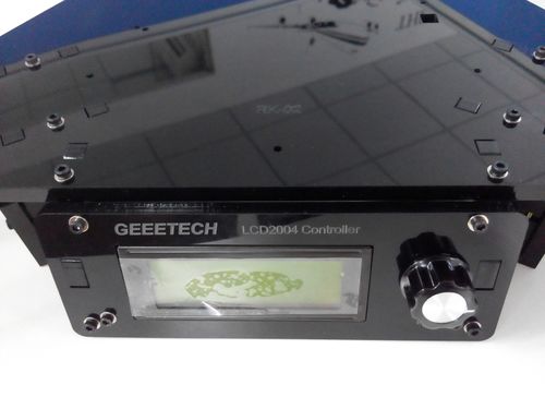

Step1. Assemble the LCD frame and support plate together, screw up with M3 x 16 Screws and M3 square nuts.
Step2. Plug the aircraft- type spacer into the 4 screw hole on the LCD2004.
Step3. Screw up the frame and LCD2004 with 4 M3 x 12 Screws and washers.
Step4. Cover the knob and screw it up on the cross section, the screw is in the hole.
Step5. Mount the assembled LCD kit onto the base plate. Screw it up with 2 M3 x 16 screws, M3 square nuts and washers.

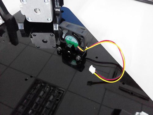

Mount the fan
Fan(40x40x10)
NO.45
1
M3 x 16 Screw
NO.20
1
M3 x 25 screw
NO.22
2
M3 Square nut
NO.13
1
M3 nut
NO.10
2
M3 washer
NO.5
3

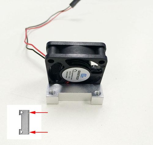

Step1. Mount the fan on the fan mount; screw it up with 2 M3 x 25 screw and M3 nut and washer.
Step2. Mount the assembled fan mount on A2 with a M3 x 16 screw and M3 square nut and washer.

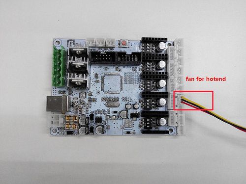

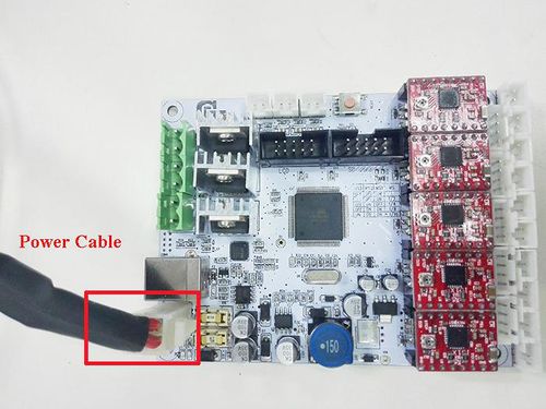

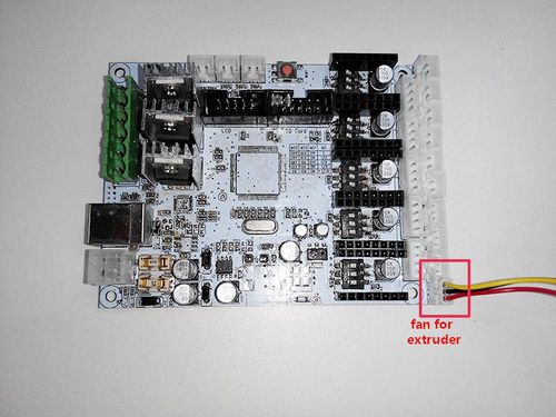

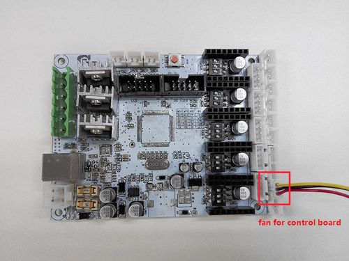

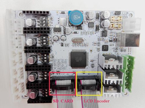

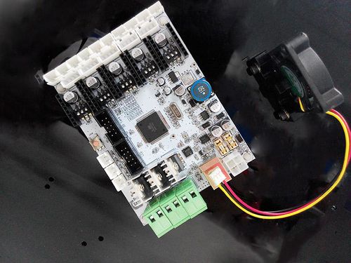

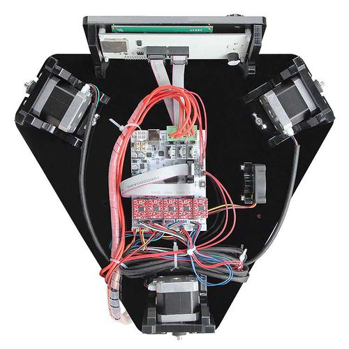

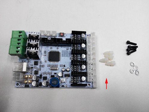

Mount the control board.
Control board GT2560 set
NO.50
1
Spacer
NO.37
4
M3 x 12 Screw
NO.19
4
M3 washer
NO.5
4
Step1. Plug the aircraft- type spacer into the 4 screw hole on the control board from back to front
Step2. Screw the control board to the base plate (A2) with 4 M3 x 12 Screws and m3 washer.
Note the fan is better to be towards the MOSFET of the board.

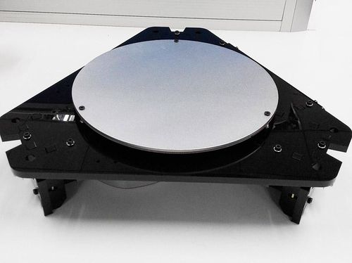

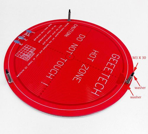

Mount the print bed.
Building platform
NO.M8
1
Heatbed
NO.54
1
Hex Counter-sunk-head screw
NO.14
3
Spring 3.5 x 20mm
NO.28
3
Wing nut
NO.12
3
M3 washer
NO.5
6
  • for your convenience, the heatbed for you is pre-soldered, you can mount them directly.

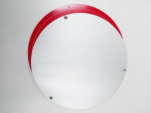

step1. Stack the heatbed and the building platform together.
Step2. Thread the M3x30mm Hex Counter-sunk-head screw through the two plates and add washers and spring at this end.
Step3. Lock the other end with a wing nut.
Here is the finished picture.

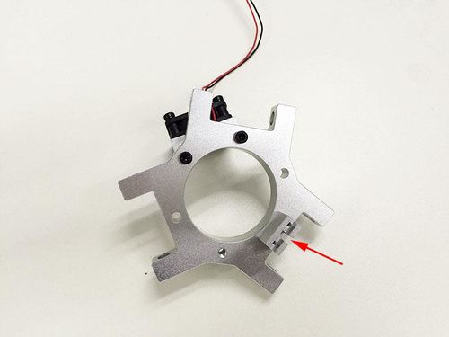

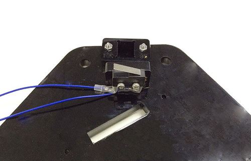

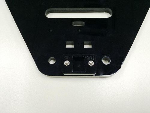

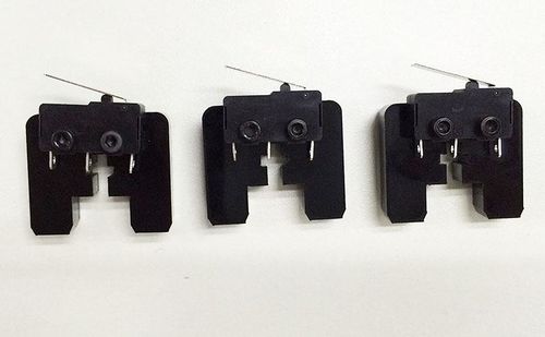

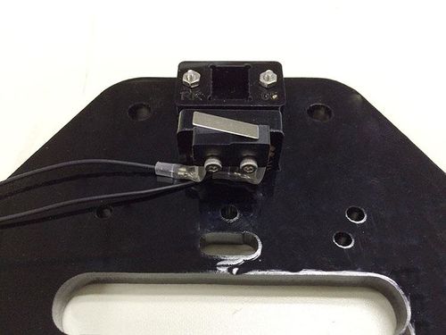

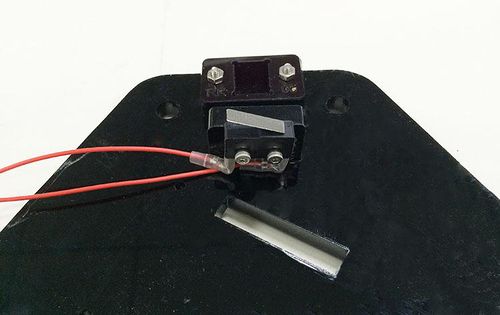

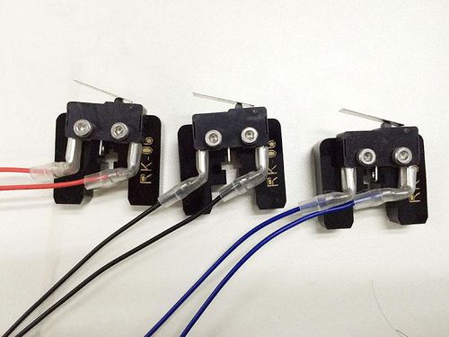

Endstop mount
Top plate
NO.A1
1
Endstop mount
NO.A6
3
Endstop
NO.44
3
M2.5 x 16 screw
NO.17
6
M3 x 16 Screw
NO.20
3
Square nut
NO.13
3
M3 washer
NO.5
9
M2.5 nut
NO.9
6

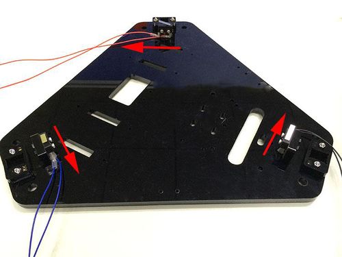

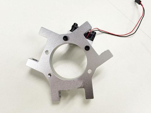

Step1. Mount the three end stops onto the Endstop mount (A6) in the same direction, screw with M2.5 x 16 screws and M2.5 nut tightly
Step2. Bent the wire connector a bit.
You should do it very gently and note the direction, or it will break easily.
Step2. Mount the assembled parts onto the top plate. Screw up with M3 x 16 screws, M3 square nuts and M3 washers. Again,note the directions of the endstop.
  • The opening of the endstop should be in clockwise direction or anti-clockwise direction.

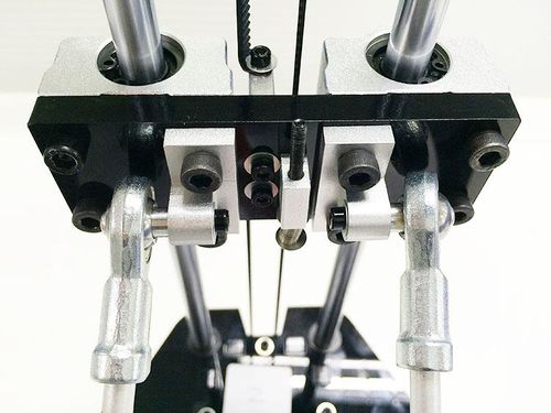

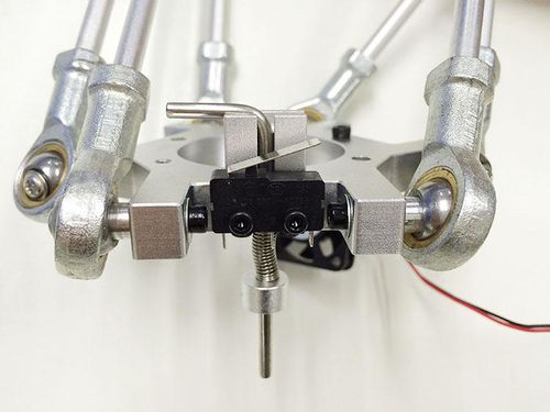

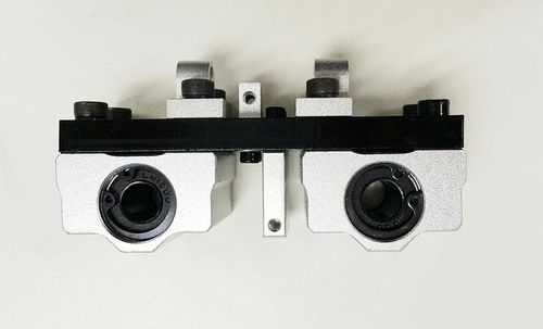

Assemble the carriage
Carriage mount
NO.A12
3
Belt mount
NO.M5
3
Endstop trigger mount
NO.M6
3
Diagonal Rod joint
NO.M7
6
SCS10UU Linear Bearing
NO.35
6
M3x8mm Screw
NO.18
6
M3x12mm Screw
NO.19
12
M5x16mm Screw
NO.27
24
M3x40mm Screw
NO.23
3
Spring
NO.29
3
M3 washer
NO.5
24

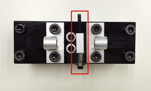

rod-end bearing holder
NO.3
6

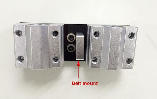

Step1. Fix the belt mount on the A12 with 2 M3 x12 screws and washer.

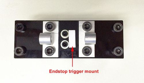

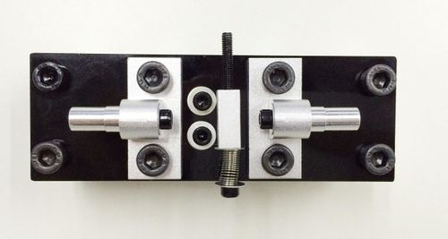

Step2. Fix the Endstop trigger mount on the other side of the A12 with 2 M3 x 12mm screws and washer.

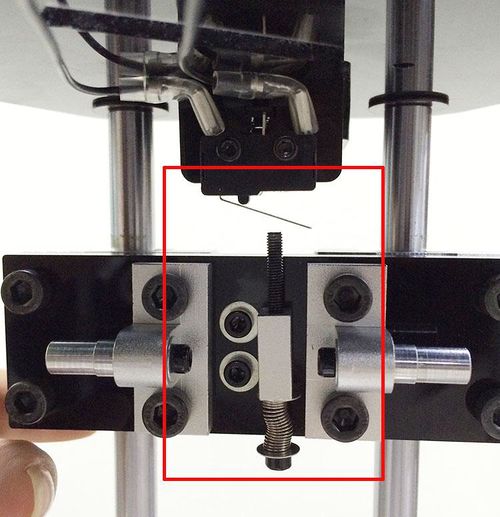

Step3. Connect the diagonal rod joint and the SCS10UU linear bearing with the A12 in between. Fix it up with 8 M5x16mm screws.
Note the direction of the diagonal rod joint, the wider edge is near the Endstop trigger mount.

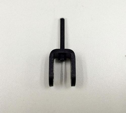

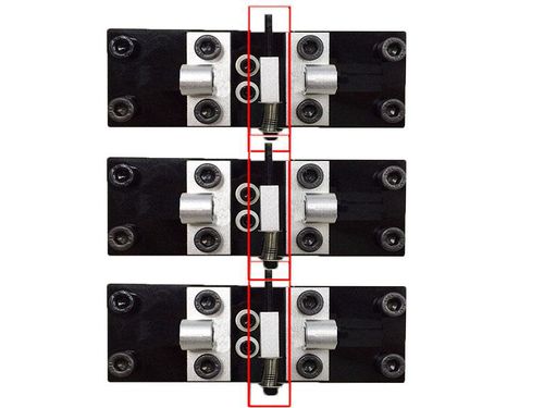

Step3. Put the M3x40mm screw into the Endstop trigger mount with a spring in between. Here you need to use washers
Repeat the steps for the rest two carriages.
The 3 carriages should be exactly the same.
Step4. Insert the rod-end bearing holder into the diagonal rod joint, fix it with a M3x8mm screw and M3 washer.
Repeat the step for the other 2 carriages.

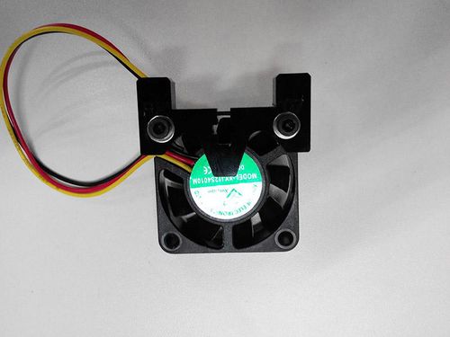

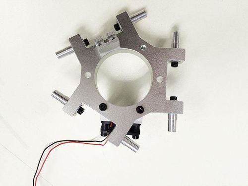

mount the fan

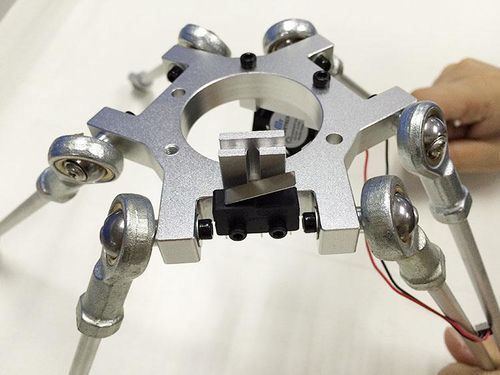

Spider
NO.M1
1
Fan(30x30x10)
NO.47
1
Fan mount
NO.M2
1
M3 x 16 screwt
NO.20
2
M3 x20 screw
NO.21
2
M3 washer
NO.5
2

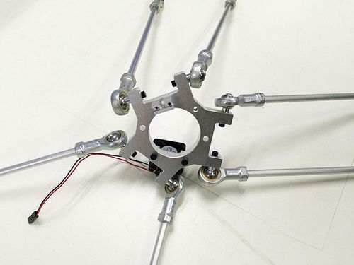

Step1. Screw the fan onto the slant side of the fan mount with 2 M3x 20 screws and M3 washers.
Step2. Mount the assembled fan mount on the spider with 2 M3 x16mm screws.

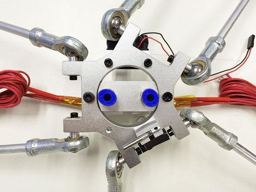

Mount the Probe mount
Probe mount
NO.M4
1
M2.5 x 16 screw
NO.17
2
Mount the Probe mount on the spider with 2 M2.5 x16mm screws from bottom to up.
Mount the rod-end bearing holder and diagonal rod
Diagonal Rod
NO.4
6
NO.3
6
Round head screw with pad
NO.15
6
M3 washer
NO.5
6
M3 x 8 screw
NO.18
6

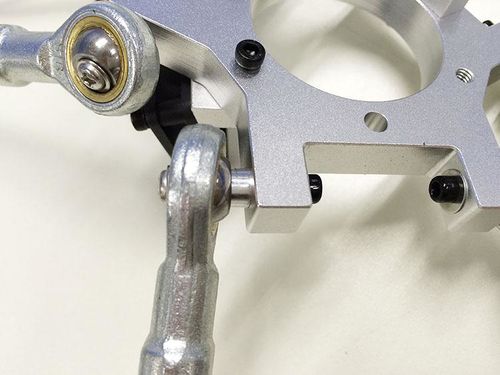

Step1.Insert the rod-end bearing holder into the diagonal rod joint on the spider, fix it with M3x8mm screw and M3 washer.
Step2. Fix the Diagonal Rod on the rod-end bearing holder with Round head screw with pad.

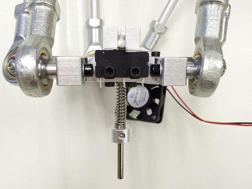

Mount the endstop and the probe.
Endstop
NO.44
1
Probe
NO.43
1
Spring(3.5*30)
NO.29
1
Probe Lock ring
NO.M3
1
M2.5 x 8 screw
NO.16
2
Step1. Mount the endstop on the spider close to the probe mount with 2 M2.5 x 8 screws.
Step2. Put the probe into the probe mount and lock it with a lock ring and spring.

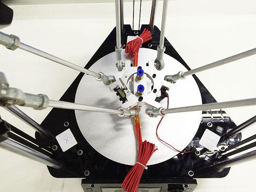

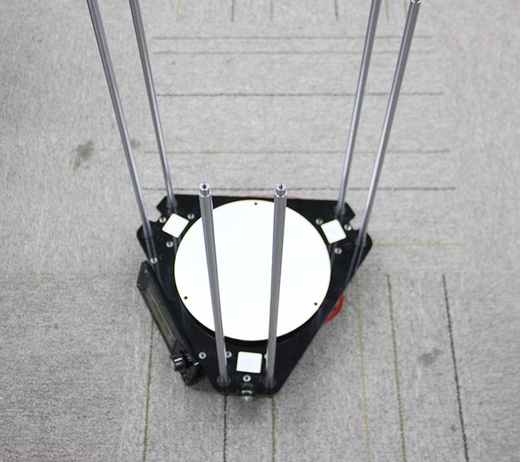

Mount the smooth rods
Smooth Rod
NO.1
6
M4 x 8 Screw
NO.24
6
M8 Washers
NO.8
6
M4 washer
NO.6
6
Step1. Put a M8 washer on the end of the smooth rod.Insert the rods into the holes on the base plate;
Step2. Screw up the rods with M4x8 screws ans M4 washers.
Repeat the above two steps for other 5 rods.

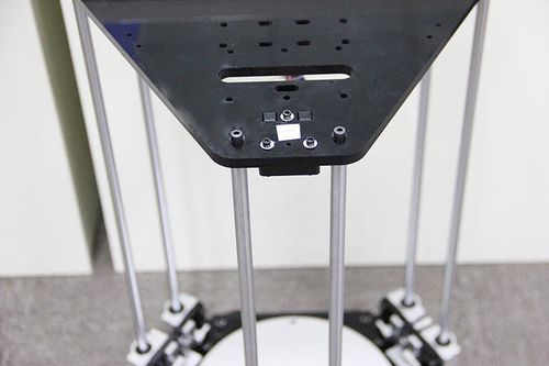

Mount the carriage and the top plate
M4 x 8 Screw
NO.24
6
M8 Washers
NO.8
6
M4 washer
NO.6
6

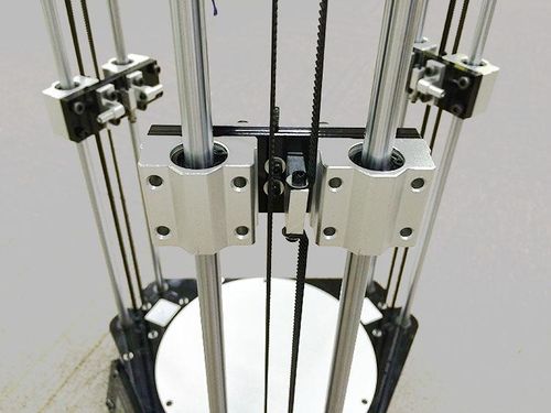

Step1 Slide carriages into the 6 smooth rods separately.
Note:
  • When you do this, you’d better take the top plate here to check if the long screw on the carriage will hit on the opening of the endstop when the carriages raised up.
  • If you find it difficult to slide the carriage to the rod, or it cannot slide smoothly,
you can loose the screws on the linear bearings a bit.
Step2. Put a M8 washer on each top end of the rods and cover the top plate on the rods, screw them up with M4x 8 screws and M4 washers

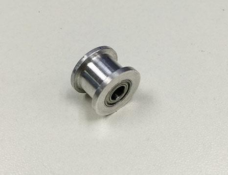

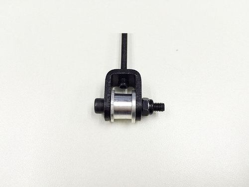

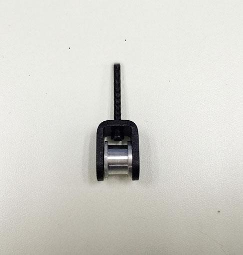

Assemble the driving wheel
Driven wheel holder
NO..33
3
Driven wheel
NO..32
3
R84zz Ball Bearing
NO..31
6
M3 x16mm screw
NO..20
3
M4 x 25mm screw
NO..26
3
M4 washer
NO..6
3
M4 lock nut
NO..11
3
wing nut
NO..12
3

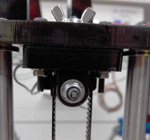

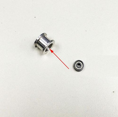

Step1. Thread the M3 x 16 screw through the Driven wheel holder.
Step2. Insert the two MR84zz ball bearings into both ends of the driven wheel.
Step3.Put the M4 x25 screw and M4 washer through the driving wheel. Lock the other end with a M4 lock nut. You may need a wrench to tighten locking nut.
  • Do not screw it too tight, you should leave enough room for the wheel to turn freely.
Repeat the steps for the other 2 driven wheel.

Step4 Tighten the wing nut to taut the belt.
Repeat the above steps for the other 2 belts.

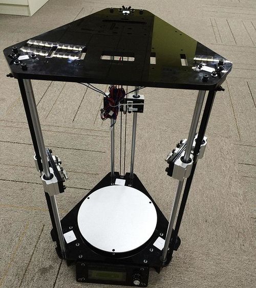

Connect the Diagonal Rod to the carriage
NO.15
6
Connect the Diagonal Rod on the assembled print platform to the carriage.
  • Note. The auto-leveling device is towards the X tower, as shown in the picture.

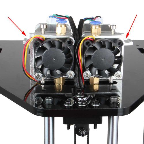

Mount the extruder
Lets take the dual extruder as example.
Extruder
NO.56A&B
2
M5 x 16 screw
NO.27
8
Find out the locating holes on the top plate; screw up the extruder with 8 M5 x 16 screws and washers from bottom to up.

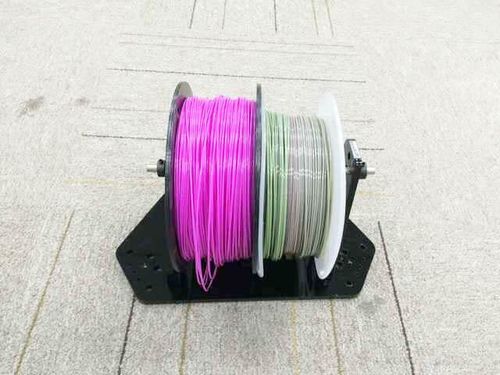

Mount the filament holder
This step can also be finished at last if you like
Spool holder Side panel
NO.A10
1
NO.A11
1
M3x16 screw
NO.20
4
Square nut
NO.13
4
locking ring
NO.30
2
Screw up A10 and A11 on the top plate separately with M3x16 screw,M3 square nut and washer.
EXAMPLE 1: G2
EXAMPLE 2: G2S
For this dual filament spool, you need to use the locking ring to lock the spool on both end.

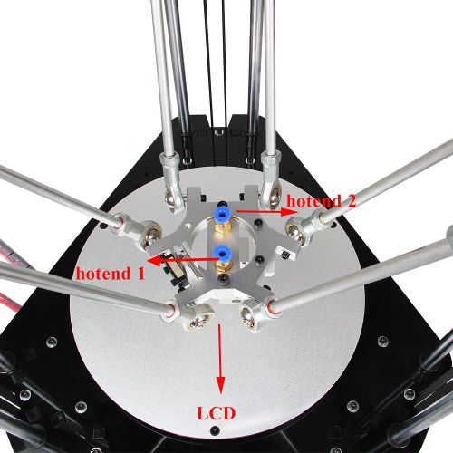

Connect the feeding pipe
Feeding pipe
1
1
Step1. Plug one end of the tube into the push-fitting on the hotend and the other end into that of the extruder.
Before connecting the pipe, you need to match the extruder and the hotend:
The positive extruder is refered to as no.1, and the reversed extruder is no.2,
  • If you need to pull the tube out, please press the blue part while pulling.

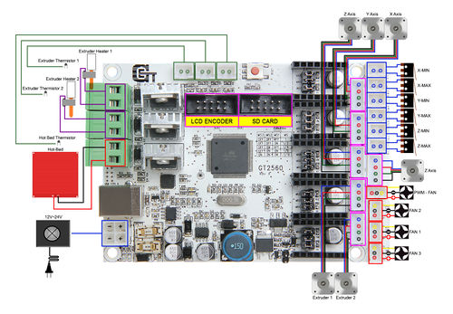

Wiring
Before you start wiring, please take a look at the wiring schematics.
You can see original picture here.

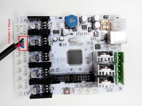

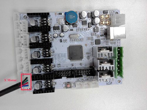

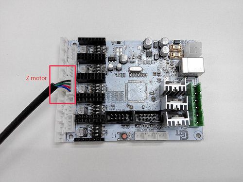

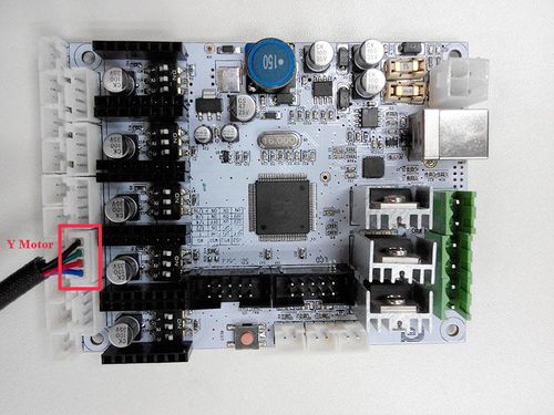

Step1. Connect wires for motors.
1) Connect wires for X-axis motor.
2) Connect wires for Y-axis motor.
3) Connect wires for Z-axis motor.
4) Connect extruder

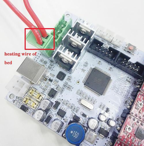

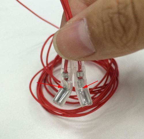

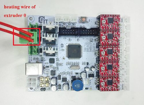

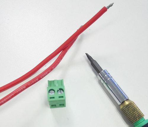

Step4. Connect heating wires.
Loosed the screws in the green terminal and put the red wires into the slot and screw it up.
* There is no “+” and “-“for heating wires
1) Connect heating wires for heatbed.
2) Connect heating wires for extruder .

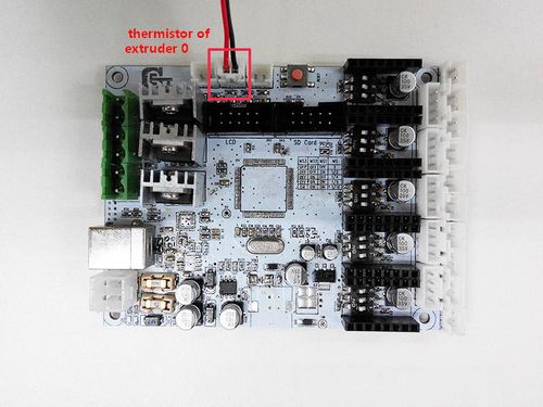

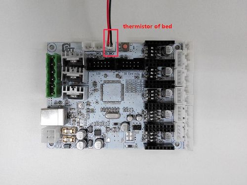

Step4. Connect wires for thermistor.
1) Connect wires for thermistor of heatbed.
2) Connect wires for thermistor of extruder 0.

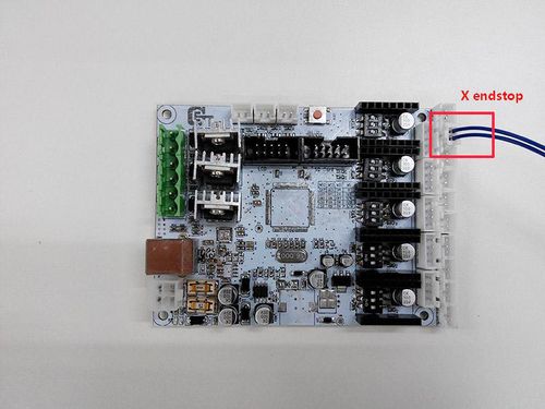

Step5. Connect wires for endstop.
endstop
41
3

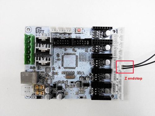

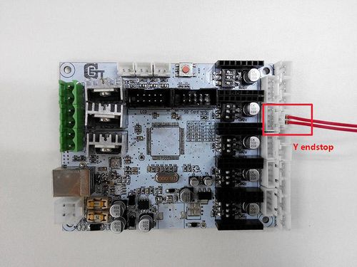

1) Connect wires for endstop of X-axis at X-max.
2) Connect wires for endstop of Y-axis at Y-max.
3) Connect wires for endstop of Z-axis at Z-max.
Step6. Connect wires for Fan.
1) Connect fan for control board at FAN1.
2) Connect fan for extruder at FAN3.
3) Connect fan for hotend at FAN-PWM.
Step7. Connect wires for LCD panel.
There are two cables, one is for LCD encoder, the other is for SD card, do not connect them reversed.
Step8. Connect wires for power input.
Power cable
48
1
Plug the other end into the PSU. Do not forget to cover it.

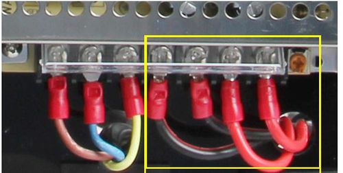

Step9.Connect the power cable to the input connector of PSU
3D Power cable
49
1
As shown in the red box.
That is all for the wiring of GT2560.
As there is no place for the PSU on this printer, you should take good care of it; keep it away from kids and pets.
Tidy out the wires
Use the spiral coil and zip ties to put those wires together.
If you tidy up the wires first before wiring,you are advised to mark each wires or connectors in case you mix them up.

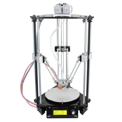

So far, the Rostock mini G2( G2s) has been fully assembled.
