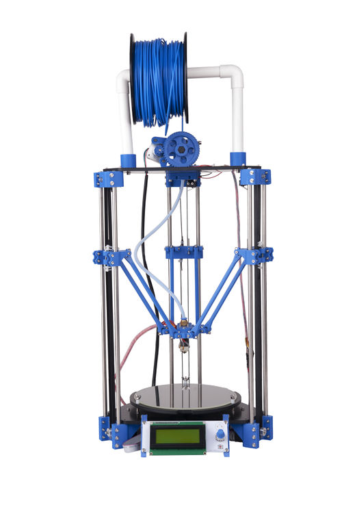

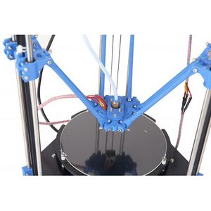

Geeetech Delta Rostock mini
Introduction
The Rostock mini made by Geeetech is a delta 3D printer based on the modified design of the original Rostock created by Johann. The printer is designed to have a smaller build volume allowing for a smaller, more compact, portable, and desktop friendly version of the delta RepRap design. Using OpenSCAD, the parametric nature of the design files allows for print surfaces to be configured from as small as the default 152x152 mm (6x6 inches) all the way to 300x300 mm (12x12 inches) or more. Further, construction parameters such as the length of the drive belts, diagonal rods, and a laser cuttable frame, as well as the firmware parameters such as diagonal rod length and delta radius are all automatically calculated based on the size of the specified print surface.
Features:
1. Mini- size & light weight, more compact & portable compared with other Delta RepRap design.
2. Fixed printing platform, parallel kinematic XYZ axes with low accumulated error, ensuring high precision & speed of printing.
3. Bakelite print platform with treatment of sand blast and anodization; polished oxidized high borosilicate tempered glass. Compared with aluminum sheet and acrylic sheet, the has advantages of high mechanical strength, good insulation, good heat resistance and good corrosion resistance
Main parameters
Physical Dimensions & Weight
Machine size: 280mm*340mm*700mm (L/W/H)
Packing size: 510*410*260mm (L/W/H)
Weight: 9000g
Printing Specifications
Printing Technology: Fused Filament Fabrication,FFF
Operating system: Windows/Mac/Linux
Slicing software: Cura / Repetier
Control software: Repetier-Host
Data format: all 3D files converted into STL file
Layer Resolution: 0.05mm
Build Volume: 150 x 150 x 180mm
Filament Type: ABS/ PLA (ABS used only when hot bed is equipped)
Filament Diameter : 1.75mm/3mm
Nozzle Diameter: 0.3mm, 0.35mm, 0.4mm & 0.5mm optional
Location accuracy: 0.1mm
Temperature
Max Heated Bed Temp: 110 ℃
Max Extruder Temp: 240 ℃
Mechanism
Physical structure: Delta
Frame: AISI304 stainless steel optical axis with Bakelite of 6mm thickness
Build platform: tempered glass with 198mm diameter and 3mm thickness
Movement mode: printing platform fixed; X, Y and Z axes all subject to parallel movement
Extrusion system: Bowden feed
Motors: nema17, 2.5A
Electrical
Input AC 220V/2.4A(110V/4.8A),Output DC 12V/29A
Connectivity:USB or SD card

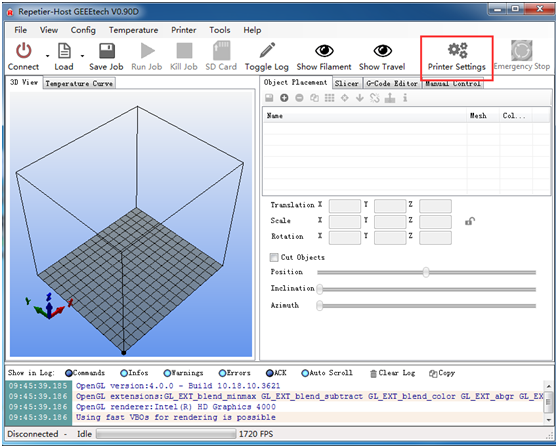

Install Software
we will take windows OS as an example.
To install all required software by Delta Rostock mini, please follow the steps provided below.
1) Download and install: RepetierGEtechSetup.exe
step 1,start the installer,choose the display language. step 2,click next to continue
step3,select the destination where you would like to install the RepetierGEtechSetup.
step4,select start menu folder and create a shortcut, click next to continue.
step 5,get ready to install. Click install.
step 6,wait about half a minute while installing. The green bar will show you the rate.
step 7,set up has finished the installing, you can choose to launch it immediately or exit out.
2) Plug the power cord into a wall outlet and the USB cable into a USB port on your computer. Windows should detect your motherboard and assign the appropriate driver.
3) Open Repetier Host and Connect to your Delta Rostock mini!

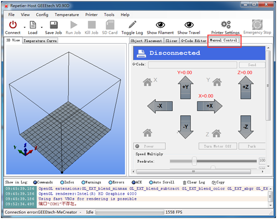

Click on the Manual Controls Tab and click in a direction X or Y to test your connection. If you are having difficulty connecting, please review the following supportive documentation: Installing Drivers and How to connect.
Please note that if you have difficulty connecting, there might have been an issue with the installation process. Ensure that the following have been installed:

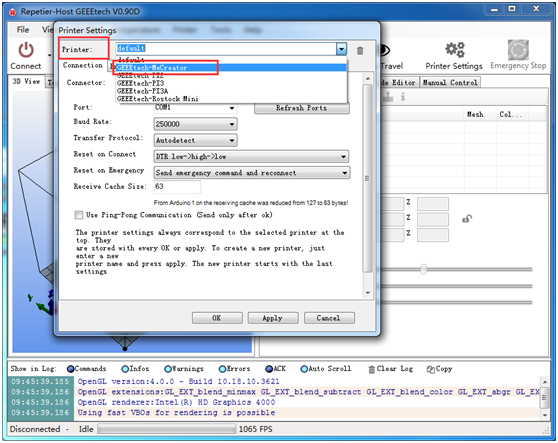

3. Open Repetier Host and ensure that you have a valid port selected for communications. To do this simply click “Printer Settings” in the upper right-hand corner to bring up the printer settings menu.
4,Select GEEEtech Rostock mini in “Printer”

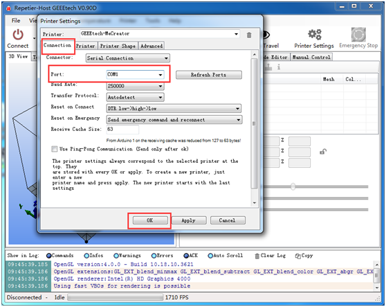

5,Select the corresponding COM port, click OK to continue.

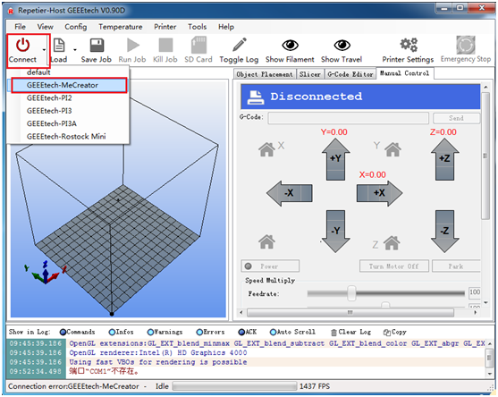

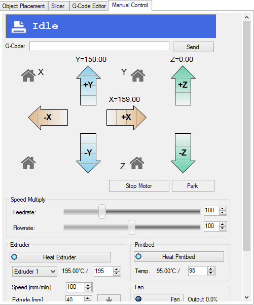

6. Hit "connect" in the upper left-hand corner, select GEEEtech Rostock mini. You should see the details of the connection in the console window in the bottom section of the screen.
7. In the right panel, click on the "Manual Control" tab.
8. Scroll down and click both heat extruder and heat printbed buttons to activate your heaters. You will know they are on if they turn a bright blue.
The heat will gradually rise, as you will see from the status bar on the bottom of the window. The extruder should be set to 195° and the bed should be set to 95°.
7. Once full heat has been achieved do a few quick tests. Hit the X+/X- arrows to ensure that movement is possible.
Hit the extrude button, with the down arrow, in the Extruder section to ensure extrusion is possible.

3.How to move the axis and extruder motor separately
Press the button>”Prepare”>”Move axis”>”Move 10mm/1mm/0.1mm”>”Move X/Y/Z/extruder”
Note: The extruder motor can not move unless the temperature is more than 180 degrees.
4.What if you can not move the axis with you hand
Press the button>“Prepare”>”Disable steppers”
5.How to set the temperature of extruder
Press the button>“Control”>”Temperature”>”Nozzle”>Rotate the button>Press the button
6.How to set the temperature of hot bed
“Control”>”Temperature”>”Bed”>Rotate the button
