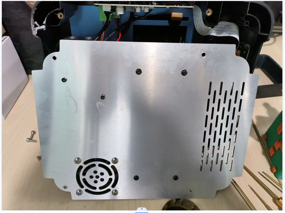

How to replace motherboard
The following is a video tutorial to replace the motherboard, please follow the tutorial. replace motherboard purchase link motherboard

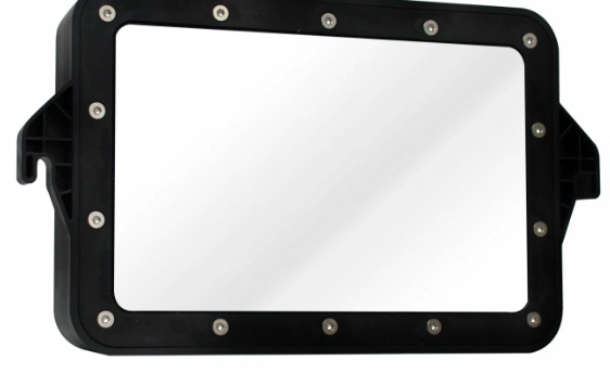

How to replace FEP film
First please prepare a sheet of FEP film, which can be purchased from the link below. FEP film
Unscrew the screws in the picture below.
Install the new FEP film, take care not to exhaust the screws when screwing, just make sure to screw well. Because too much force will cause damage to the pressure plate fixing FEP film, as shown in the figure below.
At the same time, FEP film is a consumable and vulnerable part, and needs to be cleaned and maintained in time after use.

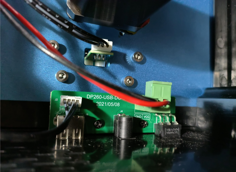

How to replace power supply
Below is the power supply, if the light on the power supply is not bright, it needs to be replaced. Please contact technical support.

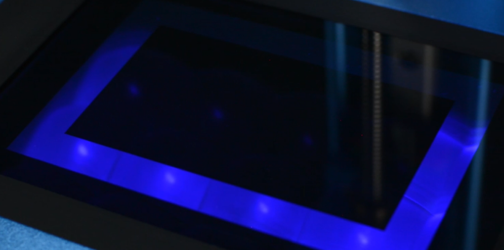

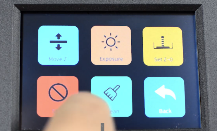

Please click the exposure test button in the image below to perform the exposure test.
Please check whether the print screen under the exposure test is as shown below. If the effect is not good, you need to replace the print screen.

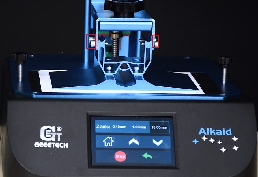

How to replace Forming Platform
Unscrew the four screws of the forming platform and then remove the forming platform. When installing a new forming platform, be careful not to tighten all the screws at once. As with the leveling operation, screw the four screws to half loose and half tight, make sure the platform is level, and then tighten all the screws. Purchase link Forming Platform

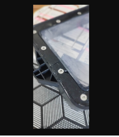

The pressure plate is damaged
The pressure plate is broken as shown in the figure below. The pressure plate purchase link The pressure plate
The rupture of the pressure plate will cause the resin in the resin box to leak onto the printing screen, and the resin is corrosive and likely to corrode the printing screen. When replacing the FEP film, please be careful not to use too much force, just make sure that the screw is screwed properly, if too much force will cause the pressure plate to crack.

Resin non-stick forming platform
1.Please re-level, be careful not to tighten all screws at once after zero, which will cause the forming platform to skew. Turn the four screws in turn until they are half loose and half tight, and then tighten all screws after ensuring that they are level. Try printing another model after leveling it.

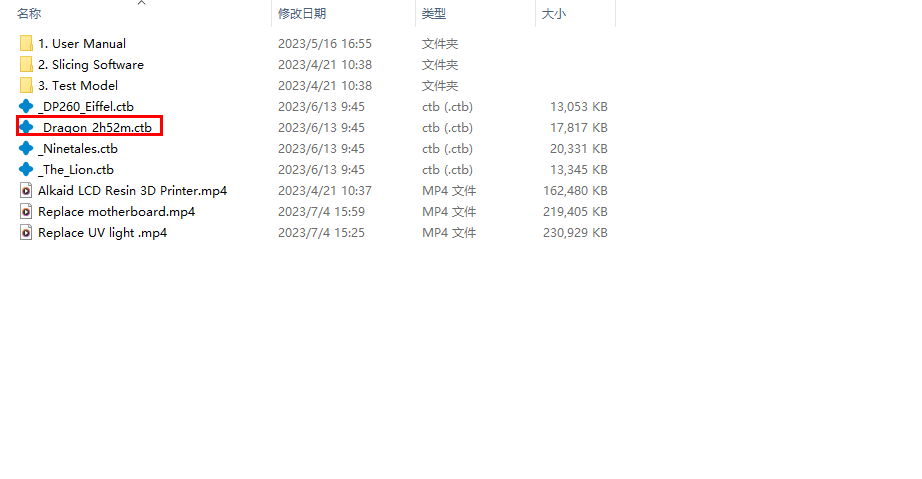

The printer cannot recognize the file

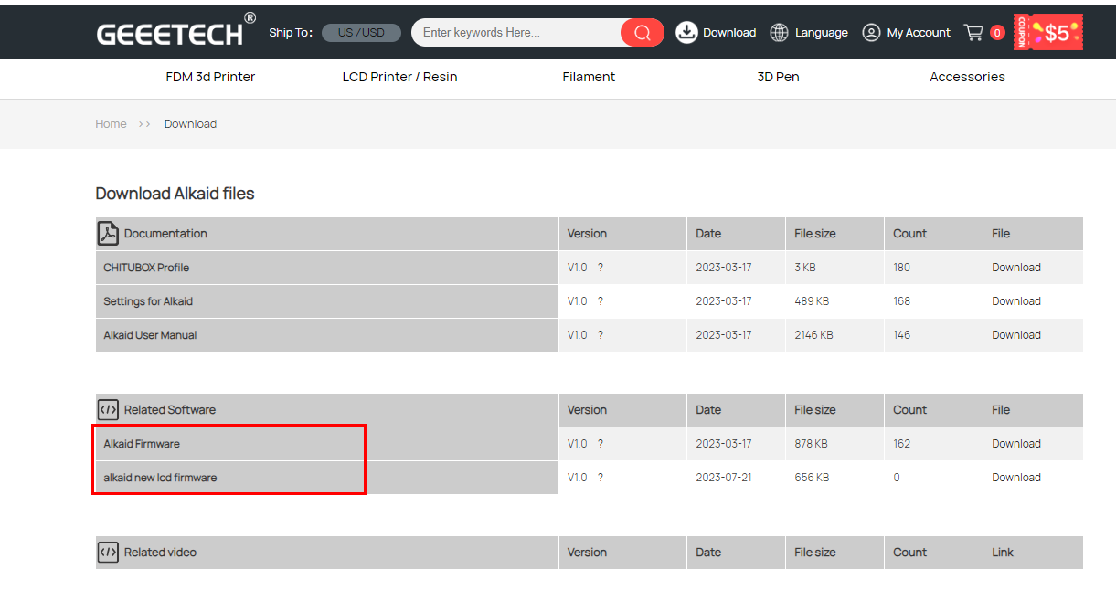

Alkaid can only identify files with the suffix.ctb and print them. Please print the cut files on the USB flash drive.
If the printer cannot print.ctb files, refresh the firmware. Below is the firmware link, please download the firmware file in the red box and refresh it.
If the file is still not recognized after updating the firmware, then the USB port is damaged and needs to be replaced, please contact technical support to replace it.
