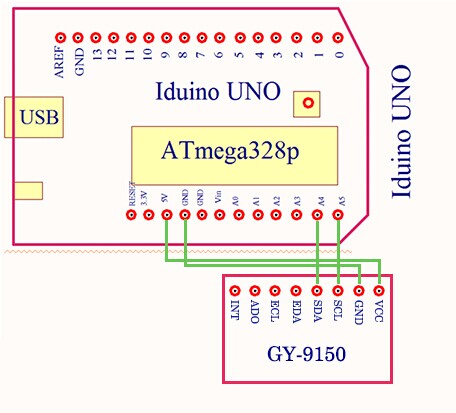

Interface specifications
Reserved interface description:
1. SCL, SDA: standard IIC communication interface
2. EDA: Auxiliary I2C serial data (Auxiliary I2C Master serial data)
3. ECL: Auxiliary I2C serial data (Auxiliary I2C Master serial clock)
4. ADO: I2C slave address (I2C Slave Address LSB)
5. INT: Interrupt digital output (Interrupt digital output)
File Burning
No file burning needed for this Module.
This product is rigorously tested before shipping. If you want to re-test it and you’ll need an Iduino UNO development board, you can get an Iduino UNO development board on our online store.
