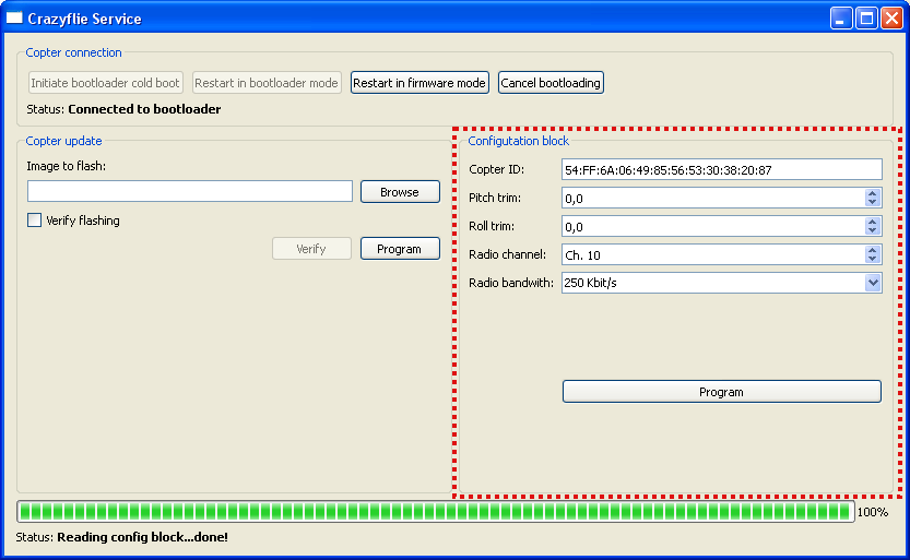

Configuration Block
It is possible to set another channel to communicate with the Crazyflie. It can be wise to do this if there exist other wireless networks that can interfere, especially WiFi. It is also possible to permanently store the trim values for pitch and roll.
To edit the configuration block you will have to enter bootloader mode as described in Bootloader above. Once you are connected you will see a dialog similar to the picture to the left.
It is now possible to change:
  • Pitch trim Can be programmed permanently with the trim values found to work good in the flight tab.
  • Roll trim Can be programmed permanently with the trim values found to work good in the flight tab.
  • Radio channel Can be set to anything between 0 and 125, correspond to a frequency from 2400MHz to 2525MHz. In most countries channel 0 to 80 is OK to use but this should be checked with you local regulations. If using 2M datarate, the copter channels should be 2MHz apart.
  • Radio bandwidth This can set the radio bandwidth to 250k, 1M or 2M. A lower bandwidth has longer range but has higher chance of collision. When used inside sometimes it is better to use 1M or 2M as it decreases the risk of collision with WiFi.
Once the settings has been made press the program button to save them permanently in the Crazyflie flash. They can be changed again any time with the same procedure.
