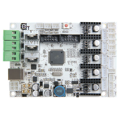

GT2560/GT2560A+ is a compact board that is integrated with the mighty function of the Arduino Mega2560+Ultimaker and Arduino Mega2560+ramps 1.4 on respect of both software and hardware and has more premium features: the streamlined interfaces effectively avoid the unnecessary troubles, well-regulated compaction of components highly integrated saves more space and easier to be mounted on most applications.
5 stepper motors, swappable driving modules, mighty ATmega2560 processor with 256k memory, 16MHz operating frequency, high-performance USB serial converter FT232RQ/CH340, all these make the GT2560 an ideal option for a 3D printer control board. What’s more, GT2560 can run over 12V to 24V which gives higher torque and higher rotation rate.
Features:
1.Integrated with the mighty function of the Arduino Mega2560+Ultimaker and Arduino Mega2560+ramps 1.4 kit, The GT2560 can not only take full place of them on respect of both software and hardware, but also features compact size, more convenient connection, and more stable.
2. Adopt ATmega2560 as the main control chip, coupled with the high-performance USB serial converter FT232RQ/CH340.
3. The power pack: operating voltage is 12V-24V; double power supply design provide for heatbed and logical part separately,overcurrent protection is also provided.
4. The main circuit adopts SMD fuse tube, the diode added to the power port can provide reverse protection to the whole circuit, in addition, the 5V USB is USB port protected with 500mA Recoverable fuse.
5.3 12v fan output and one PWM output for LED or other lighting equipment.
6. 3 55Amp MOSFET (with LED indicator, the actual output is restricted by the PCB board and the connector), all 3 MOSFET are equipped with heat sink to ensure sufficient heat dissipation and stable operation.
7. Support 5 A4988 stepper drivers (3 for X/Y/Z axis, and 2 for extruders); the subdivision of stepper motor can be setup by dial switch, eliminating jumper caps, easier to operate.
8. 3 temperature sensor input (100k thermistor is recommended)
9. Extended LCD and SD card interface support both LCD2004 and LCD 12864, with which you can print without your PC.
10. The firmware is the prevalent Marlin, which is known for stability, usability, and high-performance.

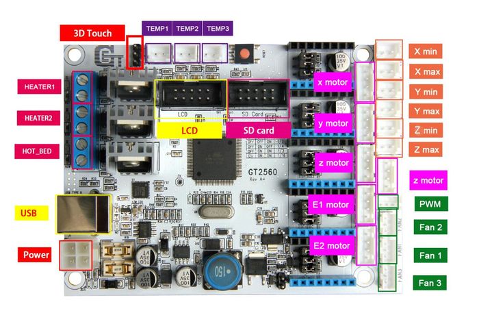

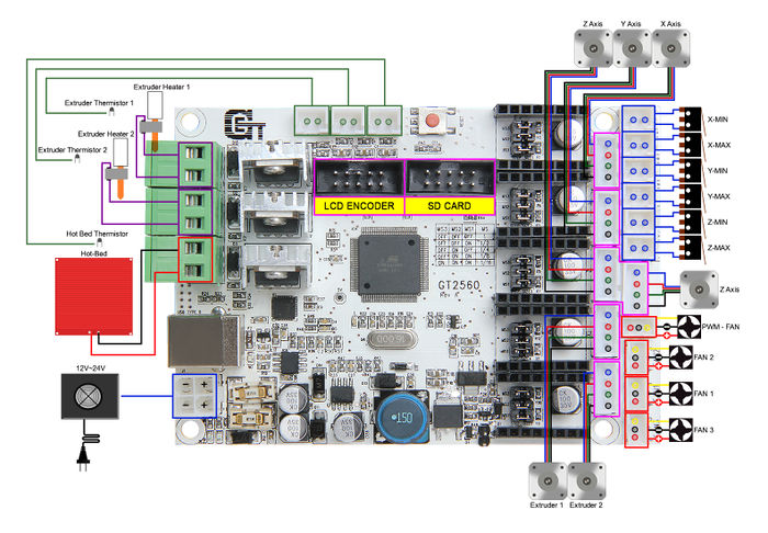

Interfaces
Interface Layout
GT2560A
GT2560A+
Interface specifications
1.DC IN: 12V-24V 15A and 12V-24V 10A 2.HOT_BED: heat bed
3.HEATER1: power supply for extruder 1
4.HEATER2: power supply for extruder 2
5.LCD ENCODER: LCD panel
6.SD Card
7. X_MIN/X_MAX/Y_MIN /Y_MAX /Z_MIN /Z_MAX: 6 end stop input (XH2.54-2 pin)
8. TEMP1: temperature sensor for extruder 1(XH2.54-2 pin)
9. TEMP2: temperature sensor for extruder 2(XH2.54-2 pin)
10. TEMP3: temperature sensor for heatbed(XH2.54-2 pin)
11. X,Y,Z:Stepper motors for X, Y, Z axis, XH2.54-4Pin
12. EXT1, EXT2(A):Stepper motors for extruder 1 and extruder 2, XH2.54-4Pin
13. FAN1,FAN2,FAN3:3 12V cooling fans, PH2.0-3Pin
14. PWM: PWM output for cooling fan (FAN: PH2.0-3pin)

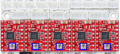

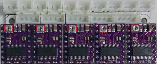

Use jumper caps to subdivide stepper motor. when jumper cap is plugged, it is ON.
2-2
1. Subdivision on the base of A4988 stepper driving module:
Turn ON/OFF            Subdivision
MS1    MS2    MS3
OFF    OFF    OFF    full step
ON     OFF    OFF    1/2 step
OFF    ON     OFF    1/4 step
ON     ON     OFF    1/ 8 step
ON     ON     ON     1/16 step
2. Subdivision on the base of Drv8825 stepper driving module:
MS1    MS2    MS3
ON     OFF    OFF    1/2 step
OFF    ON     OFF    1/4 step
ON     ON     OFF    1/ 8 step
OFF    OFF    ON     1/16 step
ON     OFF    ON     1/32 step
OFF    ON     ON     1/32 step
ON     ON     ON     1/32 step

Pay attention to the Plus-n-Minus of the power connector, reverse connection can cause irrevocably damages.
A4988 should also be connected to the right port, mismatches and revered directions can cause damage to the main board.
The correct connections are as follow:
If you are using DRV8825 instead of A4988, The correct connections are as follow:

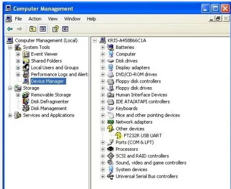

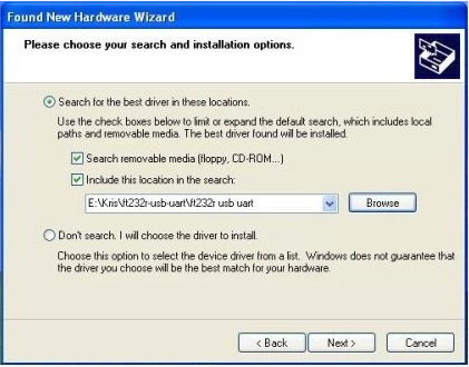

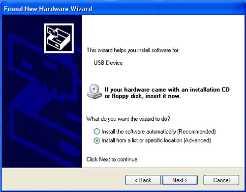

FT232RQ Driving Installation: Windows will prompt that a new USB Serial Port is detected, now you can check the device manager, you will see a new port named“USB Serial Port”
Then, windows will open the dialog box “found new hardware wizard”, check “no, not this time”, then click “next” to continue.
Then, windows will open the dialog box “found new hardware wizard”, Check “install from a list or specific location (advanced)”, then click “next”.
Specify installation directory where FT232RQ is to install driver. Click “browse” to find the directory and click “next” to continue.

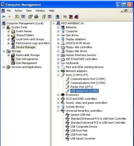

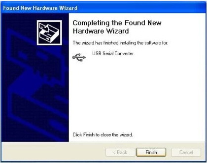

If everything goes well, windows will install the Serial Driver for GT2560.
The graph below shows installation completed.
Now, you can find the corresponding Serial port in device manager of windows.

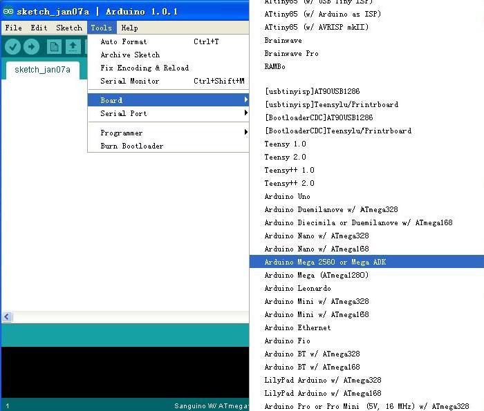

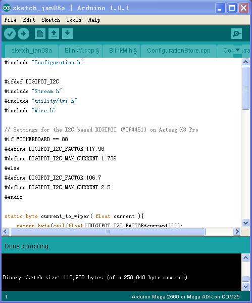

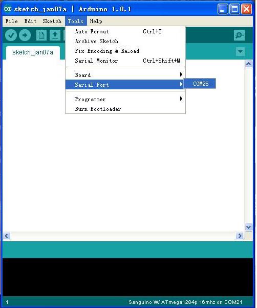

Windows users need install driver before uploading. The board: Tools > Board > Arduino Mega 2560 or Mega ADK, as shown below.
Configuring serial interface: Tools > Serial Port > the corresponding COM Port of GT2560 usually the last one. As shown below

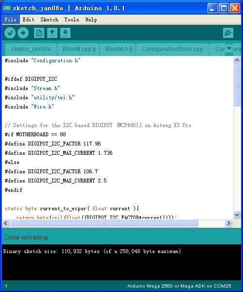

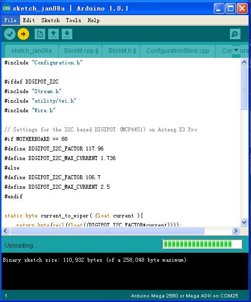

Load in the file you need to burn, Click the “check ()” button to check if it is right and then click the “->” button to upload
firmware, as shown below.
Upon uploading, the LED indicator corresponding to the TX, RX and L on the GT2560 will blink, if they stop blinking, it means the file has been uploaded successfully.
After uploading, you can go on to the next step. If you cannot upload, check the dialog box below to identify the problem and solve it. The common mistakes are the wrong select of type of board or serial port etc.
