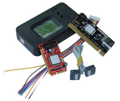

DEBUG KING (3-IN-1) is upgraded version of the Three –IN-One Notebook Debug card, and it is composed by two parts: DEBUG KING HOST and 3-IN-1 INTERPOSER.DEBUG KING HOST is powered by USB port, and using LCD to display English and photos. Also, it supports the debug code feature so that users can be easy to find the different debug code English description. The 3-IN-1 INTERPOSER supports note book MiniPCI and LPC bus interface. DEBUG KING HOST gets notebook debug code from 3-IN-1 INTERPOSER, and then shows the corresponding English or Photos information based on the debug code, and also gives their repair suggestion. With DEBUG KING (3-IN-1), Users don’t need to remember the meaning of every debug code, and DEBUG KING can show it to user directly, It is convenient for uses to fix their computer issues quickly.

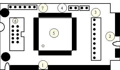

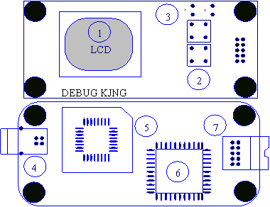

The Structure of DEBUG KING HOST
  1. Debug King LCD Screen to show English and Photos
  2. Debug King buttons to change the debug code or BIOS type
  3. Debug King LED Indicator to show the working mode
  4. Debug King USB port to be used to provide power
  5. Debug King EEPROM chip to save English and Photos data
  6. Debug King ASIC to deal with signals
  7. Debug King External Port to connect 3-in-1 Interposer

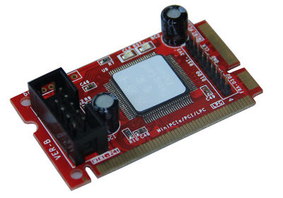

The Structure of 3-IN-1 INTERPOSER
  1. Mini-PCI interface to support notebook
  2. Mini-PCIe interface to support notebook
  3. LPC interface to support notebook
  4. LED indicators to show CLK and RESET signals
  5. ASIC to deal with Mini-PCI/Mini-PCIe/LPC signals
  6. Connector to connect this interposer to main-board
  7. Reserved for manufacture test only
The Mini PCI-E Interface in 3-IN-1 INTERPOSER
Mini-PCIe is used as a trend in the new notebook. Comparing to Mini-PCI, Mini-PCIe occupies less space. The 3-in-1 interposer uses below pins:PIN-8,PIN-10,PIN-12,PIN-14,PIN-16,PIN-17,and PIN-19, Those pins definition are optional in Mini-PCIe spec, and not all notebook vendors use those pin definition, so that not all notebooks can work with the Mini-PCIe interface.But our test shows more and more notebook manufacturers are beginning to use this, such as IBM, HP, Fujisu, Toshiba, Hasee, TCL, Acer and etc.. For the notebook, which don’t meet the above Mini-PCIe pin definition, this interface will not work and users need to use the other interface in this 3-in-1 interposer.
Note: Please be aware that Mini-PCIe is supported with limitation, and some notebooks will not work with interface
