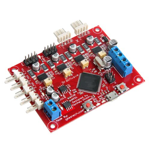

Brainwave, derived from sanguinololu, is control board for reprap 3D printer with low cost and high capacity-price ratio in that it is powerful to drive a printer of single-screw extruder by providing only the minimum required components. Such as a printer with single extruder and 2 Z axis or the delta style printer.
Features:
  • 12v power input
  • standard micro USB connector
  • The entire interfaces are at the edge of the board, making it possible to fit vertical or right-angle connectors.
  • Adopt Atmel AT90USB646 microcontroller, with USB- RS232.
  • The steps of stepper motor can be divided into 1, 2, 16, and 32. The maximum power output can reach to 800MA
  • 2 connectors for Z axis
  • Optional motor power output of each axis
  • Heated bed supports separate power input from the logic part (up to 24V 15A)
  • Integrated heater/thermistor/stepper connector for E channel
  • controllable fan

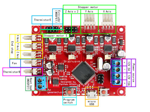

Interface specifications

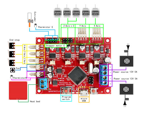

2 ADC interfaces for thermometry: one for extruder and another for hotbed.
3 PWM to control extruder, hotbed and fan.
3 end stops for x/y/z axis( mechanical)

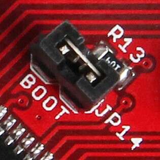

Boot jumper cap: do remember to put the jumper cap, or it will affect the connection with PC and the upload of firmware
