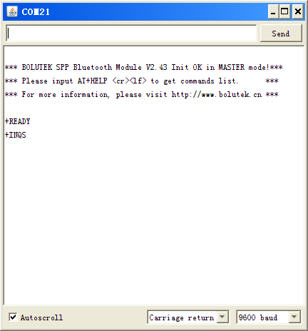

3.Open Serial Monitor and set the bluetooth .
You input command " AT+DEFAULT", then input " AT +BAUD8". As the Iduino DUE download baud is 115200,if you want to transmit data ,
you would set same baud for the software.Two bluetooths to do the same action.

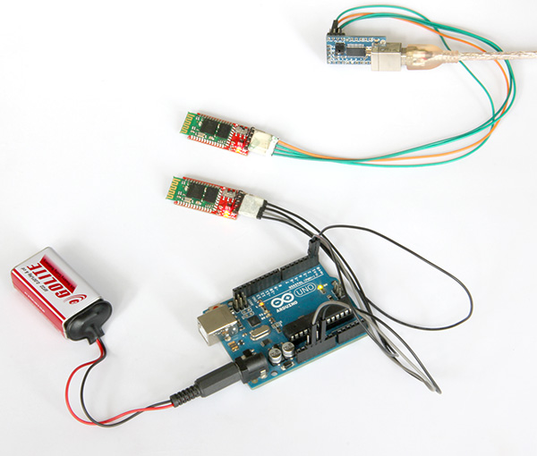

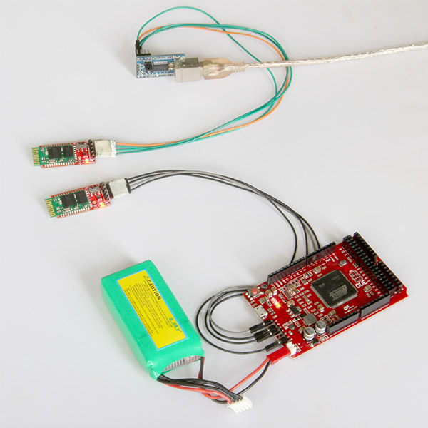

4.Follow step 2 to connect master bluetooth and the USB serial FT232RL , and connect slave bluetooth and Iduino DUE Pro like as:
GND------GND
VCC------3.3V
TX-------RX
RX-------TX
5.Power up for the Iduino DUE Pro from battery, programming would fail if you power up from USB port .
The green LED of buletooth is light that means two buletooths communicate , blink is connecting.
Press the ERASS button 2 seconds ,then press the reset button.
Now you can wirelessly program for Iduino DUE Pro.
Please open Aduino IDE 1.5 and selct Aduino DUE(programming port) in board.

We also wirelessly program and transmit data for other boards ,such as UNO,LilyPad,Arduino Pro Mini and so on. But you must set right baud for buletooth.Connect the board and slave bluetooth follow DUE Pro.
You can reference :
UNO, DUE , MEGA -------- 115200
ATMEGA328---------------- 57600
ATMEGA168---------------- 19200
DUEMILANOVE328 ---------- 57600
When you download to other boards,you must press the reset button until the TX LED of USB serial FT232RL blinks two times.However ,it is difficult to program for MEGA,bacause the TX LED blink irregularly.You can power up UNO ,MEGA from USB port.
