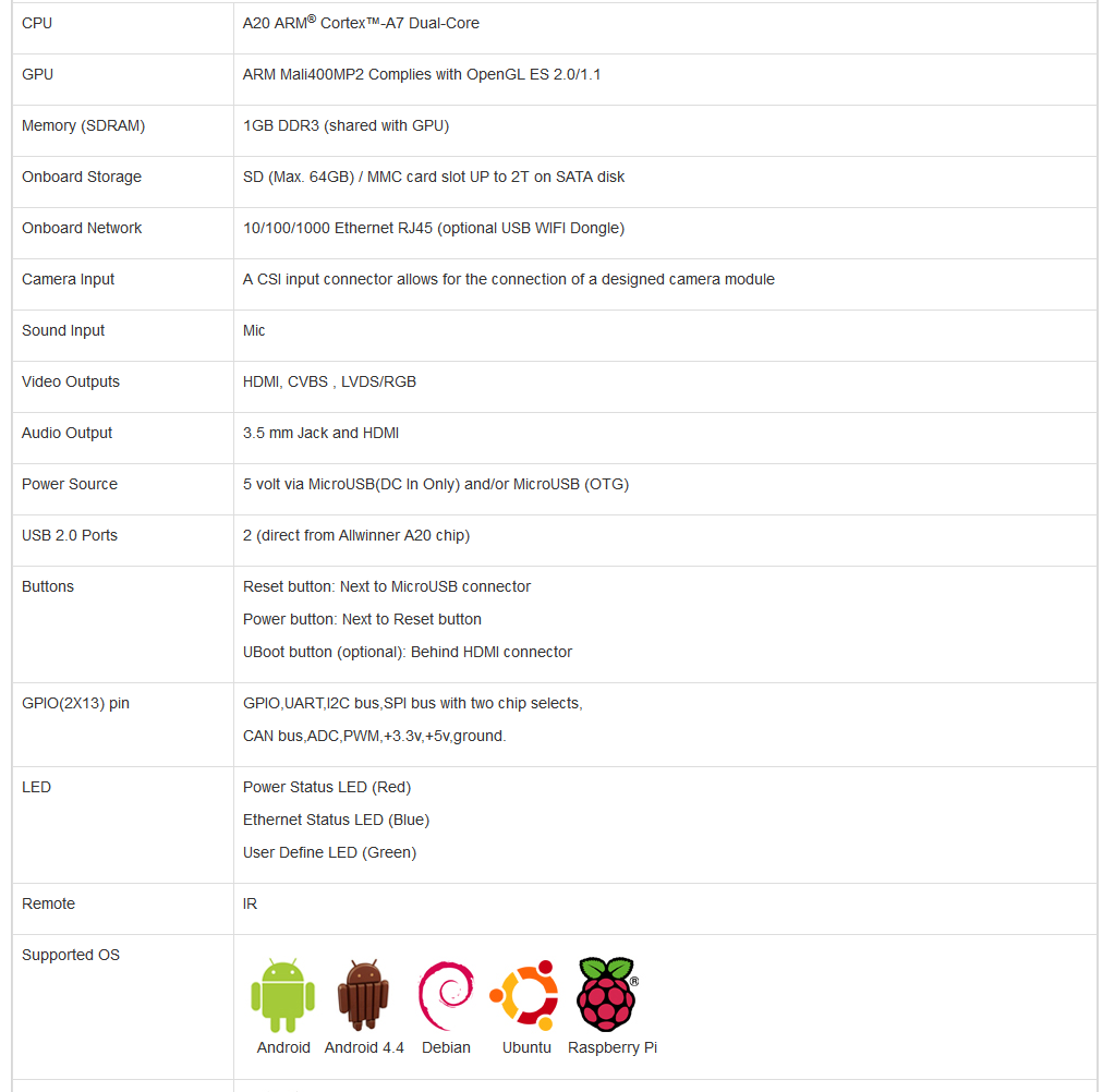

It’s an open-source single-board computer. It can run Android 4.4, Ubuntu, Debian, Rasberry Pi Image, as well as the Cubieboard Image. It uses the AllWinner A20 SoC, and has 1GB DDR3 SDRAM. Banana Pi is for anyone who wants to start creating with technology – not just consuming it. It's a simple, fun, useful tool that you can use to start taking control of the world around you.
Hardware specification

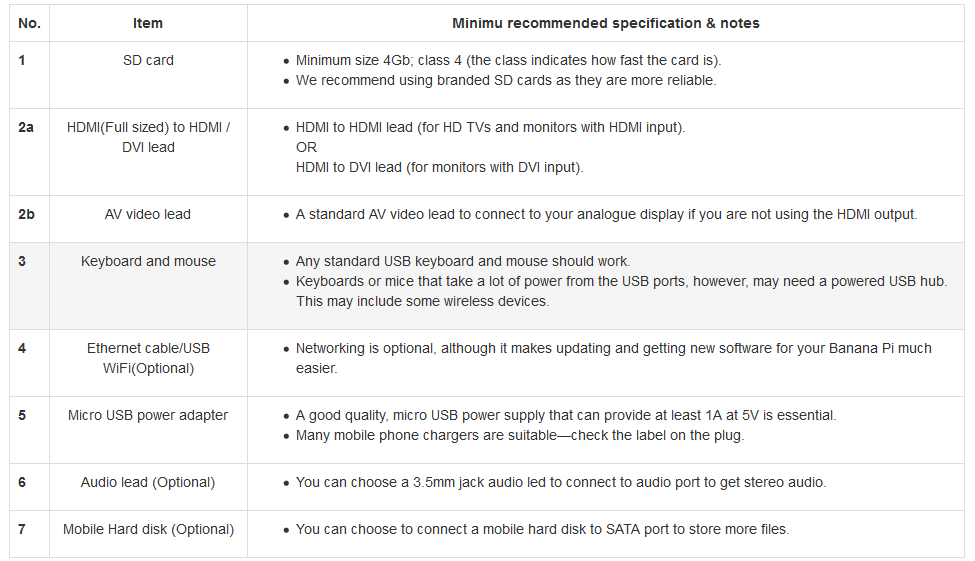

First time to enjoy your Banana Pi, you need at least the accessories in the table below.
HDMI to HDMI lead HDMI to DVI lead AV video lead
SD card Micro USB power adapter

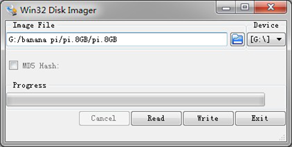

          i. Download a tool that can wirte image to SD card, such as Win32 Diskimager from:
             http://sourceforge.net/projects/win32diskimager/files/Archive/
          ii. Open the unzipped image file.
          iii.Click Write button. Wait patiently to successfully complete writing.

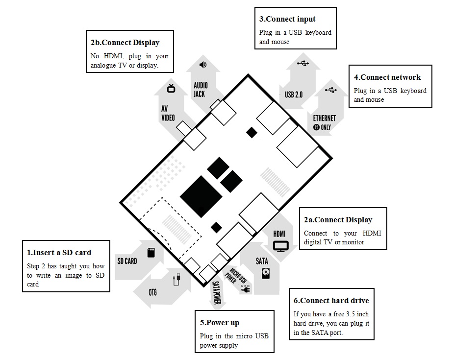

According to the set up diagram below, you can easily set up your Banana Pi.

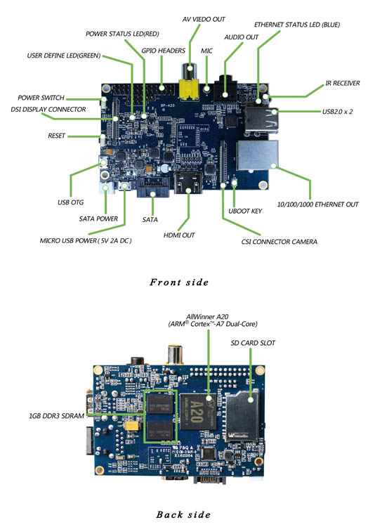

  1. Insert the written-image SD card that to the SD card spot on the left side edge of the underside of the board.
  2. On the bottom "edge" in the middle of the board is the HDMI Type A (Full sized) port, just on the right of the SATA port.
     Just connect  any HDMI cable from the board to your TV or HDMI Monitor.
If you don't have an TV/Monitor with a HDMI or DVI-D port you can use the yellow AV jack located in the middle of the "top" edge and the 3.5 mm stereo headphone jack to the right of it.
  3. Plug a USB keyboard and mouse into the USB slots located on the right edge.
  4. Just under the USB ports on the right edge is the ethernet connector for anyone who wants to plug the Banana Pi into a wired network.
  5. Finally, at the very left of the bottom edge is the micro-usb power connector.
    Plug in a regulated power supply that is rated at 5V ±5% and at least 1A.  Any number bigger than 1A (like 2A) will also work.
    Avoid using the smaller chargers used for small GSM phones, as these are often unregulated,
    even if they claim "5V 1A", they may do "5V" and may do "1A", but not at the same time!
The mini-USB (on the left) is the wrong one. It’s thicker and looks like a trapezoid with its sides pinched in. The micro-USB (on the right) is the correct one. It is thinner and also looks like a trapezoid except it’s sides are rounded outward.
   6. If you have a free 3.5 inch hard drive, you can put it into use on Banana Pi.
      Connect the SATA cable to the SATA port just between micro-USB and HDMI.
      Remember put the power cable with 2 male 2.54mm headers into the SATA power.
      Then you can plug your hard drive into the another side of the SATA cable.
      Be careful the connection of different color cables. (This step can be skipped)
