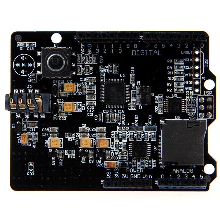

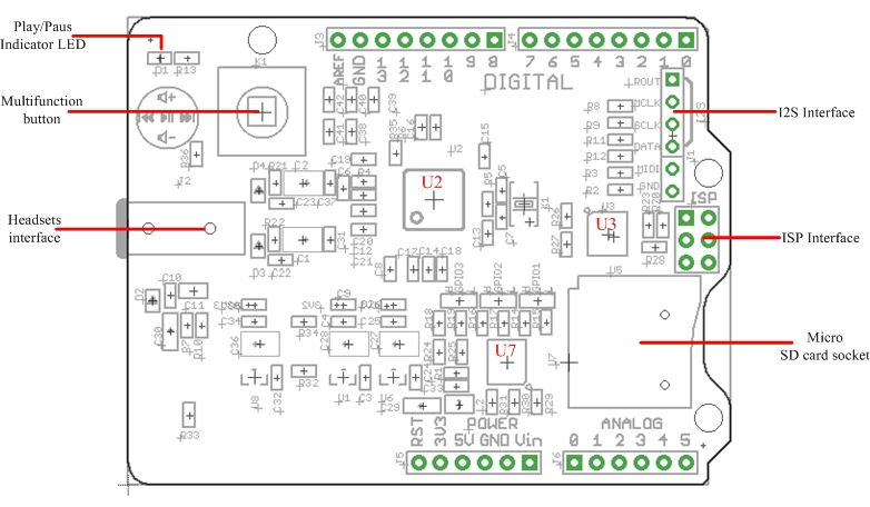

Specification
Multifunction button: Change volume and select songs
Play/Pause indicator LED (GREEN):Blinks while playing.
Headsets interface: It can drive 16 ohm or 32 ohm earphone and could serve as a external audio input port.
Micro SD card: can be FAT16 or FAT32, The maximum size SD card you can use is 2GB.
U2: VS1053B IC,Ogg Vorbis/MP3/AAC/WMA/FLAC/MIDI audio codec.
U3,U7: 74VHC125 IC, Quad Buffer.
I2S: for digital audio input/output.
ISP interface: for bringing SPI port when using with Mega series products.

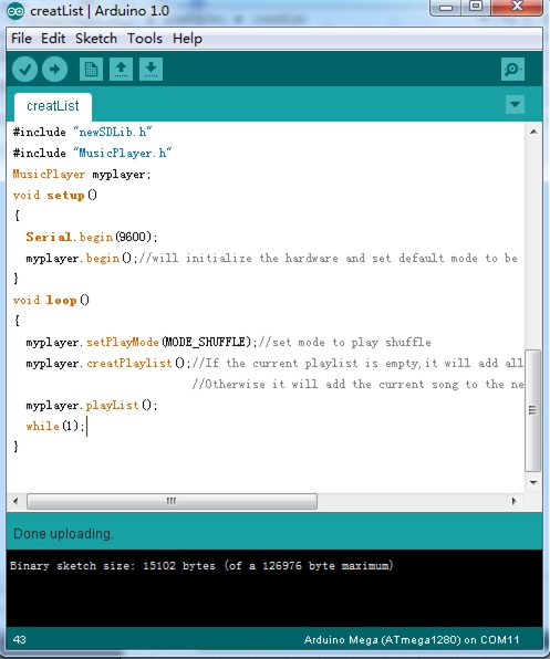

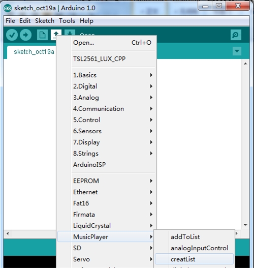

1. Restart the Arduino IDE. Open “creatList” example via the path: File --> Examples --> MusicPlayer --> creatList as below.
2. Set the play mode. In “creatList”, the function we use is described as follow.
   Name: setPlayMode(unsigned char playmode);
   Function: Set the play mode. There are four modes you can set: MODE_NORMAL、 MODE_SHUFFLE、 MODE_REPEAT_LIST、 MODE_REPEAT_ONE. Each mode stands for different playing orders.
3. Select the type of Arduino board that you are using by the path: Tools --> Board --> for example Arduino UNO.
4. Select the correct serial port you are using by the path: Tools --> Serial Port --> for example COM3.

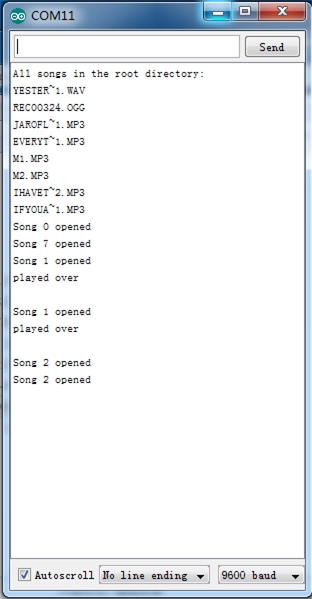

5. Upload the code. Click to Serial Monitor when “Done uploading” appears, you will find the order of songs is randomized on the list.
When press multifunction button to up or down, the volume will change. Of course, you can try others play modes.

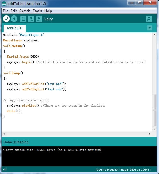

1. This demo will show you how to play part of the songs from all songs in the SD card. Open the “addToList” example via the path: File --> Examples --> MusicPlayer --> addToList.
2.Select songs from the playlist.You just need to list songs you want to play by name correctly in the function addToPlayList(char *songName) .
But you must ensure that the song has been stored in the SD card and the format of those songs must be one of MP3,WMA,WAV,AAC,MIDI,Ogg Vorbis.
3.Upload code. When you complete the upload,new add songs will be played.

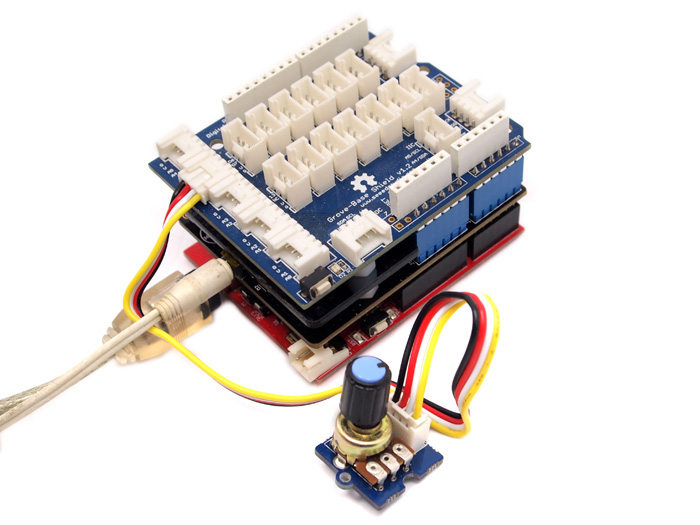

1.Plug the Grove-Base Shield onto the Music shield, Connect the Grove socket of the Rotary and anolog port 4 of the Base Shield with a Grove cable. You can change to
the digital port as well. But don't forget to change the port number in the definition of the demo code at the same time.
2. Open the “analogInputControl” example and upload it onto your Arduino Board.
3. Rotate the knob to change music volume.

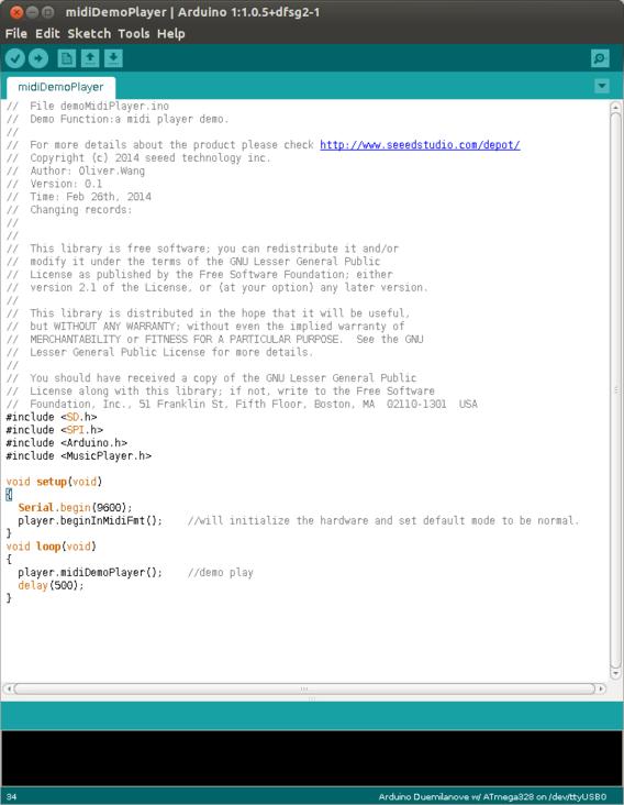

   A demo MIDI player was add to the latest library.
   MIDI Demo(upload the code. When completed, you will hear Fancy MIDI music):

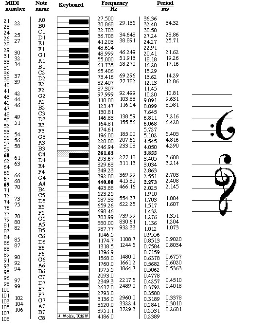

MIDI number to note reference list:
