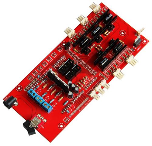

Overview
This is a board that's very similar to other Pololu-based electronics implementations, including RAMPS,but it can support up to 5 steppers (three for X, Y, Z,
one for an extruder and one for any other function). You can add as many stepper driver carriers as youneed. It is designed to run at higher voltages than
12 Volts, This allows you to put 90 Watts out of one MOSFET and run your stepper motors with more torque and higher maximum speeds. This board is also
used on the Mantis-30 milling machine from Protospace and on various Mendel's that people have built.
Note: When the jumper (closer the VR-tube 7812TV)is connected ,the power of Arduino MEGA Ultimaker Shield also will power up the Mega.
Features:
- Arduino Mega Shield
- Plug in all motors with simple 4-way JST connectors.
- Made for Ultimaker's UltiStepper Driver.
- Compatible with Pololu stepper driver boards.
- Controls up to 5 stepper motors (3 for the X, Y and Z axis one for an extruder (the "E axis"), optionally you can add another axis by adding a Pololu
stepper driver.
- Configurable step sizes by placing jumpers
- 3x 55 Amp MOSFETs outputs (with LED indicators. Actual current capability limited by PCB and connectors)
- All pins are broken out for maximum extensibility
- Runs from 15V to 19V.
- Three thermocouple inputs, or thermistor inputs. The 100K thermistor is recommended.
- Has a IDC header for adding an LCD panel (movie here)
- Has a header for adding an SD card module.
- A toggle-switch for powering up/down the board
- Easier to wire up thermocouples
- Includes a 12V regulator for an (always on) fan to cool the electronics.
- A PWM output with power for LED arrays and other lighting
- LCD backlight dimming can now be software controlled
- A serial I/O header for bluetooth and ethernet add-ons.
- Servo outputs for experimental setups. They need to be interrupt or software driven as the pins routed to the servo header I/O do not have PWM.

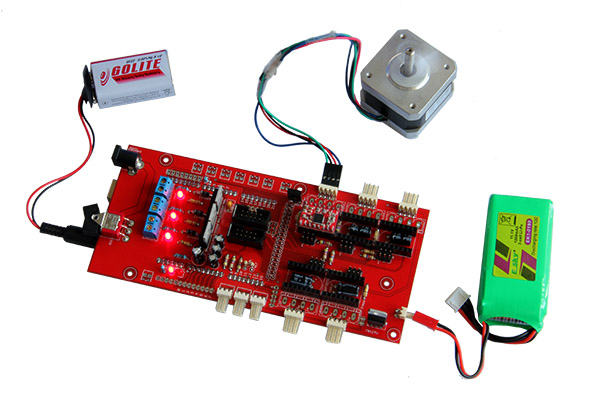

Test:
This is a simple test for your Arduino MEGA Ultimaker Shield ,motor ,Stepper driver and power.
Hardware needed
- Arduino MEGA Ultimaker Shield x1
- Mega 2560 x1
- Stepper Driver A4983 x1
- Stepping motor x1
- DC power of 15V to 19V
steps
1.Upload Test for Arduino MEGA Ultimaker Shield to your Mega.
2.Connect the Mege ,Arduino MEGA Ultimaker Shield,A4983,Stepping motor and power.
3.Test should be all ports of motors are running normally and lights flashing rule.

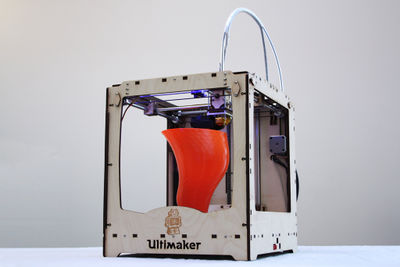

The Ultimaker board can use for many printer machines,such as Ultimaker
If you is a DIY user,you can follow the picture and the guide
