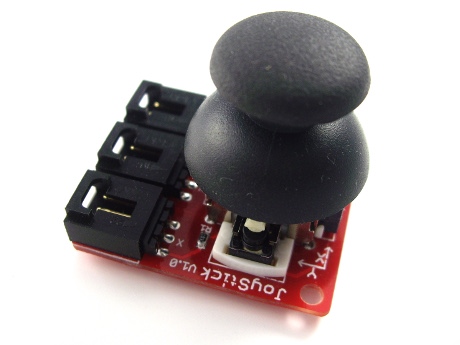

Just like a joystick on game console. you can control x, y and z dimensions input by this joystick module. It can be considered as combination of potentiometers and one button. Data type of the x, y dimensions are analog input signals and z dimension is digital input signal. thus the x and y ports connect to analog pins of Sensor Shield, while z port connects to digital pin.

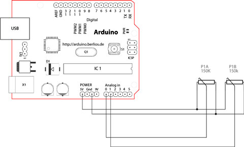

The joystick in the picture is nothing but two potentiometers that allow us to messure the movement of the stick in 2-D. Potentiometers are variable resistors and, in a way, they act as sensors providing us with a variable voltage depending on the rotation of the device around its shaft.

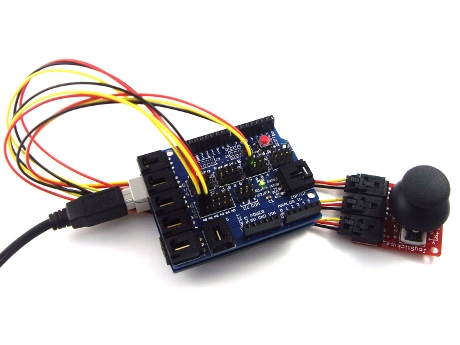

When using, it can connect with Arduino sensor shield,and connect Arduino corresponding pins through Arduino sensor cables. In the example below, the X axes and Y axes are respectively link to the analog input A1 and A0 ,and Z axis is connected to the digital I/O 7 pin:
