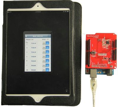

This shield is designed to work with Arduino boards, including Arduino Uno, Mega and Leonardo.
The shield supports connection between Arduino and iOS device including iPhone 5, iPhone 4S, iPad 3rd generation and iPod touch 5th generation.
You can control and receive status of Arduino pins with an iPhone easyly,pass all sensors data from your Arduino to an iOS App for processing,

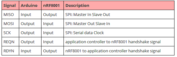

  • The ACI enables an application controller to communicate with nRF8001.
  • The physical ACI interface on nRF8001 consists of five pins. All ACI data exchanges use a standard SPI interface, with nRF8001 using a mode 0 slave interface to the application controller.
  • However, nRF8001 does not behave as a pure SPI slave device; nRF8001 can receive new data over-the- air at any time or be busy processing a connection event or new data. *Consequently, the traditional CSN signal used to initiate an SPI transaction is replaced by two active low hand-shake signals; RDYN and REQN.

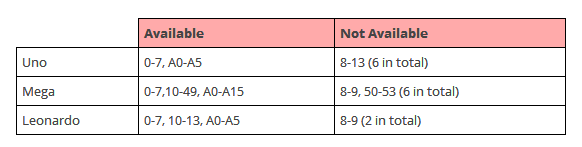

Since we have to enable SPI interface for ACI communication, some I/O pins will not be available for other usage. On Arduino Uno, the SPI bus uses pins 10 (SS), 11 (MOSI), 12 (MISO), and 13 (SCK). On the Arduino Mega, they are 50 (MISO), 51 (MOSI), 52 (SCK), and 53 (SS). For Leonardo, the SPI pins are not connected to any of the digital I/O pins as they are on the Uno and Mega, they are only available on the ICSP connector. Our BLE Shield is designed to utilize the SPI pins on the ICSP Header, therefore it is compatible with all three Arduino models.
Moreover Nordic’s ACI requires two hand-shake signals, RDYN and REQN, two additional pins will be used (pins 8 & 9 in the current implementation).

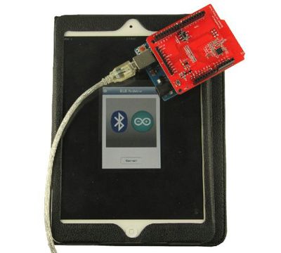

steps 1. Upload BLEFirmata (include in the Examples of Arduino IDE)to your Arduino UNO .
2.Open Bluetooth Software from your iPad or iPhone and keep the key of Bluetooth Low Energy (BLE) Shield is on.
3.Connect BLE.

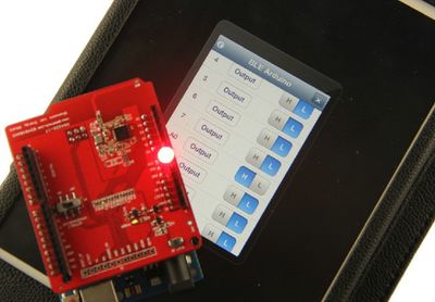

4.OK! Now ,first a LED pug in A0 and GND of BLE ,of coures ,it is better to add a limit current resistance ,click A0's 'H' from iPad,you will see the LED is light.

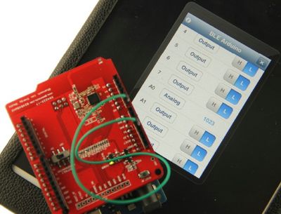

Next,connect A0 and ACC+5V on BLE ,open A0's ' analog ' state from iPad ,you will see the max input analog value:1023.
