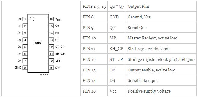

The datasheet refers to the 74HC595 as an "8-bit serial-in, serial or parallel-out shift register with output latches; 3-state." In other words, you can use it to control 8 outputs at a time while only taking up a few pins on your micro-controller. You can link multiple registers together to extend your output even more.
In brief, If we use our Arduino to send a decimal number(0-255) out through a digital pin to the 74hc595, it will convert it to binary and set the matching output pins high or low. In this method, we can send a specific decimal number to light up LED parts for constituting a whole number.
Pins Q0~Q7 are the output pins that we want to control. The Q7' pin is serial out. 74hc595 pin 14 is the data pin, 12 is the latch pin and 11 is the clock pin. The data pin connects to a digital output pin on the Arduino. The latch pin is like a switch, when it is low the 74hc595 will accept data, when it is high, the 74hc595 goes deaf. The clock pin is toggled once the data has been received. So the procedure to get the data into a 74hc595 is this:
1) set the latch pin low (pin 12) 2) send the byte of data to the 74595 (pin 14) 3) toggle the clock pin (pin 11) 4) set the latch pin high (pin 12)
Pin 10 (reset) is always connected to the +5V, pin 13 (output enable) is always connected to ground. Thankfully there is a command that has parts 2 and 3 in one; you can use digitalWrite(); to take care of the latch duties. The command shiftOut(); is the key. The syntax is:

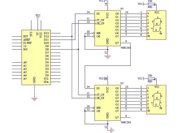

Because the lack of single 7 segment LED, I have to take a 4-digit 7segment at hand instead, just light up one digit of four. The principle of them is almost same in general. Since not all the 7 segment LED is same, so we must work out which pin for which segment using multimeter. Then find out appropriate binary number to represent the high or low level to these pins and convert it to decimal number sending to 74hc595.Schematic wiring diagram is below.
