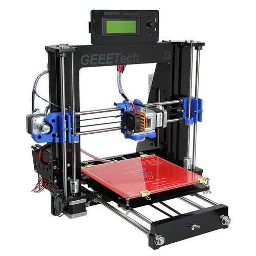

This acrylic frame Prusa Mendel I3 3D printer is designed and manufactured by Shenzhen Getech Co., Ltd based on Reprap pursa I3, Geeetech I3 features simple assembly, easy debugging and more stable performance. The acrylic structure makes the printer less complex and easy to operate.As you can see from the above pictures, we provide two Acrylic I3, black one and tranparant one.
Main improvements and features
1.Further simplified structure means fast assembly and easy adjustment, which saves you both time and energy as well as speeds up the molding of your innovative products and ideas. It usually takes up to 3 days for a DIYer to assemble the previous I3, not to mention the post-adjustment and debugging work. As to this I3 of Acrylic Frame, however, you can save 70% of time.
2.Enhanced stability and reliability. Geeetech I3 adopts 8 mm-thick acyclic plates, also you can choose the piano-black one and the transparent one, and both colors look good.
3.The PSU (power supply unit) is assembled together with the printer; which saves you a lot of space and can avoid unnecessary electrical trouble.
4.All the cables and wires are well arranged to make it more neat and easy to operate.
5.MK8 extruder ensures smaller layers and higher resolution, make models and objects.
