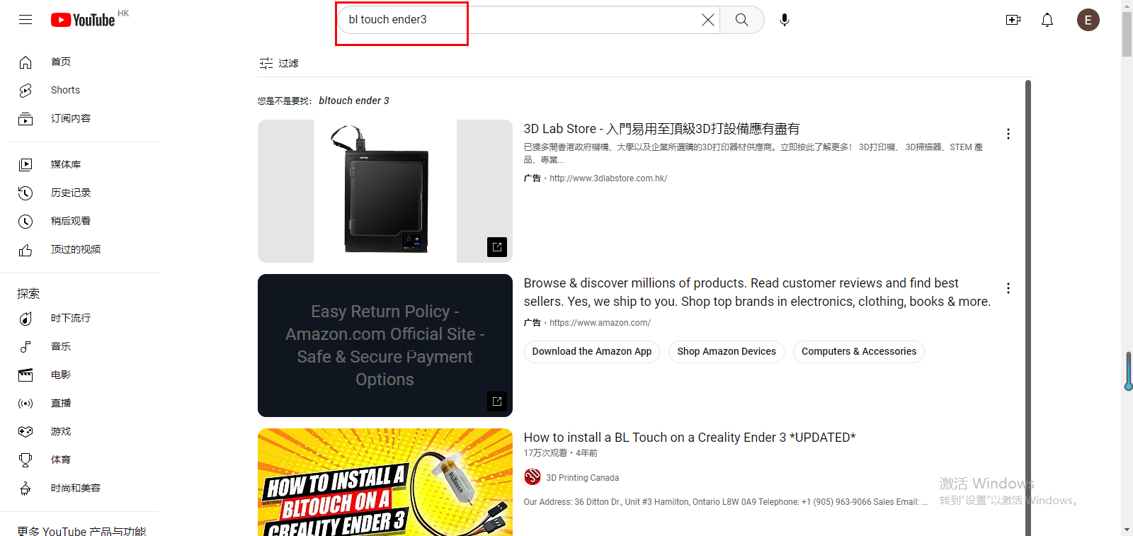

1.3D TOUCH is a standard feature, and if you want to know if 3D TOUCH is compatible with your machine, you'll need to ask your machine's technical support. If they don't know the wiring information, you can search for BL TOUCH plus your machine on youtube, as shown below in the example of ender3. https://www.youtube.com/results?search_query=bl+touch+ender3

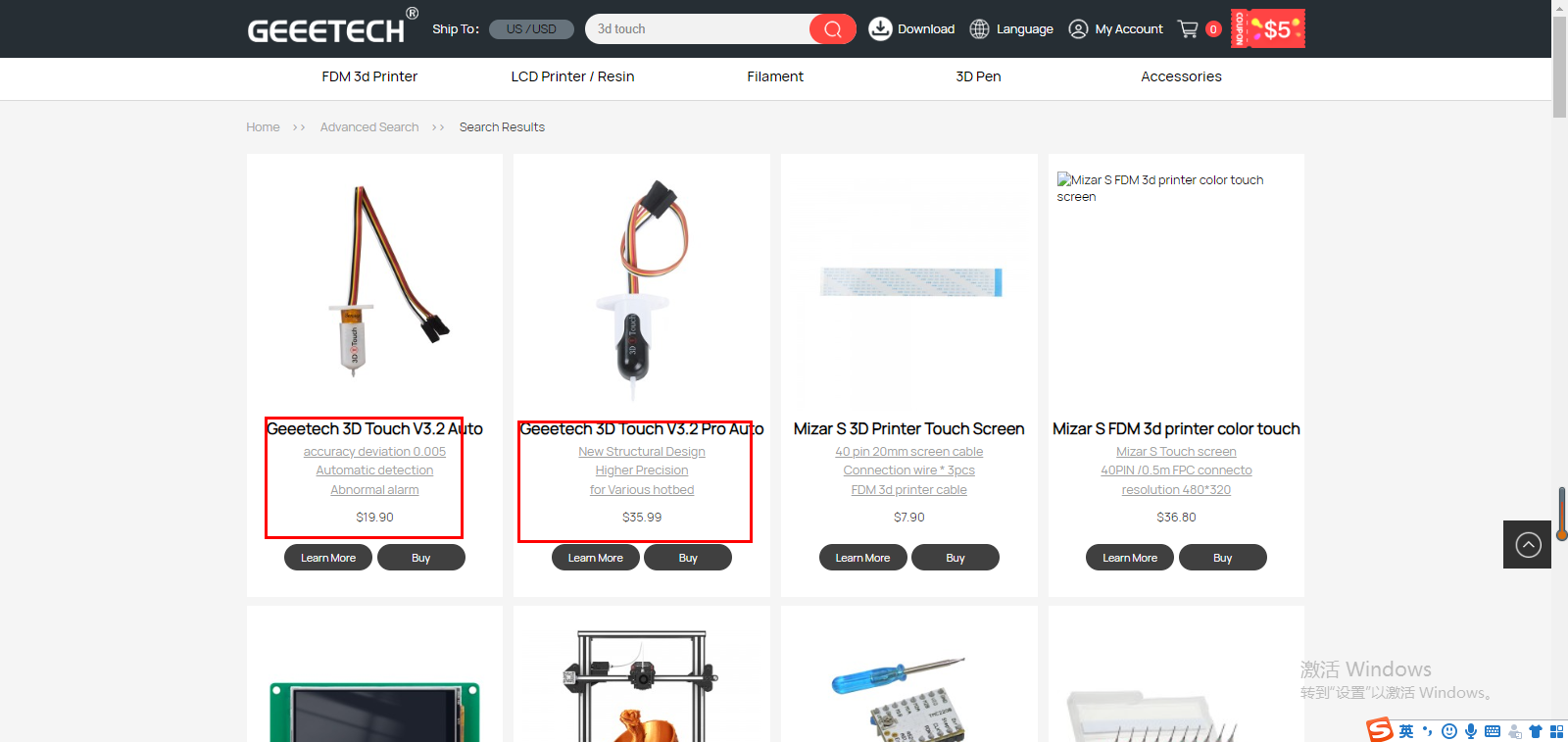

1.Check whether the assembly parts of 3D TOUCH are complete. https://www.geeetech.com/index.php?main_page=advanced_search_result&search_section=products&search_in_description=0&keyword=3d+touch&submit=

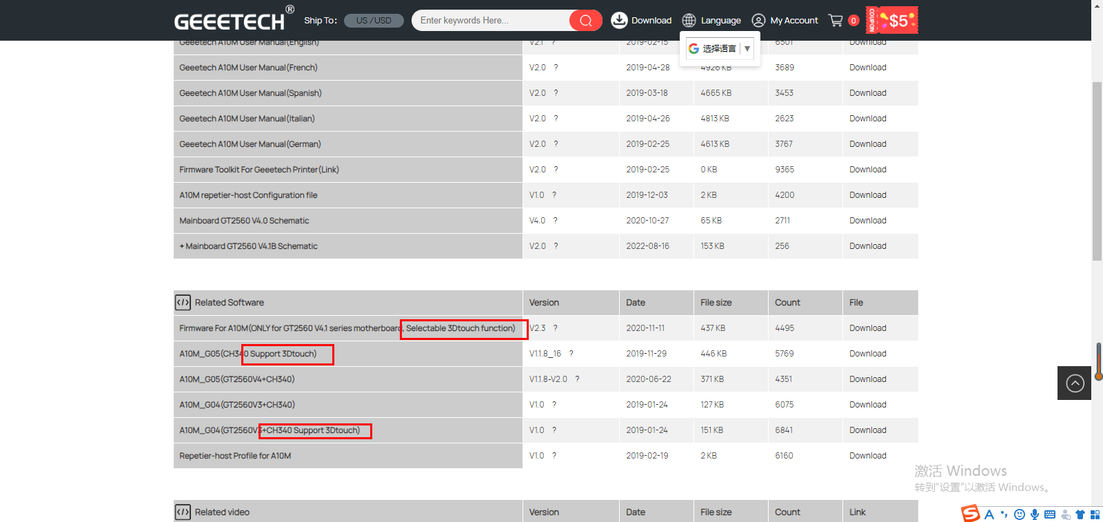

3.Please click the link below to download the firmware with 3D TOUCH and refresh it.https://www.geeetech.com/download.html

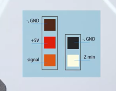

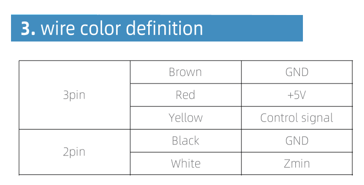

1. The 3DTouch line sequence diagram is as follows. After installation, confirm whether the LED light is on and whether the 3Dtouch can be extended/retracted normally.

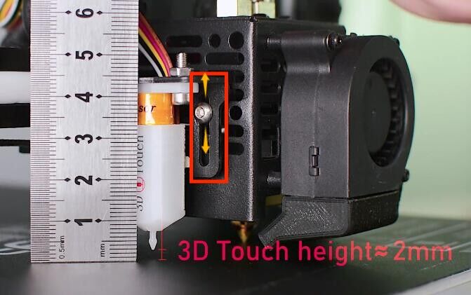

2. Installation height problem: The nozzle presses the hot bed or the leveling failure is caused by the incorrect installation height of the 3Dtouch. The 3Dtouch installation height or adjustment height standard is: the 3dtouch probe is 2mm higher than the nozzle position when retracted.
Please refer to the following video https://www.youtube.com/watch?v=YmXwFmB4qys
