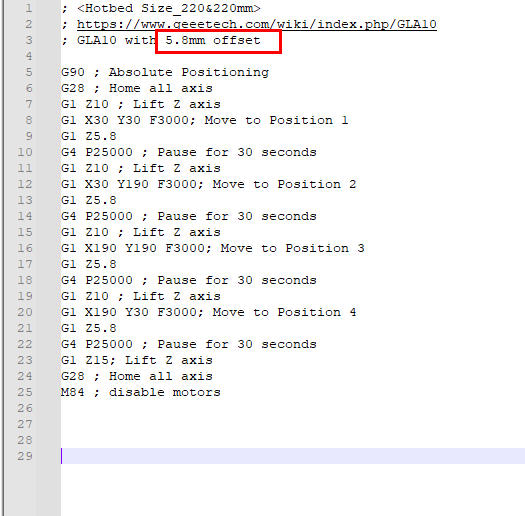

1. If the above hot bed size is not your hot bed size, you need to modify the code according to your hot bed. The following is a specific tutorial.https://www.geeetech.com/download.html?download_id=61
2.If you feel that the nozzle scratches the plate, you can measure the data below and then change the data in the red box to increase the value of offset.

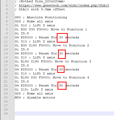

3.If you feel that the nozzle leveling time at each point is too long or too short, you can modify the data below to change the time you want. Please note that if the residence time is too short, it may cause the nozzle to move to the next point before leveling is completed. Modify the data with caution.
