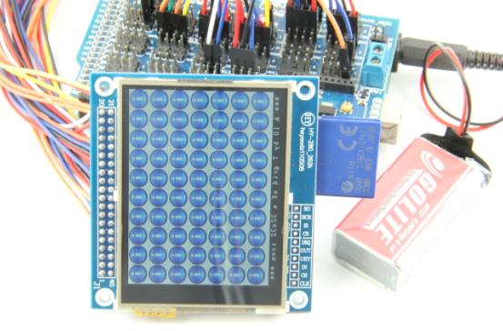

HY-TFT280 is a 2.8 inch TFT LCD Screen module, 320*240 (resolution), 65K color, 40pins interface , not just a LCD breakout, but include the Touch screen, SD card. So it’s a powerful extension module for your project.
This Screen includes a controller ILI9331, it’s 16bit data interface, easy to drive by many MCU like STM32 ,AVR and 8051.HY-TFT280 is designed with a touch controller in it . The touch IC is XPT2046 , and touch interface is included in the 40 pins breakout. Another useful extension in this module is the SD Card socket . It use the SPI mode to operate the SD card, the SPI interface include in the 40pins breakout.

The TFT library is required to be installed to get this screen model display. This library is especially designed for TFT LCD screen using 16 bit mode. The library require the following connections.
  • Connect HY-TFT280 to Arduino Mega2560:
LEDA -> 5V
LEDK -> GND
VCC -> 5V
RD -> 3.3V
GND -> GND
DB0->DB7 to pin D37->D30
DB8->DB15 to pin D22->D29
RS -> D38
WR -> D39
CS(pin6) -> D40
RSET-> D41
  • Connect HY-TFT280 to Arduino UNO
LEDA -> 5V
LEDK -> GND
VCC -> 5V
RD -> 3.3V
GND -> GND
DB0->DB5 to D8->D13
DB6->A0
DB7->A1
DB8->DB15 to D0->D7
RSET->A2
CS->A3
WR->A4
RS->A5
Note: The TFT controller model needs to be declared in the initializing statement. ITDB02 myGLCD(38,39,40,41) needs to be modified as myGLCD(38,39,40,41, TFT01_24) when using Arduino Mega2560.ITDB02 myGLCD(19,18,17,16, TFT01_24) needs to be commented when using Aduino UNO. Otherwise it just show a blank screen. In practice, RS, WR, CS, RSET can be connected to any free pin. But the pin number must be in accord with myGLCD(RS,WR,CS,RST).
