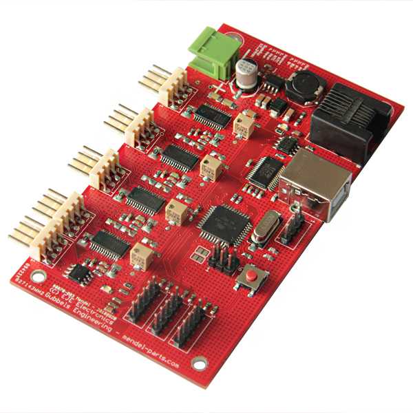

Generation 6, or Gen6, can be described as a dedicated, Plug-&-Play, single board solution for FFF/FDM 3D Printers. It is designed to be professionally manufactured, with many small surface mount components, as opposed to Generation 7 which is designed to be printed on a Mendel(among other design goals).
Another major difference with other Gen6 electronics is that they use Texas Instruments DRV8811 chips to drive the stepper motors. This means they require firmware modifications from the normal Polulu-based electronics which use Allegro A4983 chips.
Nomenclature
"Generation 6" was chosen because it was the next name on the list, after Gen3, Gen4, Gen5... Generation 7 should, hopefully*, be the last use of this naming convention . If you prefer, you can call this the Mendel-parts.com electronics, or Mendel-parts Gen6, etc. Gen6 is printed on the PCB, so we are stuck with it.
*it is a wiki, after all, so keep your fingers crossed.
Benefits of this Design
  • These electronics are a single board solution, so you don't need all those cables and one thick sheet and 4 reprap parts less.
the bottom thick sheet (big one) doesnt add much rigidity, the front one is used for stiffness of the frame, not the bottom one.
  • It has a standard USB connection (USB A>B cable needed)
  • It uses micro-stepping (1/8) for quieter operation.
  • It is cheaper than for example Makerbot's version of the RepRap Generation 3 electronics.
  • It uses small standard Molex connectors for motors, heater, and optos.
  • The pcb of the optos are integrated, so you only need the optos on cables with 5way Molex connectors
Hardware Features
  • on-board USB-RS232 convertor
  • Integrated hardware for driving one extruder (stepper, heater and thermistor)
  • RS485 bus connector with the possibility to link through the extruder step and dir signals
  • Integrated hardware for driving H21LOB or TCST2103 slotted optosensors
  • High input voltage range: 12-24Vdc
  • Use of standard connectors with easy and clean installation
  • Debug LEDs for power, communication and heater output
  • Reset button
Specifications
  • Dimensions 110x60mm
  • Mounting grid: 100x50mm (4x M3)
  • Input voltage 12-24Vdc
  • On-board controller: ATmega 644p (Atmel Corp.)
  • RS485 connector: RJ45
  • Heat output: MOSFET output, 4A
  • Thermistors input: 100K thermistor
