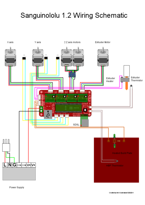

Features
  • Small design - board is 100mm x 50mm (4" x 2") - barely an inch longer than a business card!
  • Sanguino clone, Atmel's ATmega644P - ATmega1284 drop-in compatible!!
  • Up to 4 Pololu stepper driver boards (or Pololu compatible) on-board (X,Y,Z,Extruder) (without voltage regulator)
  • Supports multiple power configurations
-- Logic & Motors supplied by ATX power supply (needs molex harddrive connector, and optional 4pin atx connector for additional 12v/supply voltage)
-- Motors supplied by 5mm screw terminal 7-35V
-- Logic supplied by USB bus
-- Logic supplied by optional on-board voltage regulator (molex harddrive connector cannot be installed at the same time)
Supports multiple communication configurations
-- FT232RL on-board for USB connectivity
-- USB2TTL header is available for FTDI cable, or BlueSMIRF bluetooth module
  • 2 thermistor connectors with circuitry
  • 2 N-MOSFETs for extruder/bed, or whatever
  • Selectable 12v(or supply voltage)/5v endstop voltage
  • Edge connectors enabling right-angle connections
  • Silkscreen for connectors on both sides of the board, facilitating bottom cable connections
  • 13 Extra pins available for expansion and development - 6 analog and 8 digital, with the following capabilities
-- UART1 (RX and TX)
-- I2C (SDA and SCL)
-- SPI (MOSI, MISO, SCK)
-- PWM pin (1)
-- Analog I/O (5)
  • All through-hole components (except FTDI chip) for easy DIY soldering
