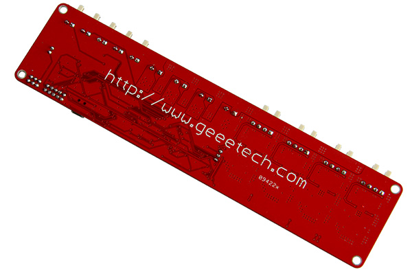

A compact all-in-one controller board for RepRaps with one extruder head, optimized for mass production. The point of RepRap is to make itself, of course. But sometimes people just want plug-and-play RepRap electronics so they can concentrate on the other aspects of the machine, or just because they are more software or mechanics oriented than electronics oriented. Melzi is designed to be a complete set of RepRap electronics that should be very cheap to mass produce. It is based on the Arduino Leonardo (Francesco Melzi was Leonardo's pupil).
Melzi Ardentissimo
The Melzi Ardentissimo is a full-featured Melzi board using the ATMEGA644P (ATMEGA1284P is being tested) chip used on Sanguinololu. This is a Sanguinololu firmware compatible board, though does have a couple of extra features the Sanguinololu does not - namely the extra Mosfet for the fan, and a software controllable LED. Melzi has micro SD on board as well. A full StepStick clone is on board as well negating the need for external stepper motor drivers.
