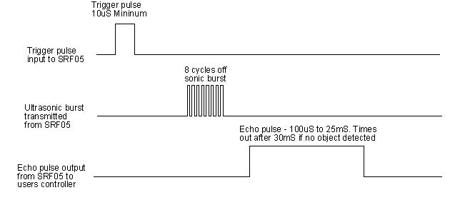

Working principal
1.Adopt IO trigger through supplying at least 10us sequence of high level signal. 2.The module automatically send eight 40khz square wave and automatically detect whether receive the returning pulse signal. 3.If there is signals returning, through outputting high level and the time of high level continuing is the time of that from the ultrasonic transmitting to receiving. Test distance = (high level time * sound velocity (340M/S) / 2.

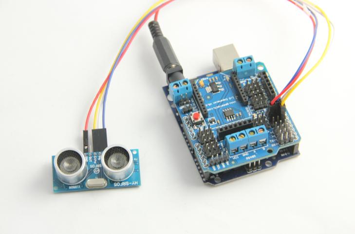

Example code
      int inputPin=4;  // define ultrasonic signal receiver pin  ECHO to D4
      int outputPin=5; // define ultrasonic signal transmitter pin  TRIG to D5
      void setup()
        Serial.begin(9600);
        pinMode(inputPin, INPUT);
        pinMode(outputPin, OUTPUT);
     void loop()
        digitalWrite(outputPin, LOW);
        delayMicroseconds(2);
        digitalWrite(outputPin, HIGH); // Pulse for 10μs to trigger ultrasonic detection
        delayMicroseconds(10);
        int distance = pulseIn(inputPin, HIGH);  // Read receiver pulse time
        distance= distance/58;   // Transform pulse time to distance
        Serial.println(distance);   //Ourput distance
        delay(50);
