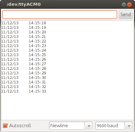

Here is the guide illustrates how to connect an Arduino to the DS3234 Real-Time Clock Module. The following is a table describing which pins on the Arduino should be connected to the pins on the DS3234 module:
After uploading the sketch, in the serial monitor of the Arduino IDE, we can read the real time.
