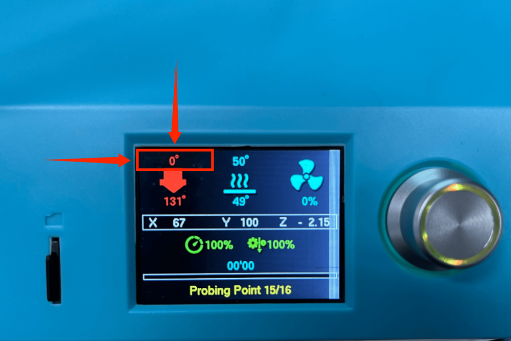

=== '''The preset temperature jumps back and forth during automatic leveling'''===
这是正常的现象
这是正常的现象
[[File:M1_autoLevel_0.png|400px|thumb|left]]
[[File:M1_autoLevel_0.png|1000px]]
[[File:M1_autoLevel_0.png|100px|thumb|left]]
[[File:M1_autoLevel_0.png|60px]]
这是正常的现象
