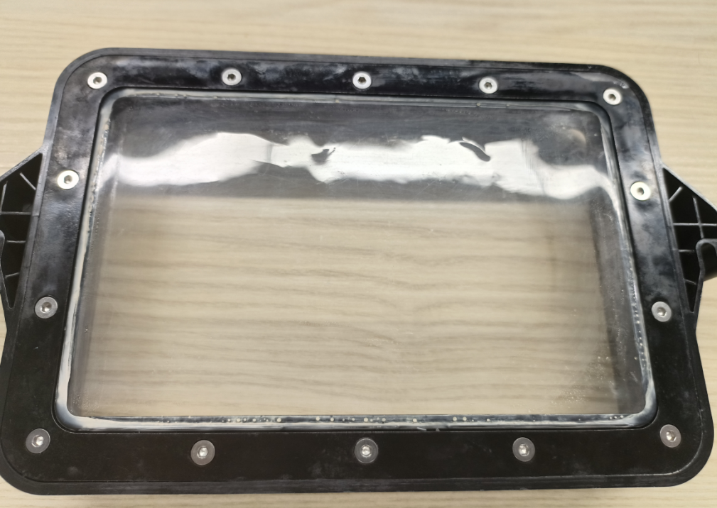

How to replace FEP film
First please prepare a sheet of FEP film, which can be purchased from the link below.
FEP film
Unscrew the screws in the picture below. Install the new FEP film, take care not to exhaust the screws when screwing, just make sure to screw well. Because too much force will cause damage to the pressure plate fixing FEP film, as shown in the figure below.
