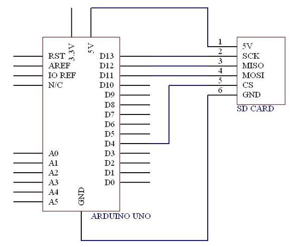

==Connection Diagram==
[[File:SD card wiring.jpg]]
[[File:SD card wiring.jpg|600px]]

Connection Diagram
