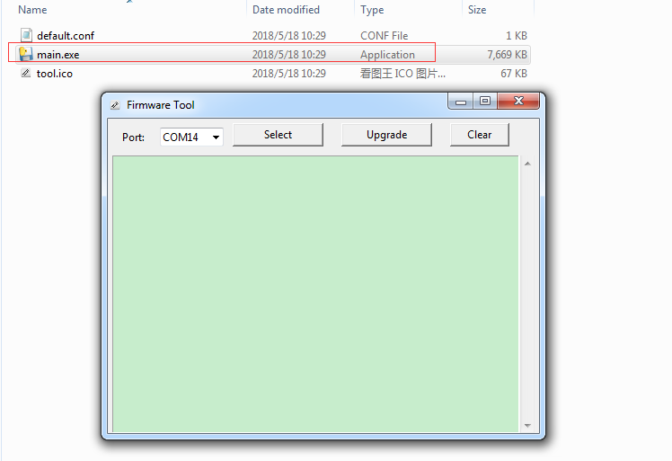

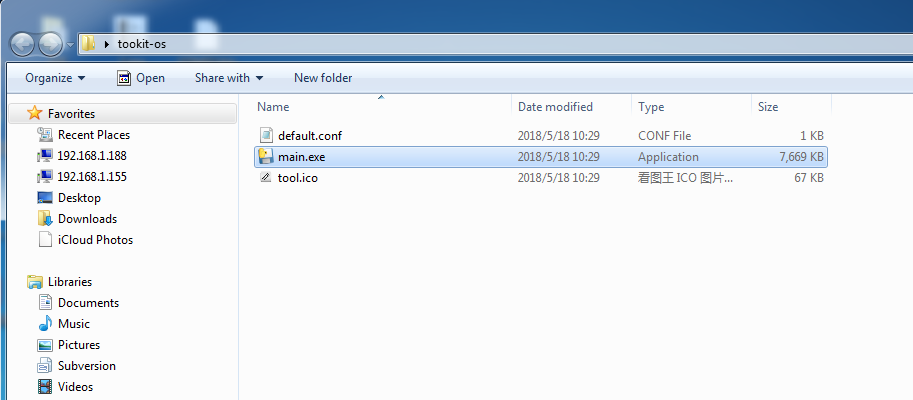

1. Download “toolkit-os” and upzip the file. Here is the link [File:Toolkit-os.rar Toolkit-os]
2. Connect your 3D printer with a computer. Double click “main.exe” to start upgrading the firmware for GTM32 control board. A window will pop up, showing the COM port for your 3D printer.

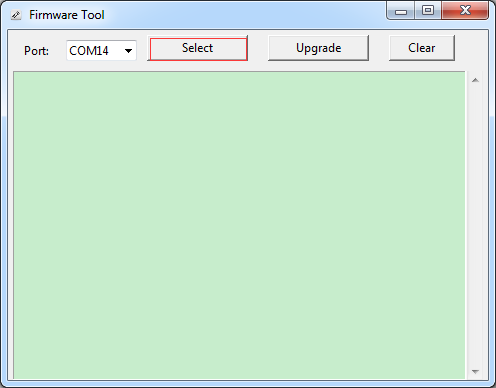

3. Click “Select” to choose the new firmware you’ve written, for instance, “GTM32.bin”.

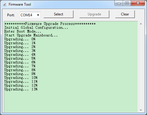

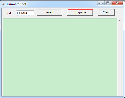

4. Click “Upgrade” and the upgrading will start automatically.

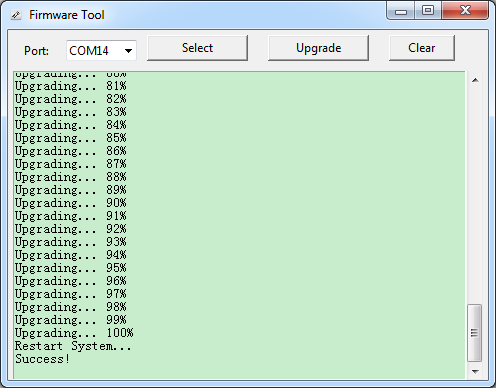

5. When the firmware is upgrade successfully, you will see the following window. Close the window to finish the whole process.
