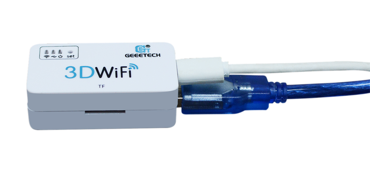

Step 1. Connect your 3D printer to the USB port of 3D WiFi Module with your USB cable for data transmission. Use the power cable to connect 3D WiFi Module with your adapter to power it up. | Step 1. Connect your 3D printer to the USB port of 3D WiFi Module with your USB cable for data transmission. Use the power cable to connect 3D WiFi Module with your adapter to power it up. | ||

Step 2. Please check if the three indicator lights are on: Wi-Fi, USB, Power source from left to right orderly. Insert the TF card into the slot. | Step 2. Please check if the three indicator lights are on: Wi-Fi, USB, Power source from left to right orderly. Insert the TF card into the slot. | ||
Step 3. Long press the hole labeled with “set”with a pin, until the Wi-Fi light turns dim and flickers quickly. Loosen the pin and 3D Wi-Fi will enter the config mode.
