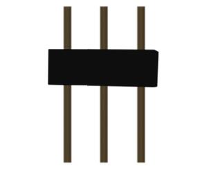

let's take our geeetech GT2560 3D Printer control board as an example.
There are several ways to connect the 3DTouch Auto Leveling sensor to GT2560, here is the easiest way.
step 1. Remove the Z max connector from the board and replace it with a 3Pin Straight Pin.You need to use soldering iron here.
For example:
