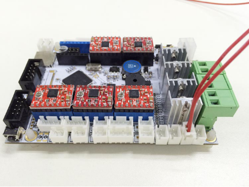

Black: - | Black: - | ||
1)Connect fan for control board at | 1)Connect fan for control board at FAN3. | ||
[[File:27.GTM32 20.jpg|500px]] | [[File:27.GTM32 20.jpg|500px]] | ||
2)Connect fan for extruder 0 at | 2)Connect fan for extruder 0 at FAN0. | ||
[[File:27.GTM32 21.jpg|500px]] | [[File:27.GTM32 21.jpg|500px]] | ||
| Line 1,117: | Line 1,117: | ||
[[File:27.GTM32 22.jpg|500px]] | [[File:27.GTM32 22.jpg|500px]] | ||
4)Connect fan for hotend at | 4)Connect fan for hotend at FAN4. | ||
Note: for the fan of hotend, you will need the extension wire. Just connect the red and black connectors. | Note: for the fan of hotend, you will need the extension wire. Just connect the red and black connectors. | ||

Here is the detailed wiring of GTM32 control board

Step5. Connect wires for Fan
Note the “+” and “-“ polarity for fan
Red: +
Black: -
3)Connect fan for extruder 1, connect the other to FAN1.
