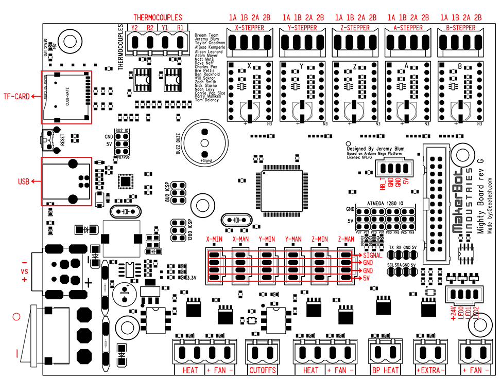

Interfaces
Interface Layout
Note: The display and extended interface of MightyBoard only support MightyBoard LCD2004 control panel. If you want to use other equipments, you should develop the corresponding program.
Development Environment setting
Signal polarity scheme of interfaces
