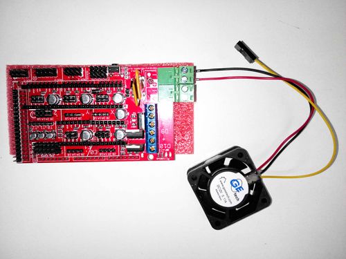

==mount the fan for extruder== | |||
{|class="wikitable" | |||
!Required parts!!Required number!!Part ID | |||
|<center>fan</center>||<center>1</center>||<center>NO.70</center> | |||
|<center>M3 x30 screw</center>||<center>2</center>||<center>NO.28</center> | |||
|<center>M3 washer</center>||<center>2</center>||<center>NO.7</center> | |||
[[File:Mount fan.jpg|500px]] | |||

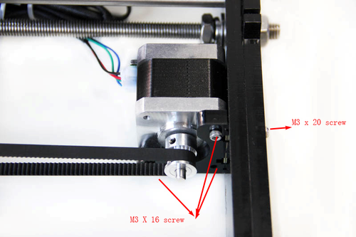

Mount the Y motor
| Required parts | Required number | Part ID |
Step1. Mount the pulley on the motor shaft, one of the screws should be screwed on the cross section of the shaft. Do not screw too tight to turn smoothly.
Step2. Insert the motor block into the slot; you may need to use a little strength to do this. But be careful in case the Acrylic broke down. Then screw the motor on the block plate with 3 M3 x 12 screws and fix the block plate with 2 M3 x 16 screws and M3 square nut.

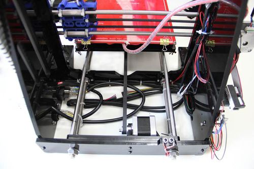

Assemble Y - Z axis
Step1. Held upright the main frame is after the acrylic fender washers on the threaded rods. Here you can use the A2 panel as a reference to measure the distance A1 and A12 (the rear plate).
Step2. Screw up the main frame to the acrylic fender with M3 x 20 screws.
Step3. Screw up the M10 screw on the threaded rod of Y-axis. You can see the finished picture.

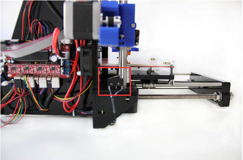

Mount the end stops
Note: there is no “+” and “-” for endstops, so there is no difference for the wires.
Step 1.End stop of X-axis
Step2. End stop of Y-axis
Step3. End stop of Z-axis

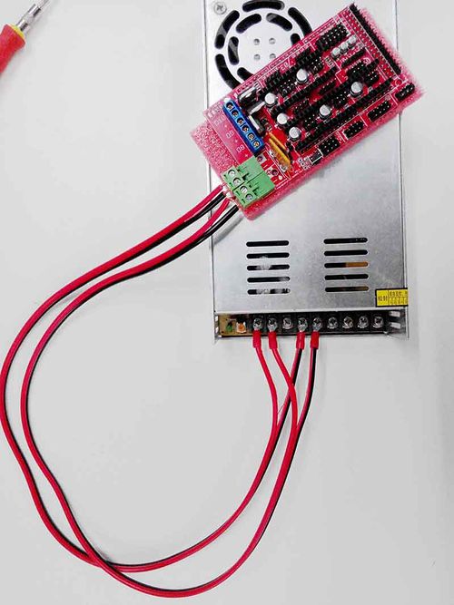

Mount the PSU
Step1. Mount the PSU (Power supply unit) on the right side panel with 3 M3 x 10 screws.
Step2. Mount the AC socket with M3 x 16 screws.

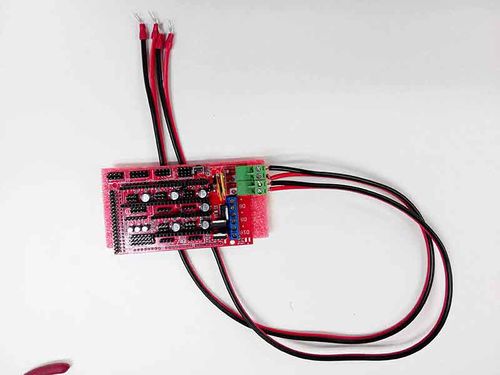

First you have to take off one end of the connectors to get both the power button and the power socket into the hole.

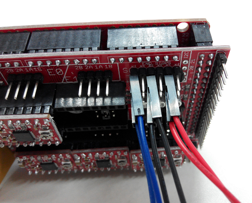

*(The connection of wire in this picture is very important; you should pay close attention in case the PSU suffer a shortcut)

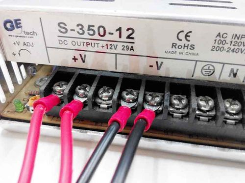

Step3. Connect the power cable to PSU.

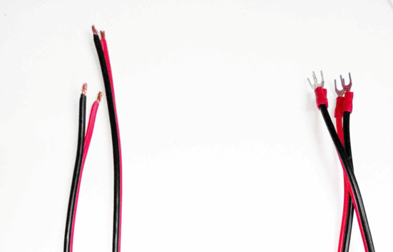

1)Mind the color of the wires. The wrong connection of the wire will cause serious damage to the PSU and even to the control board of the printer.
2) Pay attention to the switch on the right side of the PSU, there are two options of voltage: 110 V and 220V, choose according the standard in your country. As shown in the following picture.You can use some hard sticks to reach the switch.
After connection, please close the protective cover to avoid electronic shock.

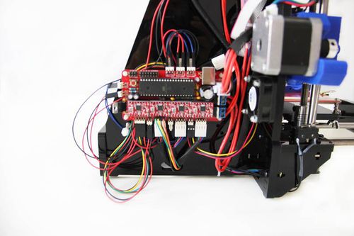

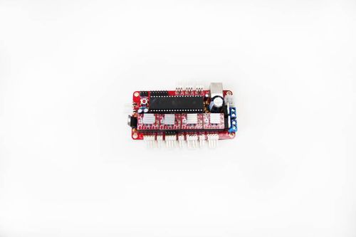

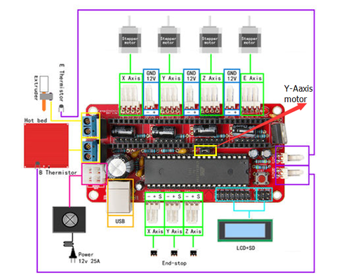

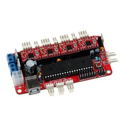

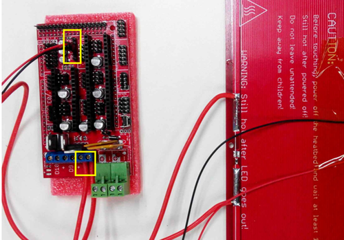

Mount the control board on the left side panel

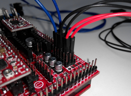

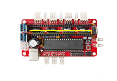

Example 1: Sanguinololu
Here we take the Sanguinololu as an example.

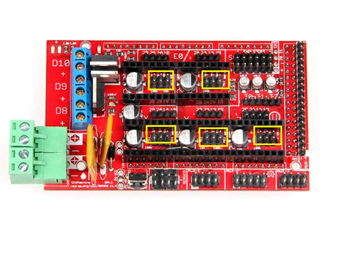

Step1, plug the jumper caps on the following pins of the board. (In the yellow circle)
* These caps are very tiny; do not throw them away inadvertently.
The jumper caps are packaged along with the board, do not lost them.
You need to plug 12 caps in all.
Step2. Stack the 4 A4988 on Sanguinololu
Step3. Stick the heat sink on the chip of the 4 A4988.
Step4. Connect all the wires to the interfaces of the board
The referring wiring schematic diagram of Sanguinololu

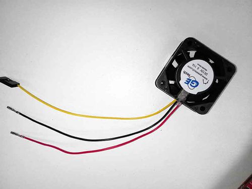

* use the Dopont cable in the package to strech the wire of fan for extruder, you just need to connect the black and red one, leave the yellow one alone.
also you can refer to the board cover.
For more information about Sanguinololu, please visit the wiki page.

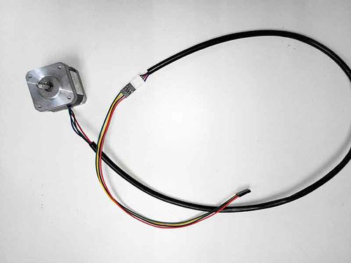

Note: when connect the other Y-motor, use the 4-pin M-F DuPont cable and pay attention to the directions of the wire. If you connect them reversely, the 2 Z motor will move in different directions.
Look at the colors of the wire.

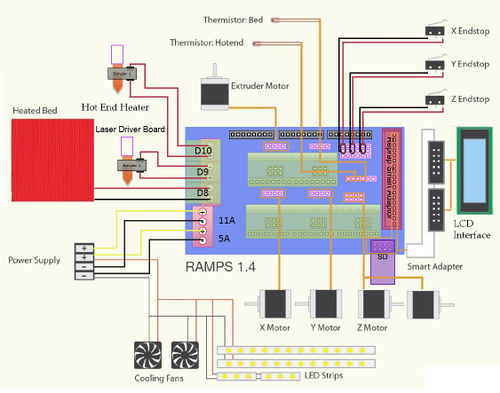

Example 2: Ramps 1.4

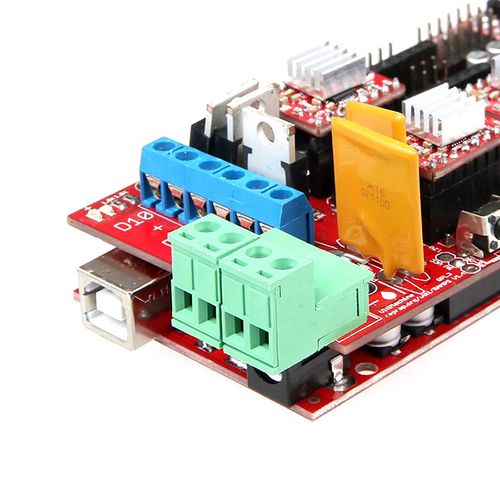

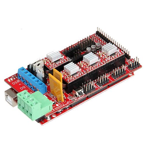

Step1.Plug the jumper caps on ramps 1.4. You need 15 jumper caps in total.
Step2.Stack ramps 1.4 onto mega 2560.

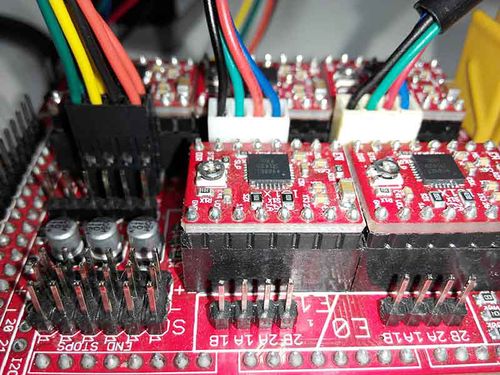

Plug the 4 A4988 motor driver boards on ramps1.4; stick the heat sinks on the driver boards.
(one for X, one for Y, one for extruder, two for Z)
Mind the directions of the driver boards. You can see the “GND” on the board.
Wiring
The referring wiring schematic diagram of Ramps 1.4

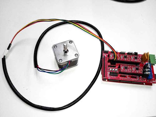

1.Connect motors. X and Y motors are easier, here you need to notice the Z motor, you need two 4-pin DuPont cable to extend for 2 Z motors.
2.Connect the fan; both the fan for extruder and the main board are connected like this. As to the fan for extruder, you need another 2-pin DuPont cable to extend. Take off the adapters and plug the cable into the power port.
3.Connect the heatbed.

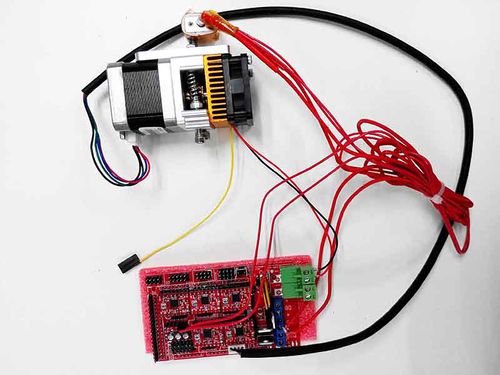

4.Connect the extruder
The 2-pin DuPont cable with adapter is for thermometry, the thicker one is for heating.
5.Connect the end stops.
- Connect the wires to "S" and "-" pins.
6.Connect the power supply.
First you should take off the white adapter.
Then screw the cable into the power port. Notice the “+” and “-“ Red is “+”. Black is “-“.
Plug the other end into the PSU.
For more information about ramps 1.4, please visit the ramps 1.4 wiki.

Step1.Mount the board on the left side panel of the printer. And cover the board with the acrylic plate.
Note that, when mount the board, please put the power port towards the cooling fan, or there may be some damaged caused to the board. This is very important, especially for Rampms 1.4.
All the wires can be tied together under the printer, but you should make sure they don’t touch the belt.
Arrange the wires and tidy up them with the coil.
