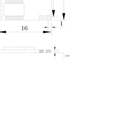

=Mechanical Dimension= | |||
unit:mm | |||
[[File:433,915transceiver dimension.jpg|400px|]] | |||
unit:mm
