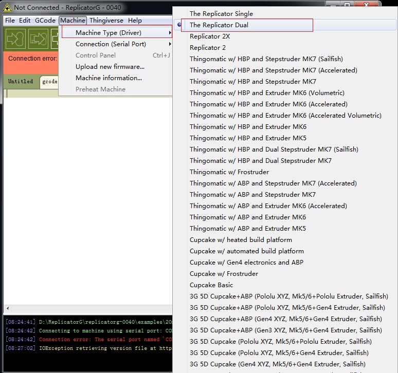

2.Click “Machine”, choose the type of printer: The Replicator Dual, as follow, | |||
[[File:Replicator G 2.jpg]] | |||

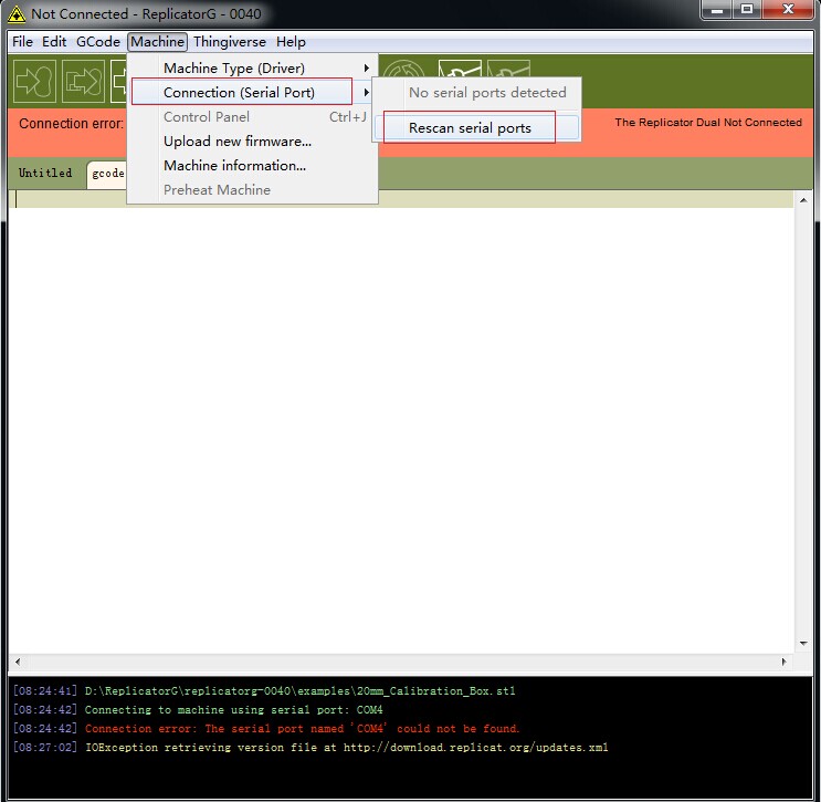

3.Click “Machine”, choose “Connection (Serial Port)”. | |||
[[File:Replicator G 3.jpg]] | |||

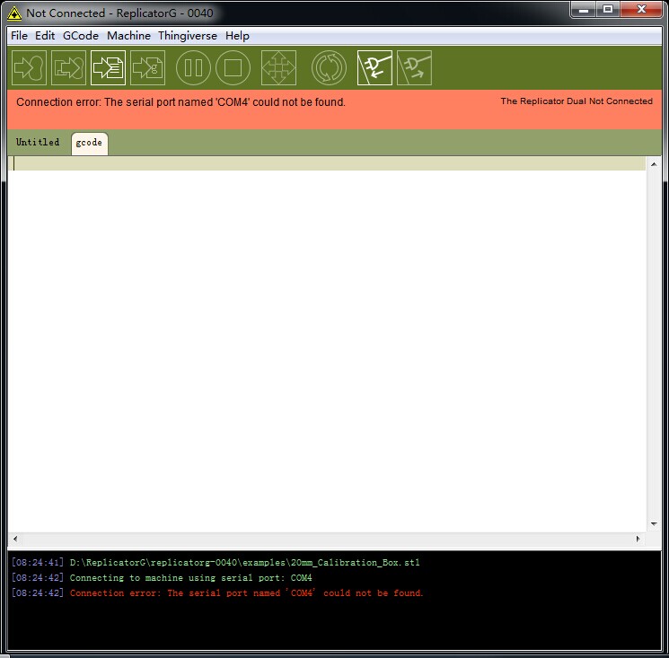

If you can’t find the serial port, click “Rescan Serial Ports” (. If you still can't find a serial port, please disconnect the USB, then reconnect it, and restart the software. If you find the serial port, select the COM port corresponding to your board. | |||
[[File:Replicator G 4.jpg]] | |||

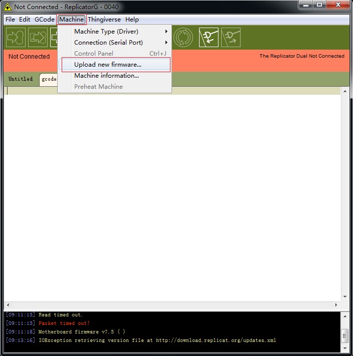

4.Click “Machine”, choose “upload new firmware”. | |||
[[File:Replicator G 5.jpg]] | |||
Click “MakeBot Replicator (MightyBoard) v1.5” and click Next to continue. | |||
