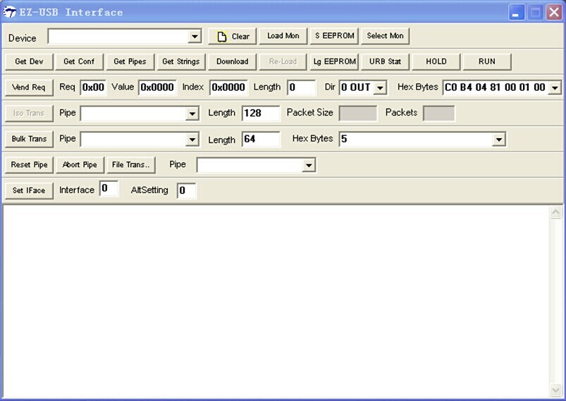

1.Click start> all programs>cypress> CyConsole EZ-USB, open the uploading software, (picture below), the can see the following interface

3 Press the power switch, the PWR on the board will light, USB Device will appear in the device field of EZ-USB Interface and the field of select device in Cypress USB Console will respond correspondingly, indicating the connection with USB.
4 Click Download button in EZ-USB Interface, open the CY7C68013A development board folder, double click the liu.hex file, then you can began uploading.
5 If the EZ-USB Interface displays as the following interface, the program uploading failed.
6 Press the reset button on the board, the device field in EZ-USB Interface will be blank, release the button, USB Device appears, then click re-load to upload program again. The following interface indicates the success of uploading.
