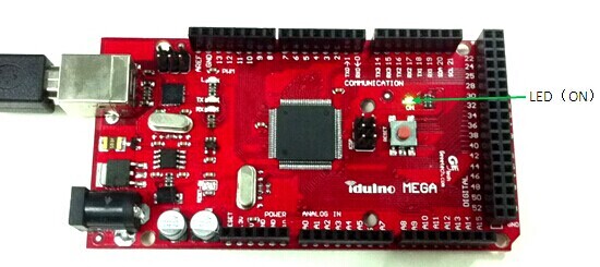

1)Connect MPR121 to Mega2560 with a USB cable, if the LED lights, the connection is ok, as in the following picture.

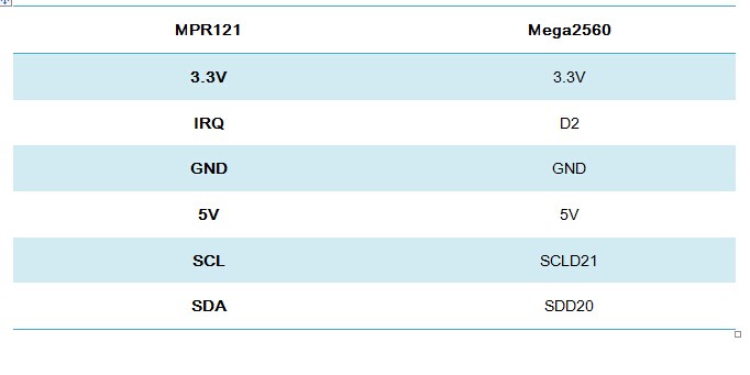

2)Connect MPR121 touch sensor module with Mega 2560 in light of 3-1

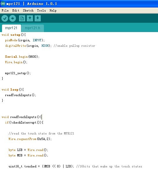

3)Open the test code file mpr121.ino with Arduino1.0.1, you are now in the interface as below:

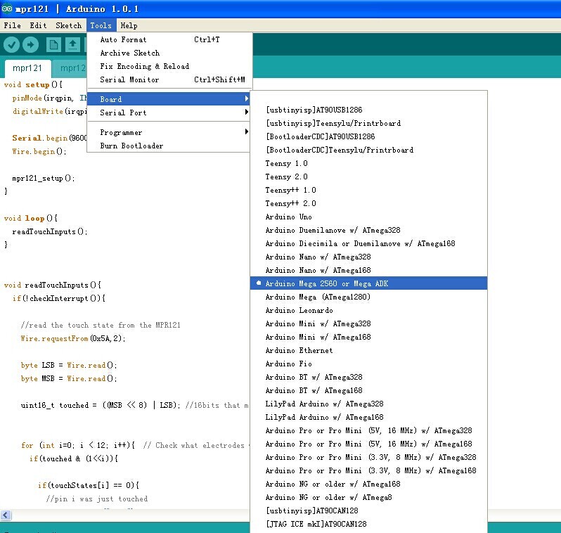

4)Select the type of board: Tools—Board—Arduino Mega 2560 or Mega ADK.

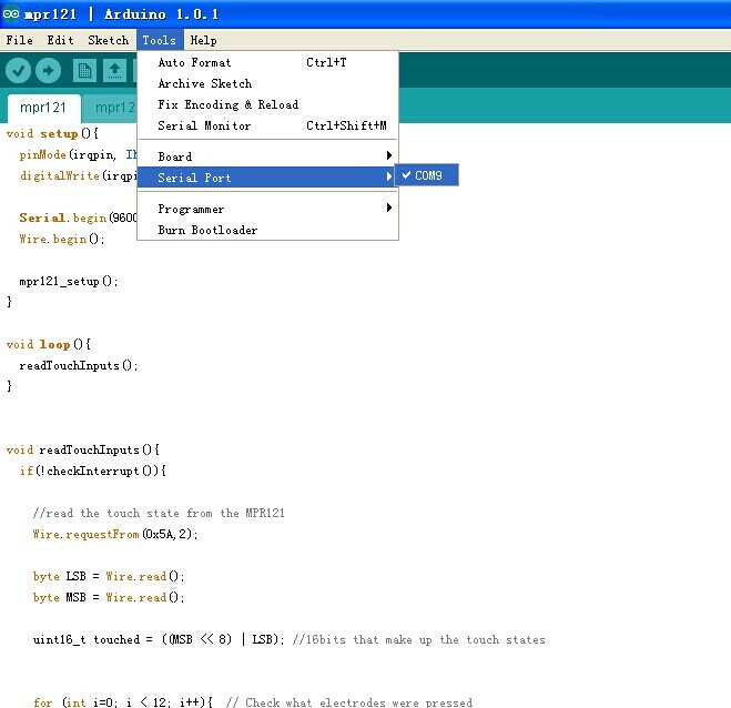

5)Choose the serial port under use: Tools—Serial Port—COM.

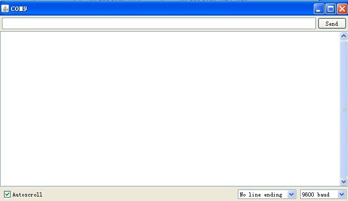

7)Open serial monitor in Arduino1.0.1, Tools—Serial Monitor. The following windows will pop-up.

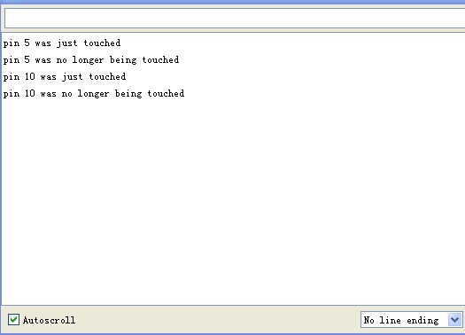

8)Press or release the touch button, if the Serial Monitor of Arduino1.0.1 will give response correspondingly, the MPR121 touch sensor module works.
