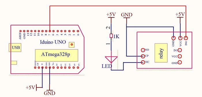

Firmware resources: Arduino board (any versions), wires, LED, 5v power supply. Software resource: Arduino IDE The one-channel relay can be programmed to realize the open and close automatically.

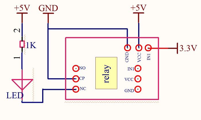

NB: customers can use any software or firmware to control the module as long as the IN1 of which can input a voltage of 3V-5V.you can do further development with the development tool you like as well as test it in the way of testing firmware.
Firmware test: after the connection as in picture1-4, pay attention to the blink of LED, listen to the flicker of relay when it is working. Software test code:
  void setup(){
   pinMode(7,OUTPUT);
   void loop(){
  pinMode(7,OUTPUT);
  delay(2000);
  digitalWrite(7,LOW);
  delay(2000);
Feedback of test: after the upload of code, connect the IN1 pins to the 7th pin of Arduino board separately, you can hear the ticktack of the relay (it keeps opening and closing), in addition, the LED-G is blinking every 2s.
