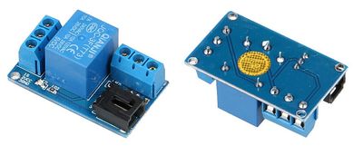

[[File:11.jpg]] | [[File:11.jpg|400px|]] | ||
One-channel output contact, including a normally-open (NO) contact and a normally-closed (NC) contacts | One-channel output contact, including a normally-open (NO) contact and a normally-closed (NC) contacts | ||
One-channel input control (two sets of port) | One-channel input control (two sets of port) | ||

Overview and Hardware Resources
