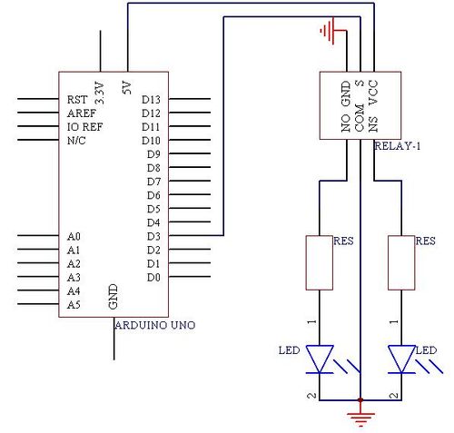

- Module pin definitions: Pin1 - control, Pin3 - ground,Pin2 - VCC
Pin definition
- COM- Common pin
- NC- Normally Closed, in which case NC is connected with COM when S is set low and disconnected when S is high;
- NO- Normally Open, in which case NO is disconnected with COM1 when S is set low and connected when S is high.
Usage
VCC - 5V GND - GND S - Digital pin3
Example code
int Relay = 3;
void setup()
pinMode(Relay, OUTPUT); //Set Pin3 as output
void loop()
digitalWrite(Relay, HIGH); //Turn off relay
delay(2000);
digitalWrite(Relay, LOW); //Turn on relay
delay(2000);
