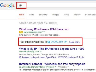

3. Open home page (Google), input” IP” to check your Public IP. | 3. Open home page (Google), input” IP” to check your Public IP. | ||
[[File:Gprs_(2). | [[File:Gprs_(2).jpg|400px|]] | ||

solutions for no registration to network
Solutions
If you are using a Router rather than a modem or Exchanger, before networking testing for the GPRS module, you should pay attention to the following tips.
1. Specify a fixed IP address for Local Host,hereinafter referred to as ’Local Host IP’.
2. Set a Port Mapping on the Router and map the port to Local Host IP. We call the set port ‘Local Host Port’. Local Host Port is within 0 and 65535.
