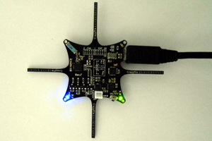

Before you go ahead and assemble the Crazyflie check the Crazyflie control board and the Crazyradio electronics:
1. Attach a powered micro-USB cable to the Crazyflie control board. It should power up and blink 5 times with the green LED. After that the green LED should be fully on and the red LED should blink.
2. Attach the Crazyradio to a computer and follow the installation instructions. When the Crazyradio is found and enumerated the red and green led will turn off. This is a good sign.
3. When the cf-client is installed and the Crazyradio is working it should be possible to connect to the Crazyflie using the connect button in cf-client. Test that you can connect. It is also a good time to update the firmware now using the bootloader. Latest stable binaries can be found here.
When all these tests passed go ahead and start the assembly. If they did not pass visit the forum and open a support thread if you can't already find one describing the problem.
